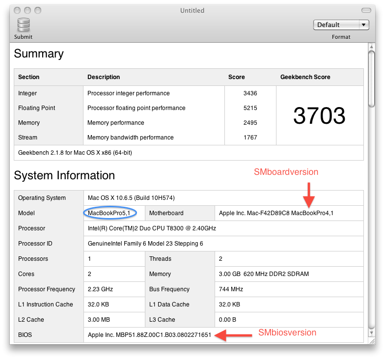

valv Posted December 20, 2010 Author Share Posted December 20, 2010 But after running the Geekbench, I have "Apple Inc. Mac-F42D89C8 Mac-F2268AC8" appear in the Motherboard section. Mac-F42D89C8 is for MacbookPro5,1 and MacbookPro4,1. So it seems that the value I added can't override the one that Chameleon tries to assign but append to it. you would need this instead (literally the same as in real mbp5,5) <key>SMboardversion</key> <string>Not Specified</string> The one you are trying to override should be the SMboardproduct (in the green rectangle on the image). Add it to the smbios.plist file with the right value (you 've been trying to add). Link to comment https://www.insanelymac.com/forum/topic/216726-anval-acpi-loader/page/42/#findComment-1605492 Share on other sites More sharing options...
wojnar0 Posted December 20, 2010 Share Posted December 20, 2010 I have the same problem, two motherboards Here is my smbios.plist: SMbiosdate 04/01/2008 SMbiosversion MBP51.88Z.00C1.B03.0802271651 SMfamily MacBook Pro SMmanufacter Apple Inc. SMproductname MacBookPro5,1 SMboardversion Mac-F42D89C8 SMserial W88033AKY51 SMsystemversion 1.2 Link to comment https://www.insanelymac.com/forum/topic/216726-anval-acpi-loader/page/42/#findComment-1605623 Share on other sites More sharing options...
valv Posted December 20, 2010 Author Share Posted December 20, 2010 the same problem, two motherboards the same instructions. You should add SMboardproduct to smbios.plist. As of an original mbp5,1, this has "Proto" as value.btw, That is not showing two motherboards, as the first is for the board version and second one is for the board product. To make it clear for everybody, here is the new SMBios injection's terms: [list] [*]SMbiosvendor [*]SMbiosversion [*]SMbiosdate [*]SMmanufacter [*]SMproductname [*]SMsystemversion [*]SMserial [*]SMUUID [*]SMfamily [*]SMboardmanufacter [*]SMboardproduct [*]SMboardversion [*]SMboardserial [*]SMchassismanufacter [*]SMchassisversion [*]SMchassisserial [*]SMProcessorfamily [*]SMexternalclock [*]SMmaximalclock [*]SMmemdevloc [*]SMmembankloc [*]SMmemtype [*]SMmemspeed [*]SMmemmanufacter [*]SMmemserial [*]SMmempart [*]SMoemcpu [*]SMcputype [*]SMbusspeed [/list] Link to comment https://www.insanelymac.com/forum/topic/216726-anval-acpi-loader/page/42/#findComment-1605644 Share on other sites More sharing options...
mitch_de Posted December 20, 2010 Share Posted December 20, 2010 Very interesting about that ! I thougth that only the MacModell (MacPro3,1 ....) does have effect on cpu powermanagement (clockings) and the other parameters in smbios are only cosmetik / for getting hackintosh seen as Mac and not hackintosh in geekbench. Link to comment https://www.insanelymac.com/forum/topic/216726-anval-acpi-loader/page/42/#findComment-1605657 Share on other sites More sharing options...
