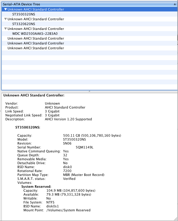

imacken Posted April 18, 2010 Share Posted April 18, 2010 Unfortunately, the Windows and the System Partition drives are grouped as "CDs, DVDs and iPods" (and not "Hard Drives").. which I'd rather not have hidden in case I plug in my iPod or insert a CD or DVD. There is something wrong then. What does System Profiler say under Serial-ATA? Link to comment https://www.insanelymac.com/forum/topic/215788-hiding-windowss-system-reserved-partition-in-sl/#findComment-1450809 Share on other sites More sharing options...

raggedjagged Posted April 20, 2010 Author Share Posted April 20, 2010 There is something wrong then.What does System Profiler say under Serial-ATA? I've attached a screenshot of the Serial-ATA section in System Profile, is it not normal? Is there something wrong with that? I've always seen Windows and NTFS drives not being under "Hard Drives" in Finder on multiple computers.. Help!! Link to comment https://www.insanelymac.com/forum/topic/215788-hiding-windowss-system-reserved-partition-in-sl/#findComment-1452481 Share on other sites More sharing options...
Beerkex'd Posted April 21, 2010 Share Posted April 21, 2010 Well it says 'unknown', do you have ICH9R or ICH10R? (assuming the R in your motherboard model name refers to RAID) Link to comment https://www.insanelymac.com/forum/topic/215788-hiding-windowss-system-reserved-partition-in-sl/#findComment-1452535 Share on other sites More sharing options...
raggedjagged Posted April 21, 2010 Author Share Posted April 21, 2010 Beerkex'd: Okay I got the 'unknown' showing the text of my SATA now.. which is ICHR9 .. I just put in AHCIPortInjector.kext in my /E/E/ ..s it now shows ICH9R in that System Profiler section. However, the NTFS drives are still being shown as "CDs, DVDs, and iPods" in Finder Preferences.. The only drives that show as "Hard Drives" are OSX and Time Machine! What's going on? Link to comment https://www.insanelymac.com/forum/topic/215788-hiding-windowss-system-reserved-partition-in-sl/#findComment-1452558 Share on other sites More sharing options...
Beerkex'd Posted April 21, 2010 Share Posted April 21, 2010 Look in System Profiler or Disk Utility and check if your NTFS drives are 'external'. If your drive icons are orange then don't bother, that means I'm right When the drives are seen as external, they get grouped with "CDs, DVDs and iPods" and are shown on the desktop. This is normal, it happens on a real Mac as well when you connect an external drive. You can use the IOAHCIBlockStorageInjector.kext that comes with Chameleon to make your drives 'internal'. Link to comment https://www.insanelymac.com/forum/topic/215788-hiding-windowss-system-reserved-partition-in-sl/#findComment-1452584 Share on other sites More sharing options...

raggedjagged Posted April 22, 2010 Author Share Posted April 22, 2010 Look in System Profiler or Disk Utility and check if your NTFS drives are 'external'. If your drive icons are orange then don't bother, that means I'm right When the drives are seen as external, they get grouped with "CDs, DVDs and iPods" and are shown on the desktop.This is normal, it happens on a real Mac as well when you connect an external drive. You can use the IOAHCIBlockStorageInjector.kext that comes with Chameleon to make your drives 'internal'. I already have OrangeIconFix.kext, and my drives don't appear as orange icons, they appear as internal hard drive (shiny metal) icons. However you are right, all of my Hard disks, including the OS X one itself, appear as "External" types.. (but its weird how OS X drive, eventhough seen as External in Disk Utility, is grouped with Hard Drives in Finder prefs.) So now I need the IOAHCIBlockStorageInject.kext to fix this? Thanks for your help!! sudo sunano /etc/rc.local add line: diskutil unmount "/Volumes/System Reserved" ("System Reserved" - name of partition) save Ctrl+X. This method involves utilizing the File System Table (fstab) for the BSD subsytem. First you need to know the mount points of the partitons you don't want to see. I'll use "winxp" and "backup" for the examples. If you didn't know, the partition on which OS X resides is mounted to / (root), and all subsequent partitons are mounted to /Volumes/. You can find the mount point of any given partiton using disk utility, selecting the partiton and hit the info button up top. I have 2 drives. One with 2 partitions and one with 3 partitions. The primary drive has my OSX partition and one for winxp. The second drive has a documents partition, and media partition, and a backup partition. For day to day use in OS X I don't want to see the winxp nor the backup partions. From disk utility, I find their mount points are /Volumes/winxp and /Volumes/backup respectivley. The first thing we need to do is to crate the fstab file in the /etc folder. Open up a Terminal and: CODE sudo nano /etc/fstab now we need to edit to suit our needs. The typical entry line in fstab contains on line for each mount, with the data in the format : file system mount-point type options So to tell it to not mount a specific drive or partition, we just need to specify not to do so. CODE LABEL=winxp none ntfs ro,noauto LABEL=backup none HFS+ ro,noauto In the example, "LABEL=winxp" is my windows partition, "none" is the mount point, "ntfs" is the type, and "ro,noauto" are the options. You must use the appropriate type for the partiton, ie: ntfs HFS HFS+ msdos etc. The options "ro,noauto" mean read only, don't auto mount. For read / write of supported file systems use rw. If your partition name has a space on the name, you need to replace the space with "\040" ie. "LABEL=Win\040XP" for Win XP. Once you have the code entered, hit cntrl-x and it will ask if you want to save. Hit y for yes, and it'll ask if you want to save it as fstab. Hit enter. Now just restart, and the drives won't auto-mount. Thanks for the info guys! I'll try that Orwell: I have to try that, my earlier experimenting with fstab didnt quite work, lets see how following your instructions will result. Link to comment https://www.insanelymac.com/forum/topic/215788-hiding-windowss-system-reserved-partition-in-sl/#findComment-1453429 Share on other sites More sharing options...
Beerkex'd Posted April 22, 2010 Share Posted April 22, 2010 OrangeIconFix does just that, it only fixes the icons and does not change the actual status of the drives. Hotplugging works. IOACHIBlock(...).kext sets the drives as internal, which in turn make the icons change but you lose hotplugging. Don't use both at the same time, there's no point. If you have a ICH9 or 10 SATA controller, you could also set the drives as internal via DSDT. Link to comment https://www.insanelymac.com/forum/topic/215788-hiding-windowss-system-reserved-partition-in-sl/#findComment-1453613 Share on other sites More sharing options...
raggedjagged Posted April 25, 2010 Author Share Posted April 25, 2010 Thanks for the reply Beerkext'd.. well since I do not use esata, I think hotplugging is of no use to me.. so I'll replace OIF to IOAHCIBlock...kext. However, I think DSDT will be better, do you know what changes to dsdt I have to make? I have an ICH9R controller. Link to comment https://www.insanelymac.com/forum/topic/215788-hiding-windowss-system-reserved-partition-in-sl/#findComment-1455667 Share on other sites More sharing options...
Beerkex'd Posted April 26, 2010 Share Posted April 26, 2010 You can get the general idea from reading this: http://www.insanelymac.com/forum/index.php?showtopic=168014 The initial post is about USB but you can apply the same trick to your SATA controller. The device ID for the ICH10 that Apple uses (it's 3a22) works well with our ICH10/9/R. See post #26, #46 and the comments that follow. Actually, come to think of it you will still need the BlockStorageInjector when patching device IDs in the DSDT like this. It's the other ICHx kext you can ditch, I get confused easily trying to remember all these things. Anyway if you're new to DSDT patching, try this, it's a good exercise for a beginner and do the USB controllers too. Link to comment https://www.insanelymac.com/forum/topic/215788-hiding-windowss-system-reserved-partition-in-sl/#findComment-1455837 Share on other sites More sharing options...
