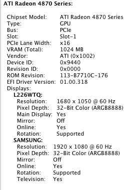

i upgraded to 10.6.3 and now i can only VNC into my box...mac software info shows the video card but can't pickup any display connectors.
i am just using graphicsenabler=yes, no evo or aty kext files.
i tried the dvi2vga dongle and that didn't work.
mines is showing everything the same as your printout, except Display Connector is blank. i'm using 1dvi and 1 vga connected, i tried taking out the vga, or /and dvi , tried using dvi2vga same no video. i can only VNC into the box.
