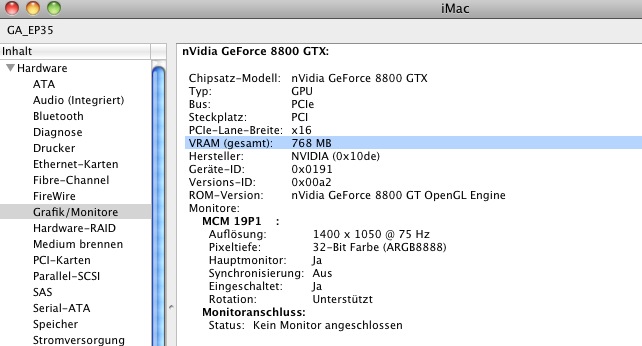

mitch_de Posted February 21, 2010 Share Posted February 21, 2010 I think also QE/CI isnt working with your setting ! Or if QE/CI works, the VRAM is reported wrong - must be 256MB for my knowledge to run Aperture. So check your VRAM injection (by those .kext) with systemprofiler Grafik VRAM if you must setup the vram (in .plist) . IF you already have an dsdt in running, i would add the 8800GT injection there. You dont need any .kext anymore = much less problems! Here my dsdt part: Device (GFX0) { Name (_ADR, Zero) Name (_SUN, One) Method (_DSM, 4, NotSerialized) { Store (Package (0x16) { "@0,compatible", Buffer (0x0B) { "NVDA,NVMac" }, "@0,device_type", Buffer (0x08) { "display" }, "@0,name", Buffer (0x0F) { "NVDA,Display-A" }, "@1,compatible", Buffer (0x0B) { "NVDA,NVMac" }, "@1,device_type", Buffer (0x08) { "display" }, "@1,name", Buffer (0x0F) { "NVDA,Display-B" }, "NVCAP", Buffer (0x18) { /* 0000 */ 0x04, 0x00, 0x00, 0x00, 0x00, 0x00, 0x03, 0x00, /* 0008 */ 0x0C, 0x00, 0x00, 0x00, 0x00, 0x00, 0x00, 0x07, /* 0010 */ 0x00, 0x00, 0x00, 0x00 }, "VRAM,totalsize", Buffer (0x04) { 0x00, 0x00, 0x00, 0x30 // 0x30=768 MB, 0x20=512 MB }, "device_type", Buffer (0x0D) { "NVDA,GeForce" }, "model", Buffer (0x18) // (0x17) { "nVidia GeForce 8800 GTX" // "nVidia GeForce 8800 GT" }, "rom-revision", Buffer (0x25) { "nVidia GeForce 8800 GT OpenGL Engine" } }, Local0) DTGP (Arg0, Arg1, Arg2, Arg3, RefOf (Local0)) Return (Local0) } Link to comment https://www.insanelymac.com/forum/topic/211271-aperture-3-with-8800gt/#findComment-1414726 Share on other sites More sharing options...
