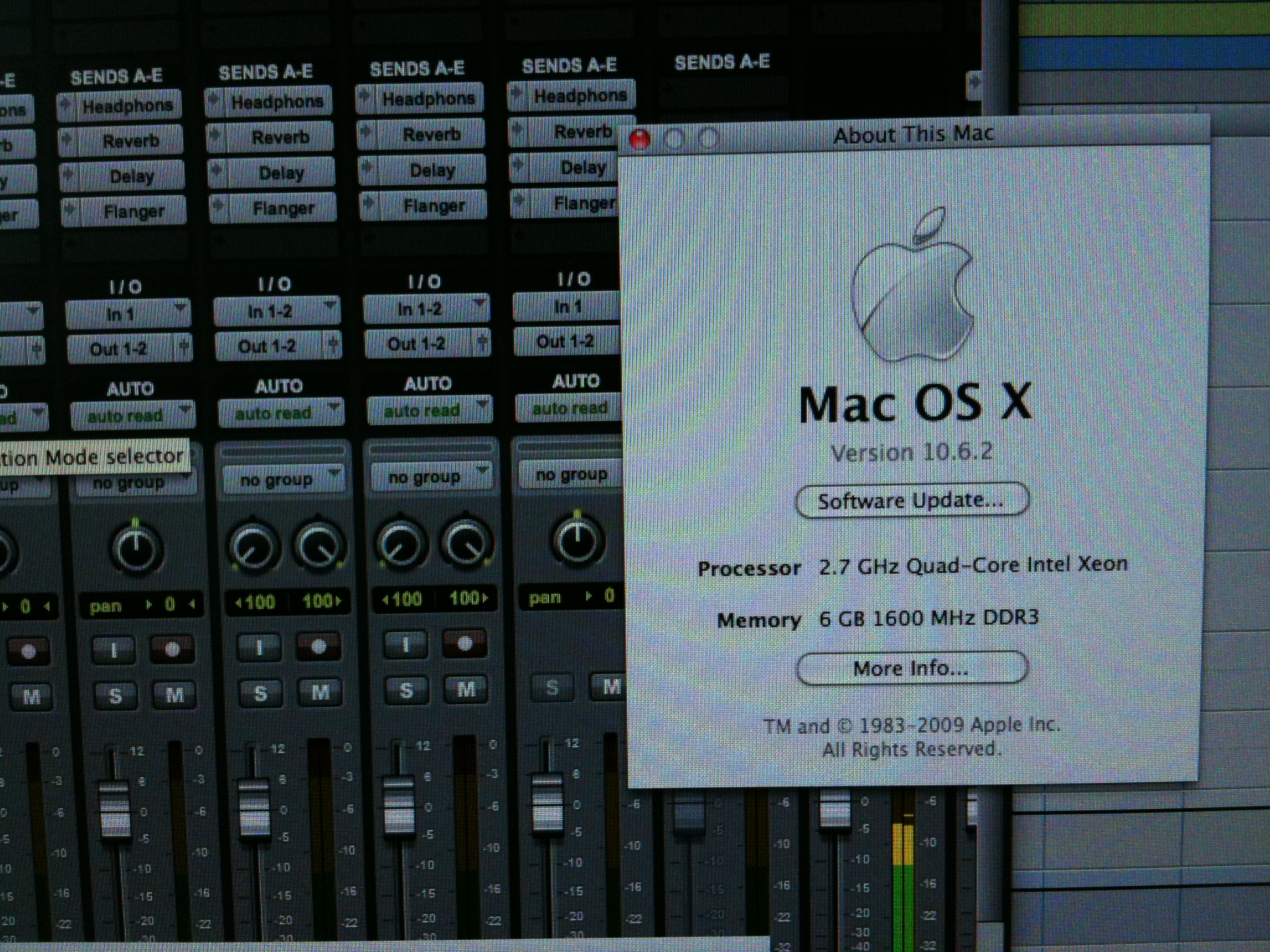

Formal Posted January 13, 2010 Share Posted January 13, 2010 OK so finally got build finished with help from Digital Dreamer, Noizyboy & Cindori (Many Thanks!) Build consists of everything in my signature and with install of OSX 10.6.2 using DD's script and then removing what wasn't needed i.e few kexts (thanks Tonymacx86 and Cindori) I'm over the moon. I am a Mac Tech and have 12 yrs under my belt BUT due to needing PCI slots for my Digidesign Pro Tools HD cards I was left to fend for myself if I wanted to use something newer than a 2.7Ghz PCI G5 Powermac to run them (was a great machine but come on!) I also really wanted rackmount capability to get the Mac in a Rack (have wanted that for about 6 yrs!) In all honesty what I have now is nothing short of amazing considering I also have an 8 Core 2.26Ghz Mac Pro specced out (over £3000 in total) and did this machine at just under £1300! OK so not Dual i7 and it has 6GB ram instead of 12GB on my Mac Pro, BUT Geekbench shows roughly the same mark on both and it really is like sh*t off a shovel. I really would like to be able to help fellow users if I can in the future that use High end PCI cards such as Digidesign, Avid, AJA etc etc to get systems running if they want to give it a try or simply need to do real time stuff tbut maybe don't have a spare £3000-4000 in the bank. This is one case where the Hackintosh community is making it easier for the smaller guy to continue using their preferred platform (Mac) with cards that the manufacturer deems "Old technology" and still get work done without re-mortgaging their house to buy a new Mac AS WELL as new cards (aimed directly at Digidesign!!!!) Please post if you want to find out more. I will be putting this system through various high load stress tests over the upcoming weeks and reporting back with findings. From running RTAS/VST & audio unit Plugs to decoding/rendering (Red files etc) and large file transfer projects (may even try some fibre channel stuff to Raid etc) Thank you to all that helped and will no doubt continue to help. PS sound dampening was also a major factor in this build so will post some pics tomorrow on rackmount soundproofing and fans we used etc Link to comment https://www.insanelymac.com/forum/topic/207174-i7-build-success-for-pro-audio-video-use-help-page/ Share on other sites More sharing options...

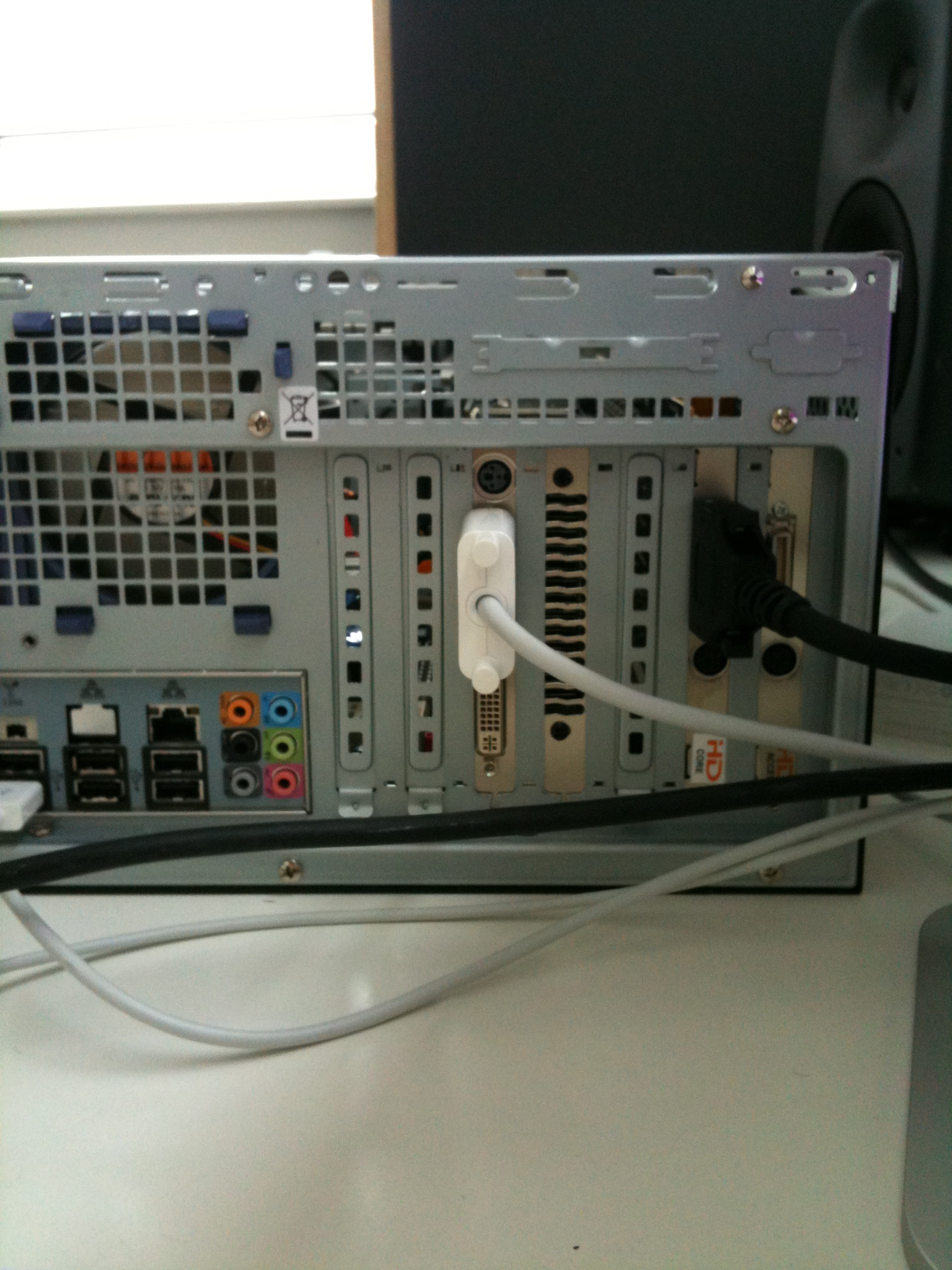

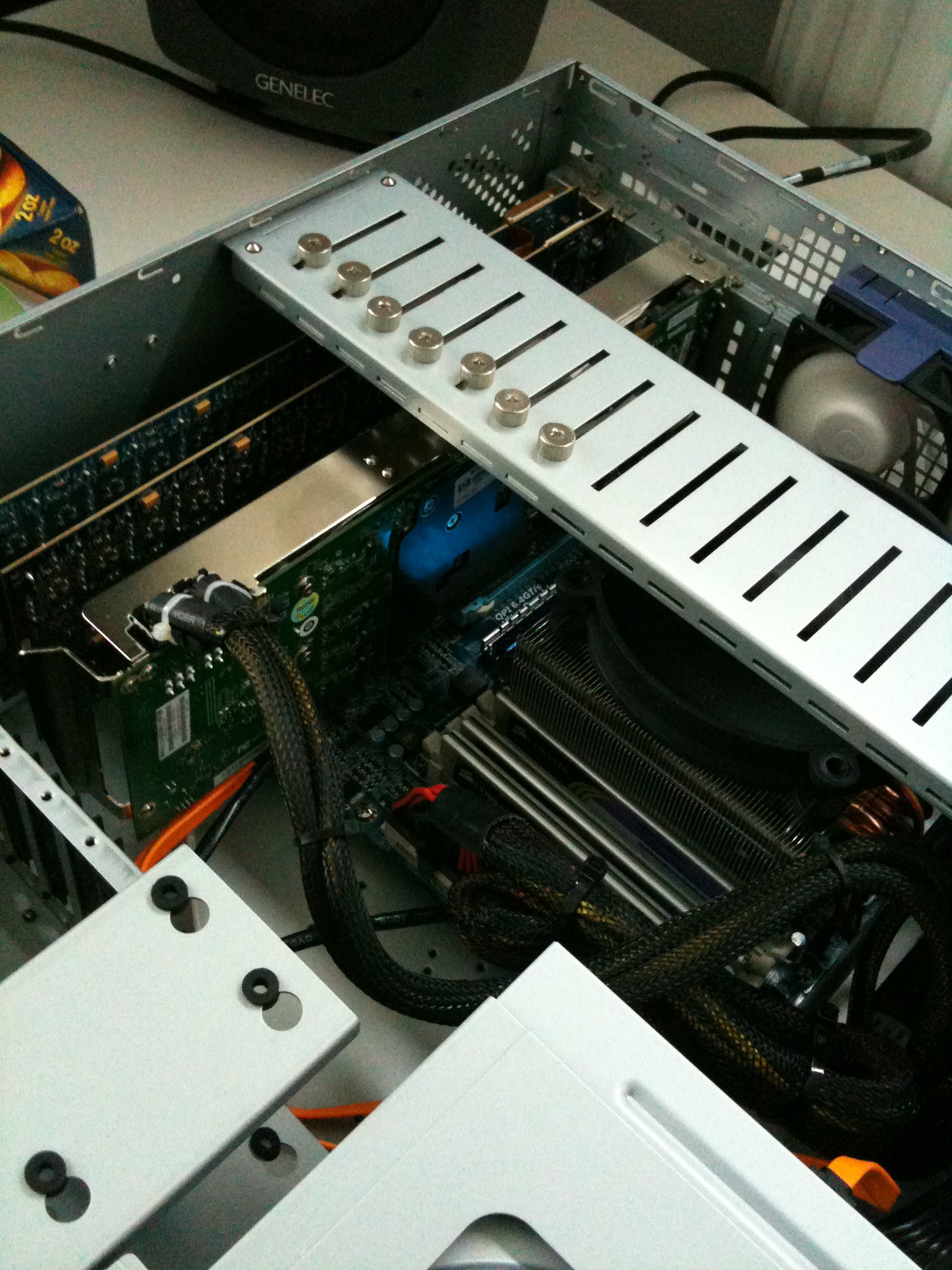

Formal Posted January 15, 2010 Author Share Posted January 15, 2010 Some Pics of HD2 i7 Build Link to comment https://www.insanelymac.com/forum/topic/207174-i7-build-success-for-pro-audio-video-use-help-page/#findComment-1385828 Share on other sites More sharing options...

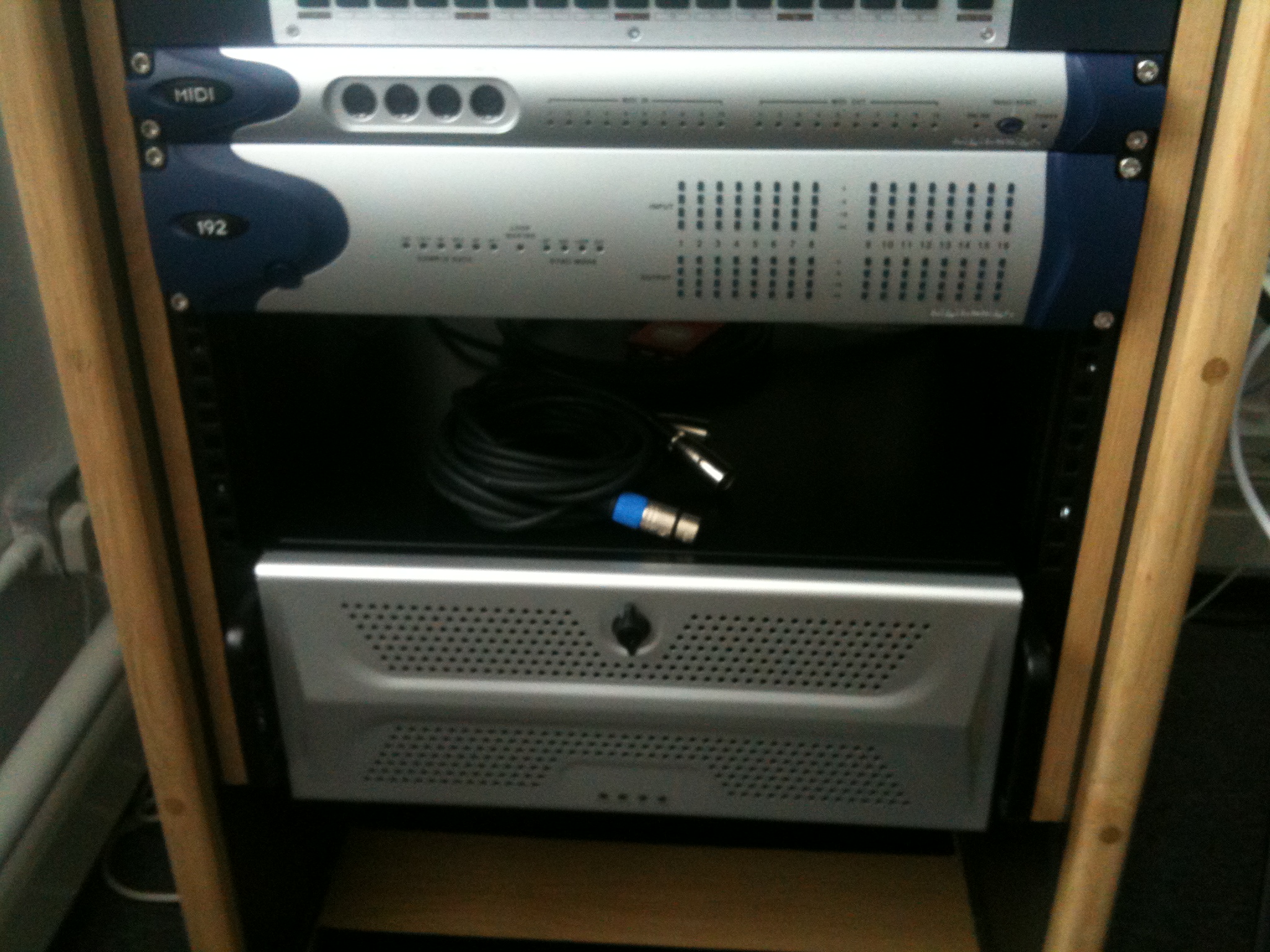

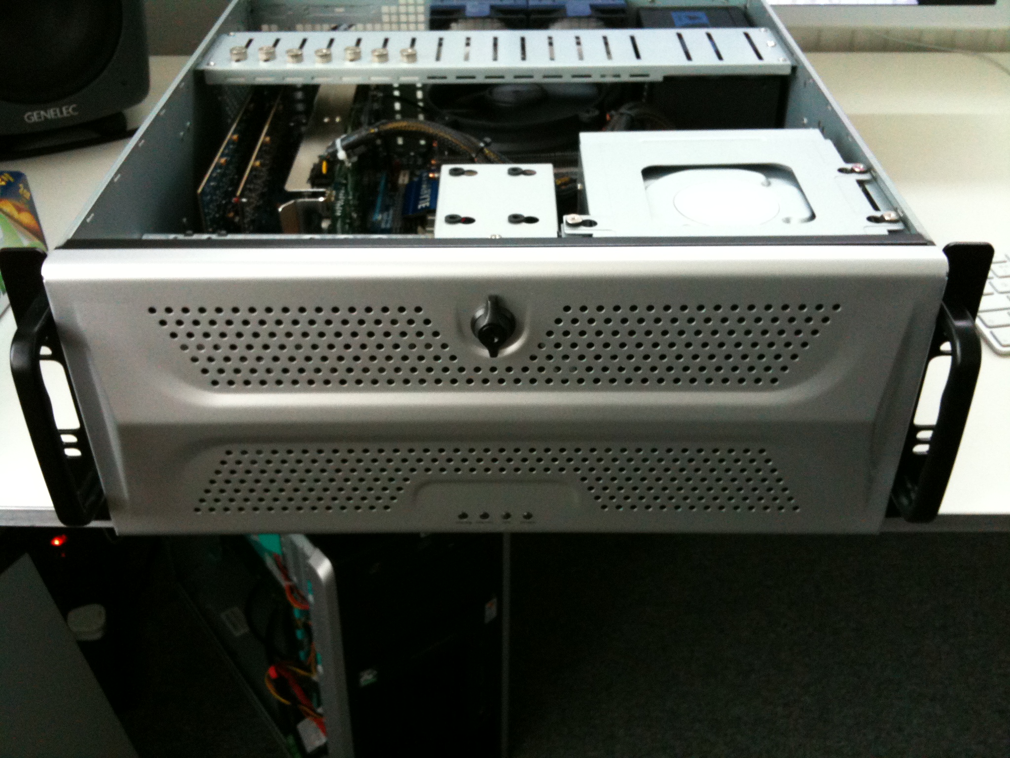

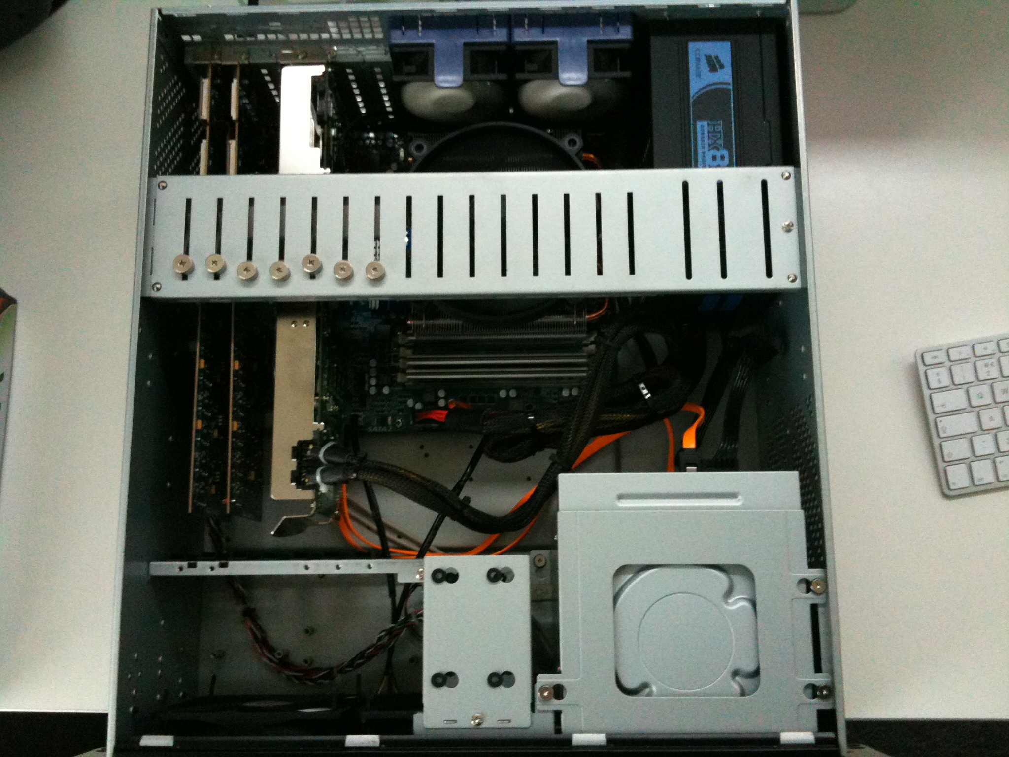

Formal Posted February 13, 2010 Author Share Posted February 13, 2010 formal, thanks for directing me here... which rack case is that? (sorry if it missed it) how are your noise levels? are you using a soundproof rack or machine room for the box? i need to be able to record in the same room w/ it, so looking into liquid cooled options. tim I am using this case : http://www.xcase.co.uk/Compucase-4u-s401-p...ucase-s401b.htm ( In Silver) It matches the digi I/O's perfectly! The machine is in same room as me (I dont record vocals etc so its fine) even though its very quiet (slightly louder than my 2008 Mac Pro) I was going to use liquid cooling but no need, I used a foam kit from quiet pc : http://www.quietpc.com/gb-en-gbp/products/...terials/ap-kits its good enough for most! Hope that helps and check pic for idea Link to comment https://www.insanelymac.com/forum/topic/207174-i7-build-success-for-pro-audio-video-use-help-page/#findComment-1409362 Share on other sites More sharing options...
forch Posted March 5, 2010 Share Posted March 5, 2010 I am using this case : pic ( In Silver) It matches the digi I/O's perfectly! The machine is in same room as me (I dont record vocals etc so its fine) even though its very quiet (slightly louder than my 2008 Mac Pro) I was going to use liquid cooling but no need, I used a foam kit from quiet pc : pic its good enough for most! Hope that helps and check pic for idea Jeez, I've been searching for someone who might have tried it, searched the Avid forum for anyone that has build a hackintosh (i call them PAC's ) and runs Logic with the Pro Tools HD cards. I've just build a hackintosh (i7/EX58-UD5) for someone else. The plan is to run Pro Tools HD as well, the only problem I foresee is that the HD cards a 64-bit universal PCI's. Not the PCIe's. Watching your picture closely you have the PCIe version. Do you know by change if the 64-bit PCI's would work as wel? I know they work in PCI (2.x, 5v) so that is not the problem, I just hope that the Mac driver recognizes the card as if it were in PCI-X slot. I've read a vague post about someone actually manage to get it to recognize in Logic, but the driver would constantly say that the hardware could not be found, but could work on it like working on a Mac Pro. I've got no clue about Pro Tools (or any Avid product). Theoraticaly I could solve this problem by using a PCIe->PCI expansion (Virtuavia's expansion for example), but technically that wouldn't make any difference for busses to be recognized. How did the stress test go btw? Very curious. [edit] Hmm, PCI allocation is read from BIOS, all should work fine, it's only the matter of finding the right driver & OS version. Cheers, fz Link to comment https://www.insanelymac.com/forum/topic/207174-i7-build-success-for-pro-audio-video-use-help-page/#findComment-1423261 Share on other sites More sharing options...
