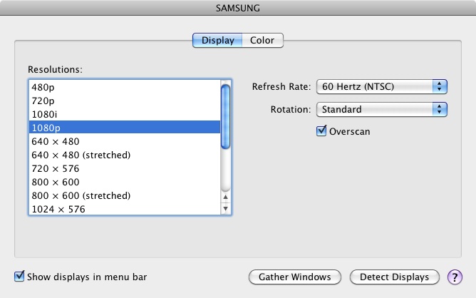

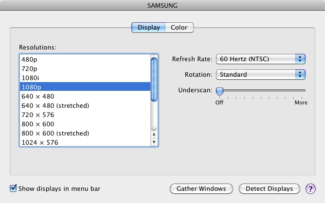

i dont think really needed switchresx i had it before when i tried to get my lcd TV to work and overscan correctly..but with the 5770 card it overscans like its suppose to..:) and its an LCD tv and i have it hooked hop with an hdmi to dvi adapter..
Thanks I got it.
I also connected LCD TV (HD) by using DVI-HDMI adaptor. I got as the following picture. You may try to reduce the size. This's the first time I saw. Previously I saw Overscan check box for my HD4870. I will try install new driver for HD4870 and see what will be changed.
using HD5770 to LCD TV
compare to using GT220 to LCD TV

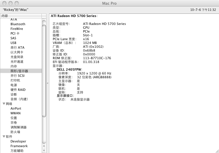

I just want to put my two cents in.
I've got an XFX HD5770 1GB card and it's running with full everything in 64 bit mode.
I followed these steps.
- I have a EP45-UD3P v1.6 and I installed 10.6 with stellas v3 installer.
- Then updated to 10.6.4
- Before rebooting I Install tmongkols edited version of Asere Bootloader, and installed the 7 ATI kexts
- Then edited my boot plist to contain GraphicsEnabler=Yes and also removed all boot flags so it boots to 64bit by default.
Plain and simple it just worked after that and I don't have to have more than one DVI plugged in or have it plugged in any specific port.
