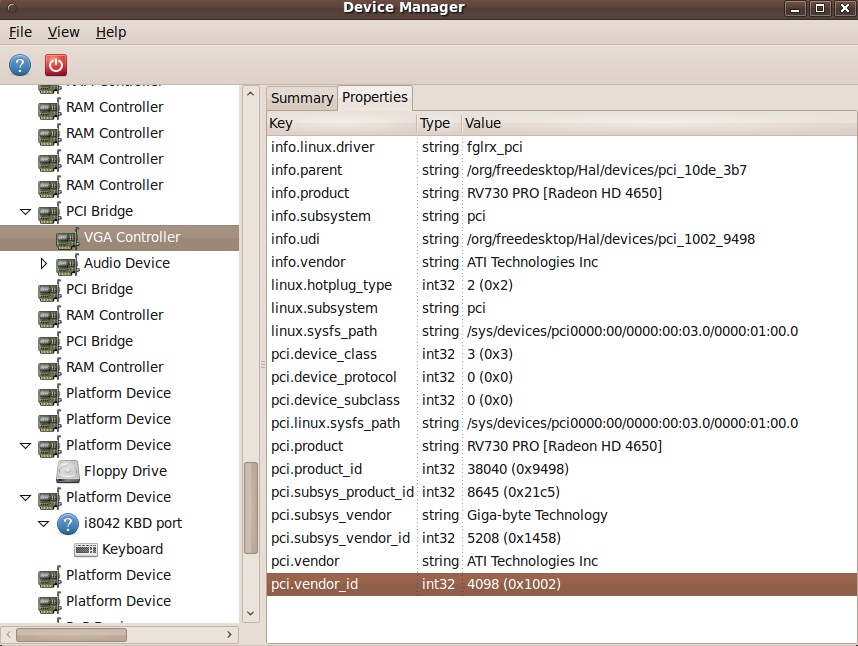

hisho Posted December 20, 2009 Share Posted December 20, 2009 thanks so much for your work , i want to ask how to add the id , i have ati radeon hd 4650 here is the id in this photo Link to comment Share on other sites More sharing options...
Monkey D. Luffy Posted December 20, 2009 Share Posted December 20, 2009 thanks so much for your work , i want to ask how to add the id , i have ati radeon hd 4650 here is the id in this photo The 4650 device id is already in the installer. You don't need to add anything anymore. The one on your screenshot is your VENDOR id (not device id). Just use the installer and you should be good. You also have to wish for more luck .. seriously. Some cards just work .. some doesn't. Link to comment Share on other sites More sharing options...
