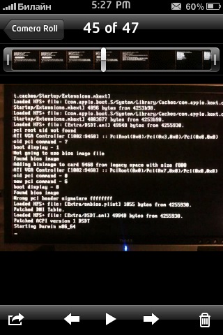

marc5 Posted February 22, 2010 Share Posted February 22, 2010 so here is a -v boot can anyone tell me why the second video card does detect properly? i get a wrong pci header signature ffffffff does it have to do with the pci root uid not found? please help. otherwise, the ati 4890 works perfectly, dual dvi working too, just the second 4890 isn't detected and the fan runs at 100% works perfectly i n windows 7 in crossfire thanks marc Link to comment https://www.insanelymac.com/forum/topic/201226-ati-4890-snow-leopard-1061-1062-information-thread/#findComment-1415180 Share on other sites More sharing options...
