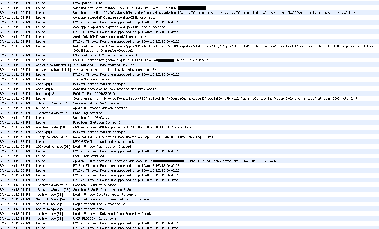

sound ok, no sleep, reboot ends in shutdown reason 3

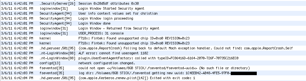

did that. manual sleep seems to be working now... automatic sleep doesnt, screen goes blank, pc keeps powered on, dvd access from time to time. to see console system.log attached
still shutdown,reboot doesn't.
I searched for a boot logging to .txt option and could not find one. Is there a way I can capture the boot -v data in a text file and upload it to the thread ?

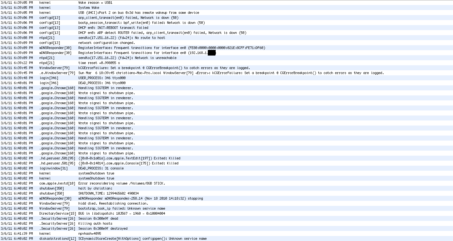

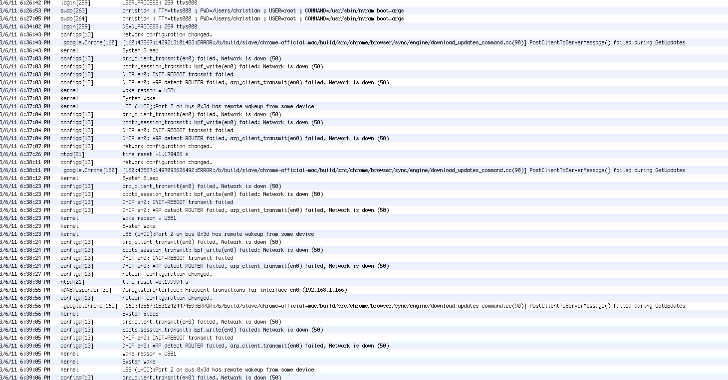

Mar 7 18:43:23 christians-Mac-Pro kernel[0]: System Sleep
Mar 7 18:43:28 christians-Mac-Pro kernel[0]: Wake reason = USB1
Mar 7 18:43:28 christians-Mac-Pro kernel[0]: System Wake
Mar 7 18:43:28 christians-Mac-Pro kernel[0]: USB (UHCI):Port 2 on bus 0x3d has remote wakeup from some device
im at a loss on how to fix that....could anyone give me a hand please ?
cheers
bubba

Do you have something connected to USB ports (other than keyboard and mouse)?
You can try removing _PRW from USB port which is causing immediate wake after sleep.

Mar 9 10:04:17 christians-Mac-Pro kernel[0]: System Sleep
Mar 9 10:04:25 christians-Mac-Pro kernel[0]: Wake reason = USB2
Mar 9 10:04:25 christians-Mac-Pro kernel[0]: System Wake
Mar 9 10:04:25 christians-Mac-Pro kernel[0]: The USB device USB Receiver (Port 1 of Hub at 0x5d000000) may have caused a wake by issuing a remote wakeup (2)
but no change, the system still wakes up on mouse movement.

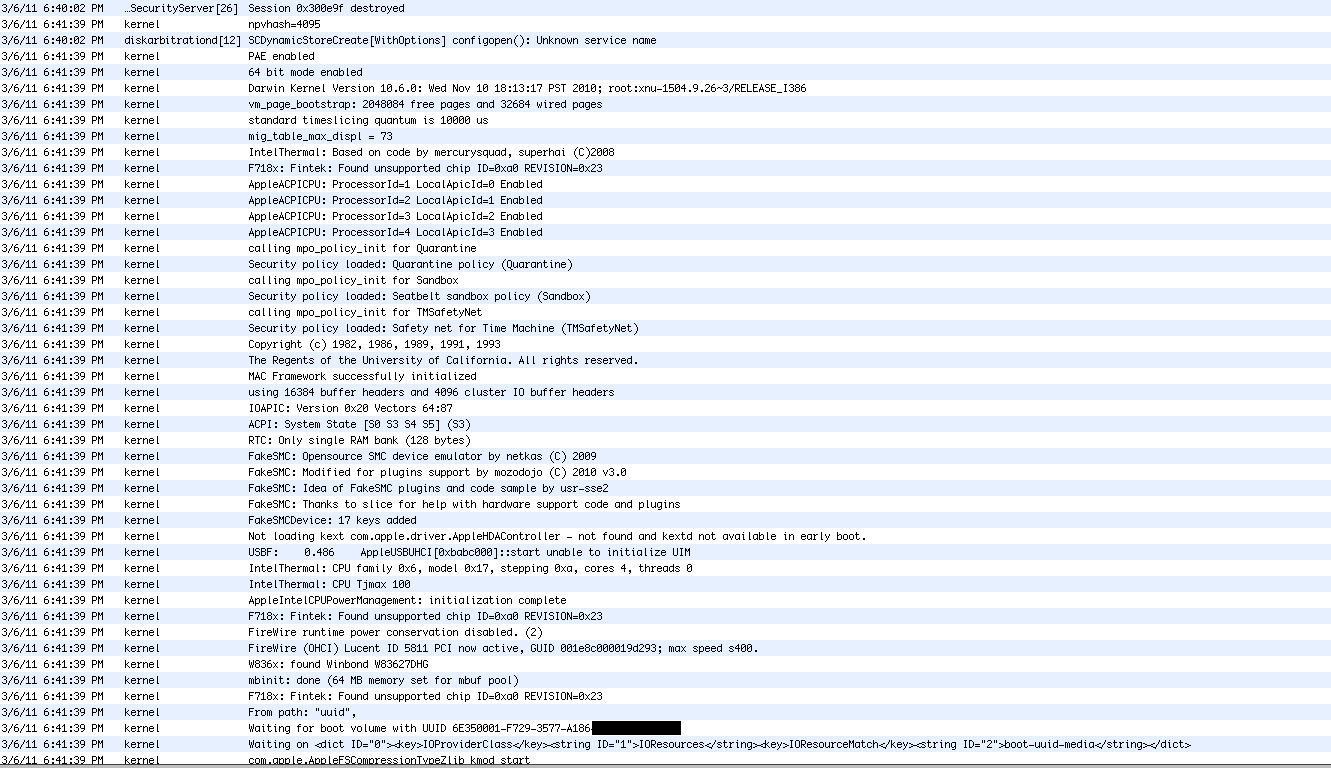

I still get system shutdown false and shutdown reason 3 in the boot log, but I read somewhere that this is "normal" even on apple hardware. (that also drive me nuts).
also the appleHDA complains and there is a post somehwere to fix it changing the pci vendor id or something. but my sounds works, so i didnt bother.
