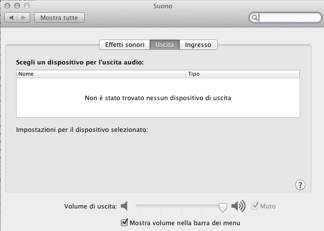

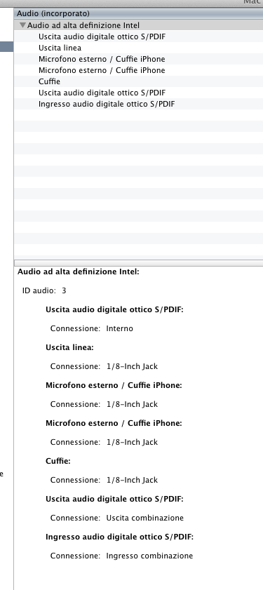

I have a P5K-E, but the audio chip is the same ad1988b; I've been using the integrated audio in until 10.6.7, after patching the new AppleHDA.kext as you said, or using yours, I get audio out working perfectly, but in system preferences I have only digital audio in, and no audio-in working. Placing the ad1988bfix.kext in /E/E I get the integrated mic working again (and also sound assertion during boot log). Is there any way to fix the internal mic, using only the new AppleHDA.kext?
Audio-in works for me with the kext I edited.
Maybe you missed the last step? (HDA Hardware Config Resource)
Compare the dict from key HDAConfigDefault in your AD1988bFix.kext with AppleHDAHardwareConfigDriver.kext (in the kext I attached).
You're right... or at least, I think so. When I looked into my kext, I found that I missed the last step, I don't know how... Never mind; I did a great mess with kexts and the kextcache of snow leopard. The first time I tried your kext, it didn't work, because (as I thought after) OSX hadn't the time to rebuild the kextcache before I rebooted. That's why I decided to make one myself, and (don't know why) I rebuilt the cache, but I didn't get that the cache was making it working. That was the kext not completely edited, and it explains why I didn't have audio-in working. Reading your answer, since I didn't make a backup of the original 10.6.8 AppleHDA, I reinstalled the update, and tried to repatch it, and it didn't work after a reboot (I didn't update the kextcache). After some other attemps, I tried to rebuild the kextcache with "touch /System/Library/Extensions"... After reboot, It was working, also the audio-in. Not satisfied, I reinstalled the DeltaUpdate, placed in /S/L/E your kext, rebuilt the cache and rebooted. Guess what?
It's working. ;)
I'm sorry, I did a really stupid mistake. Thanks for your help, time and work.
