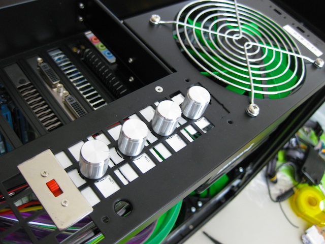

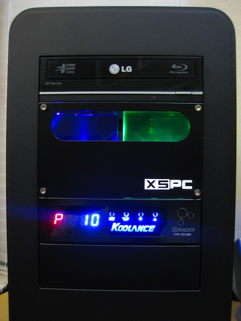

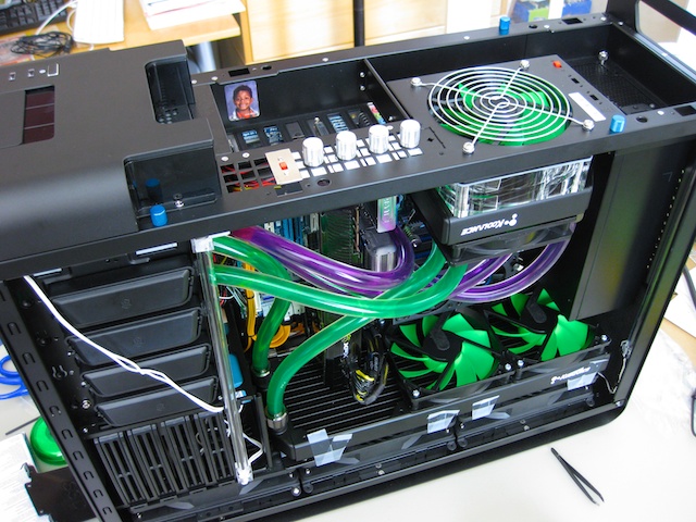

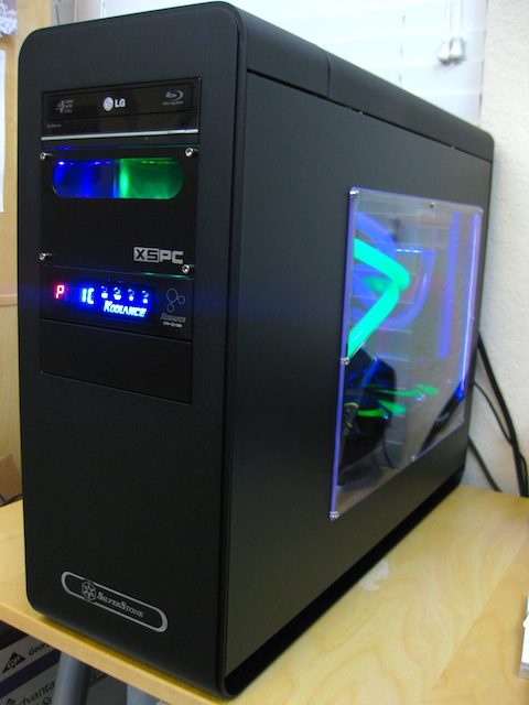

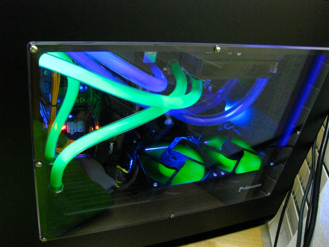

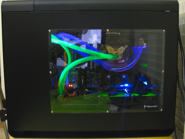

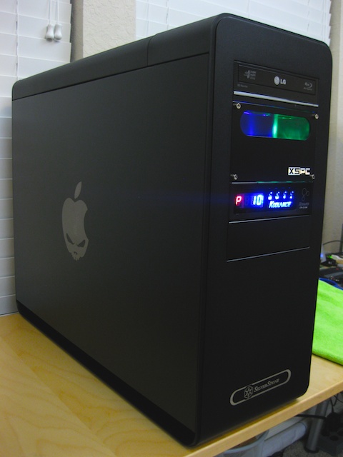

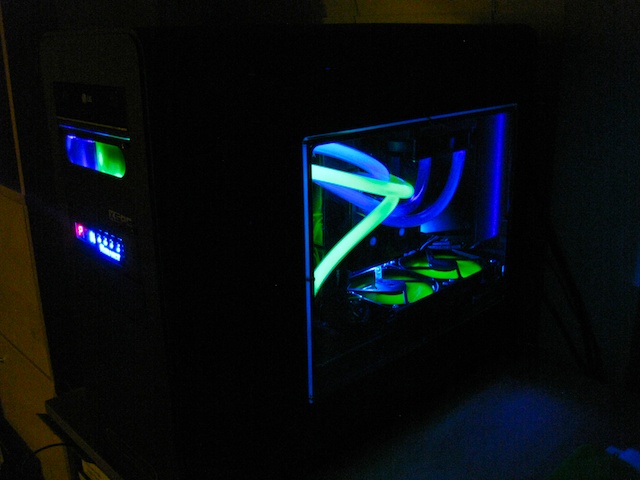

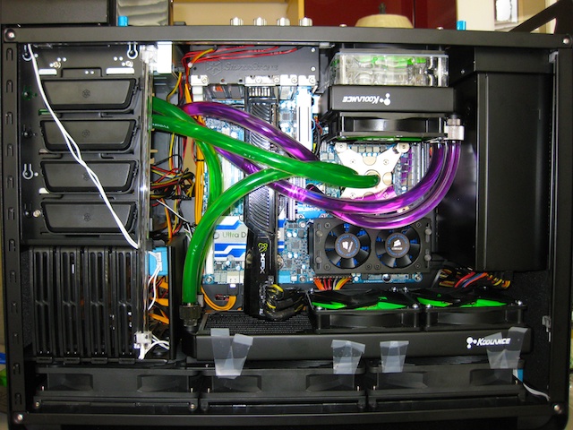

PunkNugget Posted July 8, 2010 Share Posted July 8, 2010 Hey everyone, I just want to follow up with those that have been following this particular post. Here is my Mac Hak Pro. My FIRST EVER PC/Mac Build. I'm extremely grateful to have had the opportunity to make this happen. Thanks to all who participated in their contribution; especially: - Paulo Dourado - with his YouTube video that inspired me to make this build happen as well as helping me through every little thing that was needed in the installation process of Mac OS X Snow Leopard 10.6.4. THIS GUY HAS GOT SOME MAD SKILLS AND IS FLAT OUT AMAZING FOR HIS AGE !!! I'll just say this, I'm a little more than twice his. - Todd & Tim at Koolance for their individual input on the liquid cooling install process (Now I'm a reseller for their product line) - Joel at Silverstone for the case, parts & fan choice (I too also resell their product line) - John at Sidewindercomputers.com - who helped me find all the other parts that I needed to make the liquid cooling process happen. - Mike - on YouTube (named: Miked826) who also helped me get some things straight when I started to have some issues with my unit. - Cybex - who made the biggest mistake; posting his initial comment on here that got me asking more questions. Thanks man for all your input and help, when at the end of all of it purchasing a USB optical sound adapter ended up happening instead. At least we tried and made the effort and that's what matters. Thanks again. Most of all I want to thank God and my Wife - who was very patient with me in watching the kids when I was going out of my mind trying to figure out how to put all of this together !!! VERY TIGHT BUILD, but everything fit !!! As you can see, I have both the Mobo and processor separately water cooled. The Intel i7 930 Core is running at 4.09 GHz using AS5 @ 42C, but will be using the Indigo-Xtreme (a Phase Change Metallic Alloy) here shortly; but not before a thorough temp video review coming soon. I'm excited to see how much lower the temps will be. Who knows, I may be able to clock it a bit higher to 4.2 GHz. But for now I'm extremely happy with my Geekbench 64bit scores @ 13,857... A few things to mention, the pic that has the control knobs on the top of the unit were custom cut and screwed on to fit and are completely out of the way when the cover is on. Oh, and please ignore the tape that is on the bottom 3 Rad; I only used that for placement purposes when I was building. I actually had to pull out the bottom Rad a few times to refit the wires and light rods. The tape is now gone. The Silverstone FM121 fans were all initially white, but spray painted the outer shell mat black and the fans UV Bright Green. And they react VERY WELL to the UV Light Rods. All cables and wires have been tucked away in back of the unit and are properly managed, so as to provide as much airflow possible in the unit. Lastly, I took the Hackintosh logo (designed by Jonzy; provided for free here: http://jonzy.deviantart.com/art/Apple-Skull-110417872) and slightly remodified it. Then had it digitally etched by a local engraver where we live (if you want to call 50 miles away local ). He did an amazing job. I even went a bit further on my mod and changed .png file of the apple screen logo to use Jonzy's Hackintosh logo (once again). Hope you like the pics and I look forward to any feedback that anyone has. Thanks again - EVERYONE !!! Link to comment https://www.insanelymac.com/forum/topic/199760-snow-leopard-install-for-gigabyte-ga-x58a-ud7-w-usb-30/page/5/#findComment-1506953 Share on other sites More sharing options...
Cybex Posted July 8, 2010 Share Posted July 8, 2010 Sweet machine And thanks for mentioning me.. At least I think you mean me, cause my name is Cybex (not Cyber) Link to comment https://www.insanelymac.com/forum/topic/199760-snow-leopard-install-for-gigabyte-ga-x58a-ud7-w-usb-30/page/5/#findComment-1507090 Share on other sites More sharing options...
