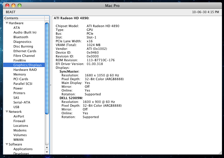

Rockett Posted June 30, 2010 Share Posted June 30, 2010 Old thread I realize. But if anyone is still trying to get this card to work, you need to use a Display Port > DVI adapter and DVI for dual-screen. Link to comment https://www.insanelymac.com/forum/topic/193883-sapphire-radeon-4890-wdisplay-port/#findComment-1501864 Share on other sites More sharing options...
