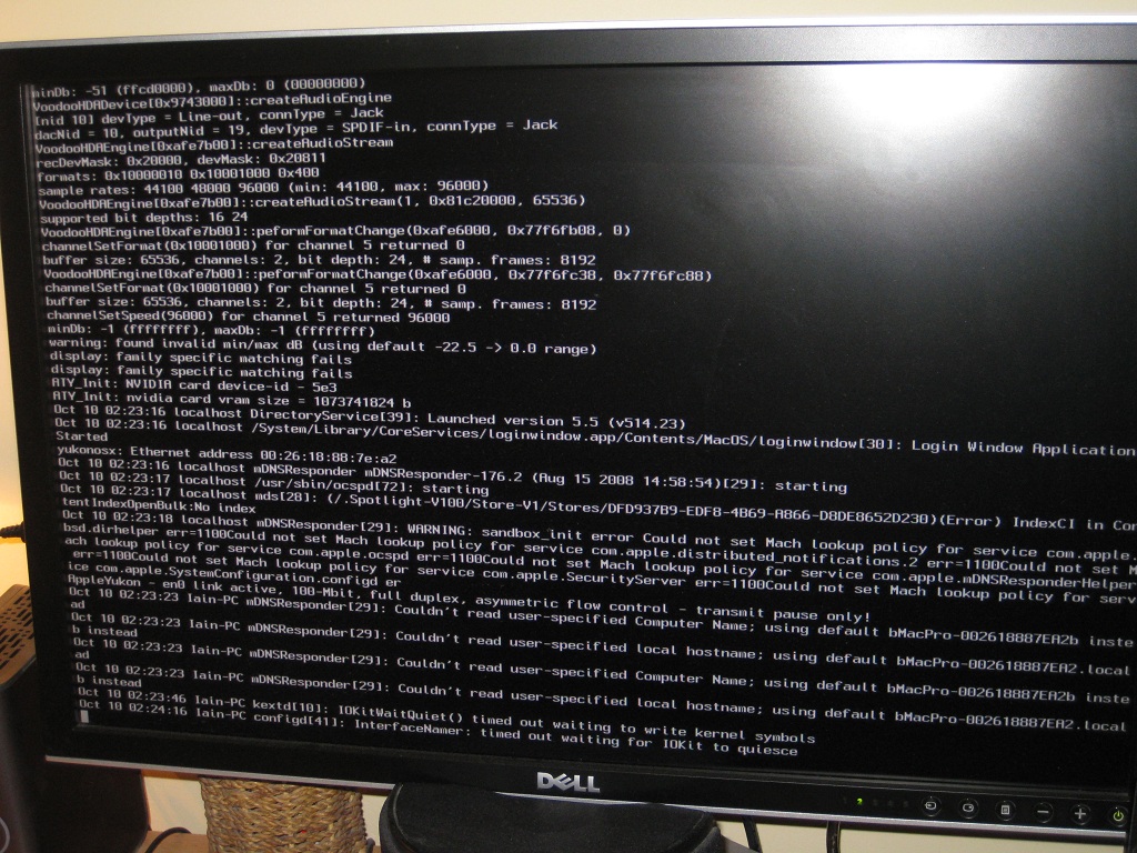

imacken Posted October 10, 2009 Author Share Posted October 10, 2009 I appreciate your help. Screen below. This happens with all distros iDeneb 10.5.5 10.5.6 and 10.5.7, also iATKOS 10.5.7, so it must be a hardware issue! I just need to get to a OSX86 desktop to retrieve my critical files! Link to comment https://www.insanelymac.com/forum/topic/191209-p6t-deluxei7-920gtx-285-i-just-wasted-%C2%A31100-maybe/#findComment-1295300 Share on other sites More sharing options...
bertmannaustria Posted October 10, 2009 Share Posted October 10, 2009 I appreciate your help. Screen below. This happens with all distros iDeneb 10.5.5 10.5.6 and 10.5.7, also iATKOS 10.5.7, so it must be a hardware issue! I just need to get to a OSX86 desktop to retrieve my critical files! okay, after my RETAIL installation, it remains at the same point ... for about 10 minutes but then it booted into leo. if you don't get to your leo desktop, i think it's because of your 295 nvidia. is see, it's recognized by the ATY kext, but if your pc "freezes" after "timed out waiting for IOKit to quiesce" for longer than 15 mintues, i think it's because auf your nvidia card. you have to imagine that sure the card is recognized by ATI inject, but there are no hardware ID's in NVDANV50HAL, neither in snow leopard, i have to use an efi string AND patch the NVDANV50HAL kext too to get into the desktop with an gtx 295. just try using an older card, boot and wait at least 10 minutes before giving up Link to comment https://www.insanelymac.com/forum/topic/191209-p6t-deluxei7-920gtx-285-i-just-wasted-%C2%A31100-maybe/#findComment-1295376 Share on other sites More sharing options...
imacken Posted October 10, 2009 Author Share Posted October 10, 2009 okay, after my RETAIL installation, it remains at the same point ... for about 10 minutes but then it booted into leo. if you don't get to your leo desktop, i think it's because of your 295 nvidia. is see, it's recognized by the ATY kext, but if your pc "freezes" after "timed out waiting for IOKit to quiesce" for longer than 15 mintues, i think it's because auf your nvidia card. you have to imagine that sure the card is recognized by ATI inject, but there are no hardware ID's in NVDANV50HAL, neither in snow leopard, i have to use an efi string AND patch the NVDANV50HAL kext too to get into the desktop with an gtx 295. just try using an older card, boot and wait at least 10 minutes before giving up OK thanks again. As changing the card over is quite a major thing, what do I do if the other card works, in terms of the GTX 285? Boot into desktop and find a kext/EFI string for the 285? Link to comment https://www.insanelymac.com/forum/topic/191209-p6t-deluxei7-920gtx-285-i-just-wasted-%C2%A31100-maybe/#findComment-1295382 Share on other sites More sharing options...
bertmannaustria Posted October 10, 2009 Share Posted October 10, 2009 OK thanks again. As changing the card over is quite a major thing, what do I do if the other card works, in terms of the GTX 285? Boot into desktop and find a kext/EFI string for the 285? before you can change to a gtx card, patch all other things needed for your computer to run leo well, update to 10.5.8 (because of the graphics drivers) and then you should use chameleon rc3 with graphicsenabler set to YES. that should work but i can't prove it because i first startet using gtx cards in snow leopard. maybe you have to generate an efi string but i think at the moment it is an more importent factor to get your system running Link to comment https://www.insanelymac.com/forum/topic/191209-p6t-deluxei7-920gtx-285-i-just-wasted-%C2%A31100-maybe/#findComment-1295417 Share on other sites More sharing options...
imacken Posted October 10, 2009 Author Share Posted October 10, 2009 OK, major progress! The good news is you were right! Well done. I put in the 8800GTS, waited for 4 minutes at the point we've talked about, screen went black, waited another 4 minutes and hey .... the opening video started up complete with sound, full 1900x1200 res and acceleration enabled! I was excited, but .... The bad news is I am stuck in an endless loop of video, identify keyboard, language etc, 'Don't transfer my info now', wait 1 minute, then the video just starts up again, and then repeat ad nauseum! What now!?! Link to comment https://www.insanelymac.com/forum/topic/191209-p6t-deluxei7-920gtx-285-i-just-wasted-%C2%A31100-maybe/#findComment-1295565 Share on other sites More sharing options...
