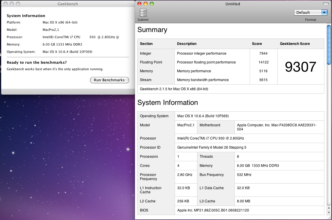

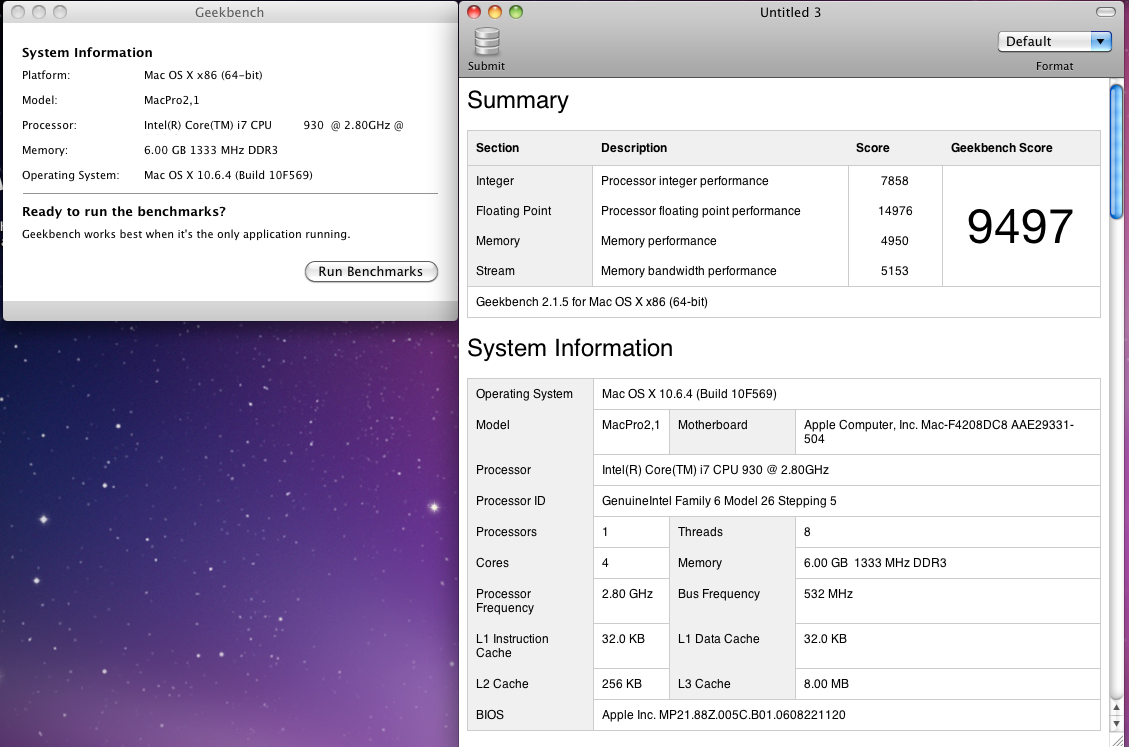

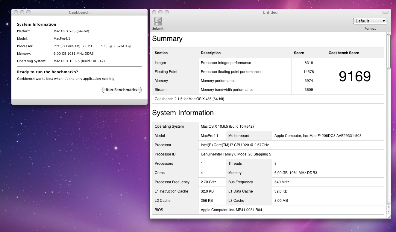

S.V. Posted September 24, 2010 Share Posted September 24, 2010 To User 01 I was making some tests in my machine with geekbench 64, and it seems that if you don't use the NullCPUPowerManagement.kext, then you get a worse benchmark. I would suggest you to do the same test and post here. For me, the result was: Benchmark with NullCPUPowerManagement.kext = +-9210 (I dit it several times, and the result was about this) Benchmark without NullCPUPowerManagement.kext = +-5800 Link to comment https://www.insanelymac.com/forum/topic/189712-guide-retail-snow-leopard-install-on-dx58so-core-i7-mobo/page/6/#findComment-1553806 Share on other sites More sharing options...
user01100 Posted September 25, 2010 Share Posted September 25, 2010 No NullCPUPowerManagement.kext, only dsdt.aml, this is the score...see below... Try and generate your own dsdt; i see you have a 930 cpu... Link to comment https://www.insanelymac.com/forum/topic/189712-guide-retail-snow-leopard-install-on-dx58so-core-i7-mobo/page/6/#findComment-1554166 Share on other sites More sharing options...

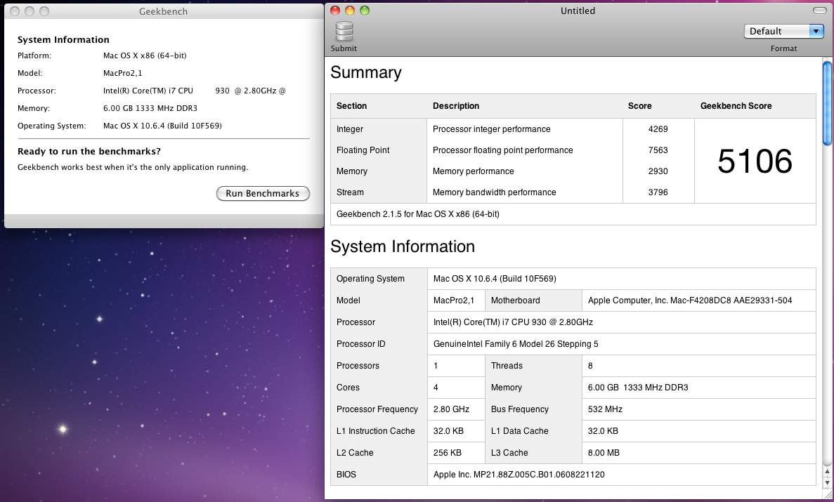

S.V. Posted September 25, 2010 Share Posted September 25, 2010 No NullCPUPowerManagement.kext, only dsdt.aml, this is the score...see below... Try and generate your own dsdt; i see you have a 930 cpu... Before doing them I used DSDT Patcher, which generated a dsdt.aml, which is located on my root directory. I am posting three benchmarks. 1)Without NullCpuPowermanagement: 5106 2)With NullCpuPowermanagement: 9307 2)With NullCpuPowermanagement and running kext utility at the same time: 9497 Link to comment https://www.insanelymac.com/forum/topic/189712-guide-retail-snow-leopard-install-on-dx58so-core-i7-mobo/page/6/#findComment-1554314 Share on other sites More sharing options...
user01100 Posted September 25, 2010 Share Posted September 25, 2010 Really strange...i don't know what's making this differences...in bios i have the defaults settings and the version is 5456... Link to comment https://www.insanelymac.com/forum/topic/189712-guide-retail-snow-leopard-install-on-dx58so-core-i7-mobo/page/6/#findComment-1554333 Share on other sites More sharing options...
S.V. Posted September 26, 2010 Share Posted September 26, 2010 Really strange...i don't know what's making this differences...in bios i have the defaults settings and the version is 5456... I updated the Bios to 5456 and the problem disappears. Nice insight from you! thanks! I am thinking about buying a wireless card. Do you have any suggestion? Edit: Actually, I had to change my smbios.plist file. Otherwise, the problem remains. Now my benchmark is about 9950. Link to comment https://www.insanelymac.com/forum/topic/189712-guide-retail-snow-leopard-install-on-dx58so-core-i7-mobo/page/6/#findComment-1554483 Share on other sites More sharing options...
