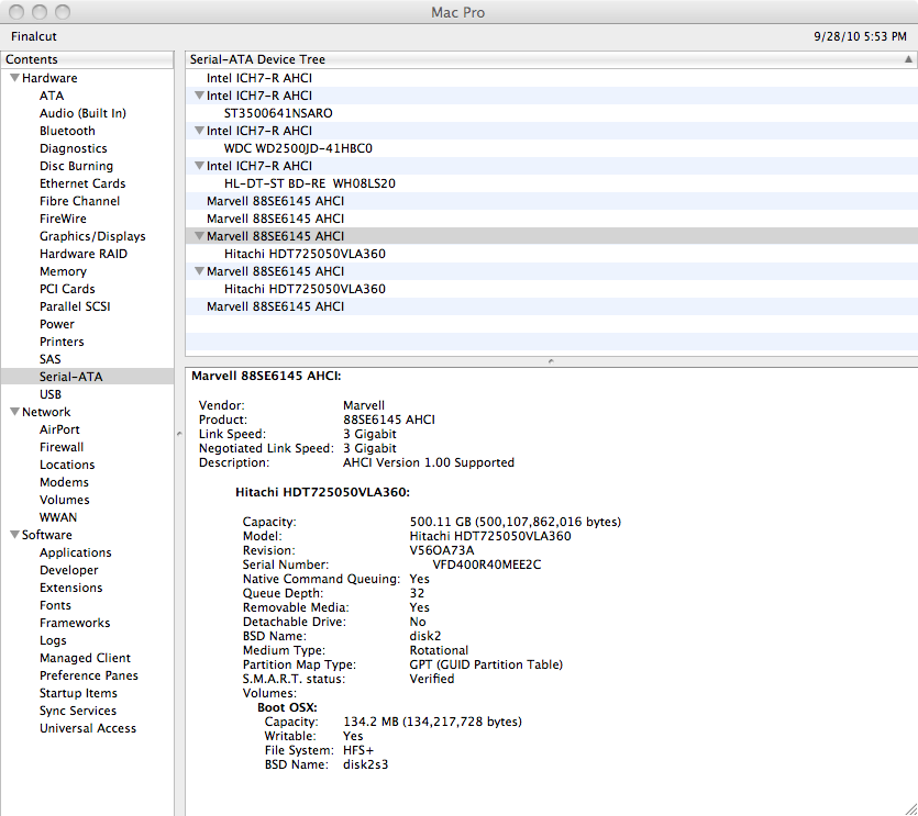

jaminmc Posted September 28, 2010 Share Posted September 28, 2010 Ok, NO MORE KEXT EDITING!!!!!! I edited the AHCIPortInjector.kext do that that it is working on my 2 drives connected to my Marvell controller. Badaxe2_AHCIPortInjector.zip It also injects the ICH7-R when it is even set to IDE mode in your BIOS. -- Wont have to switch back and forth if you dual boot windows.... I have only tested this using it in /Extra/10.6 on my EFI partition. I don't know if it would work in the /System/Library/Extensions folder. With this, you can keep your system drive Vanilla. I tried to make this as simple as possible, and even included my script I use to set the permissions and make the Extensions.mkext file. Put the kext file into your /Extra/10.6/Extensions folder (You may not have a 10.6 folder if you don't have a dual boot. I do, so this works on that. ) Put the Extensions.command in your /Extra/10.6 folder. then in finder, double click it to run it. It should leave a Extensions.mkext in that folder, where it belongs Link to comment https://www.insanelymac.com/forum/topic/188482-badaxe2-marvell-sata-working-in-snow-leopard/#findComment-1556194 Share on other sites More sharing options...
pihva Posted January 5, 2011 Share Posted January 5, 2011 Ok, NO MORE KEXT EDITING!!!!!! I edited the AHCIPortInjector.kext do that that it is working on my 2 drives connected to my Marvell controller. Using this kext I see SATA drive connected to Marvell port (and see all Marvell ports in Sys. Profiler). But once I start using this drive, in one minute or so, drive disappears. And then Systeme Profiler doesn't show any SATA ports, Marvell or Intel. Link to comment https://www.insanelymac.com/forum/topic/188482-badaxe2-marvell-sata-working-in-snow-leopard/#findComment-1615169 Share on other sites More sharing options...
