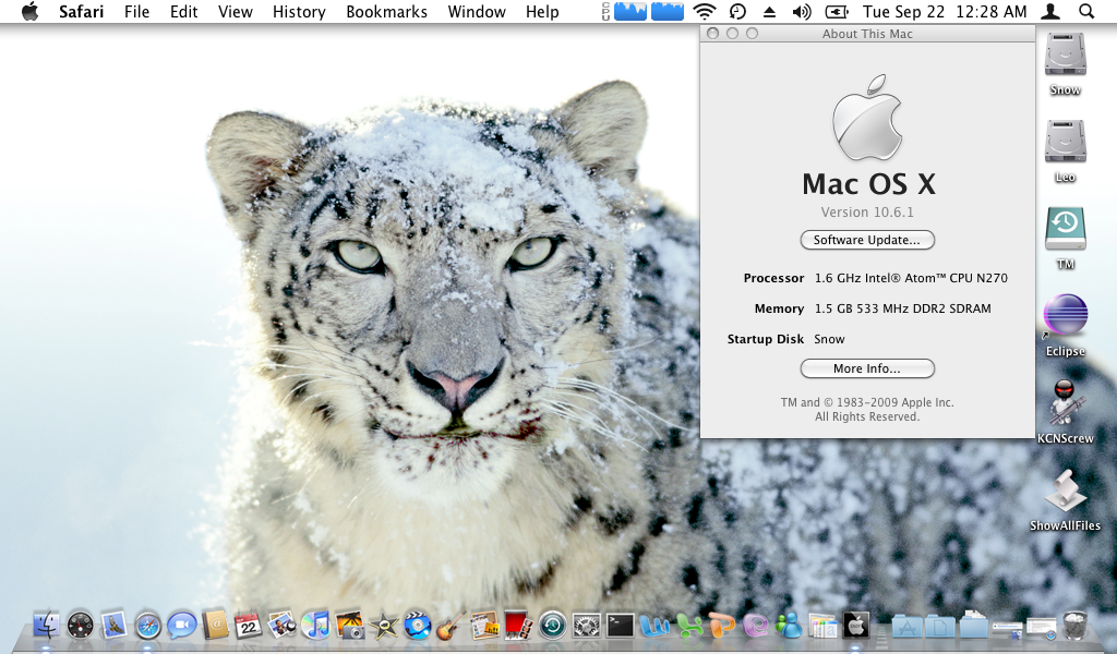

Neodymium Posted September 9, 2009 Share Posted September 9, 2009 Hi All! I finally got around to posting something meaningful to the forums. I successfully installed Snow Leopard onto my Acer Aspire One A150. Specs and instructions are below: My specs: Acer Aspire One A150 Pearl Intel Atom N270 1.6 GHz, 1.5 GB RAM, 160GB HDD Dual Booting (Chameleon RC1) - Leopard (100GB)/Snow (52GB) - GPT - Got Rid of Windows Finally! Here is how I got around to installing Snow Leopard 10A432 on my Aspire One. I take no credit for the information. I was wandering on Google to find a perfect guide and a few weeks ago, I stumbled upon a Russian website that had posted most part of these instructions. After battling with Google Translate and Babelfish, I finally was ready to post the instructions. I took a print of the instructions and downloaded the attachments before I started. If I ever find the website again, I will post back here. So without further ado, here we go. - Installing from a working OS X 10.5.8 on aao-150 (bios 3310) - Partitioning GUID, bootloader pc-efi v10.2 in the EFI partition 1. Mount the original image and run the installation: Find the image from usual sources. in the terminal type: open /Volumes/Mac\OS\ X\ Install\ DVD/System/Installation/Packages/OSInstall.mpkg Complete Installation 2. We now have to prepare EFI partition and set the bootloader unpack the attached archive to your desktop (you can choose other locations, the instructions below assume you unpacked to the desktop) While in terminal, type the following: sudo-s Password diskutil list diskXs1 - hidden EFI partition HDD where we will set 10.6 format the EFI partition (Warning: Do not make mistakes with the disks and partitions - I am not responsible for your selections) diskutil eraseVolume "HFS+" "EFI" /dev/diskXs1 Now we will put bootloader into the EFI partition a. cd ~/Desktop/aa1/pc_efi b. (Please note the period before this command) ./fdisk -f boot0 -u -y /dev/rdiskX (rdiskX here is your first drive that the EFI partition resides on) c. dd if=boot1h of=/dev/rdiskXs1 d. mkdir /Volumes/EFI e. mount_hfs /dev/diskXs1 /Volumes/EFI f. cp boot_v10.2 /Volumes/EFI/boot g. mkdir /Volumes/EFI/.fseventsd h. touch /Volumes/EFI/.fseventsd/no_log 3. Set extensions (DSDT.aml made for aao150 bios 3310, if you have more hardware than the store version, you will need to make your own DSDT) a. mkdir /Volumes/EFI/Extra b. cp ~/Desktop/aa1/plist/*.plist /Volumes/EFI/Extra c. cp ~/Desktop/aa1/dsdt/DSDT.aml /Volumes/EFI/Extra d. mkdir /Volumes/EFI/Extra/Extensions e. cp -R ~/Desktop/aa1/kexts/*.kext /Volumes/EFI/Extra/Extensions 4. IMPORTANT STEP! BY RULE DO THESE ON THE VOLUME YOU INSTALLED SNOW TO (X MARKS THE SPOT) a. chmod -R 755 /Volumes/EFI/Extra/Extensions b. chown -R root:wheel /Volumes/EFI/Extra/Extensions c. chmod -R 755 /Volumes/x/System/Library/Extensions d. chown -R root:wheel /Volumes/x/System/Library/Extensions 5. Create caches a. kextcache -a i386 -m /Volumes/x/System/Library/Caches/com.apple.kext.caches/Startup/Extensions.mkext /Volumes/x/System/Library/Extensions /Volumes/EFI/Extra/Extensions b. kextcache -a i386 -m /Volumes/EFI/Extra/Extensions.mkext /Volumes/EFI/Extra/Extensions /Volumes/x/System/Library/Extensions c. chmod 755 /Volumes/EFI/Extra/Extensions.mkext d. chown root:wheel /Volumes/EFI/Extra/Extensions.mkext e. chmod 755 /Volumes/x/System/Library/Caches/com.apple.kext.caches/Startup/Extensions.mkext f. chown -R root:wheel /Volumes/x/System/Library/Caches/com.apple.kext.caches/Startup/Extensions.mkext 6. Unmount and remove EFI partition from view a. umount -f /Volumes/EFI b. rm -rf /Volumes/EFI 7. Reboot! The first boot is pretty long - be patient - keep your hands away from the power button! If you're bored, you can startup with key -v (Verbose), to see what we have going on there <LOL> You should now hear the startup music and the rest is...well you know already MAINTENANCE ONLY! ONLY DO THIS IF SOMETHING IS NOT WORKING THE WAY IT SHOULD. With Snow I noticed the issue is mostly with permssions and the mkext is finicky. Fixing rights and rebilding caches In the terminal type (This is done from within Snow, if you cannot access Snow, you can also do this from Leo, just start adding /Volumes/Leo to the locations below) a. chown root:wheel / b.mount the EFI partition - mkdir /Volumes/EFI - mount_hfs /dev/diskXs1 /Volumes/EFI - kextcache -a i386 -m /System/Library/Caches/com.apple.kext.caches/Startup/Extensions.mkext /System/Library/Extensions /Volumes/EFI/Extra/Extensions - kextcache -a i386 -m /Volumes/EFI/Extra/Extensions.mkext /Volumes/EFI/Extra/Extensions /System/Library/Extensions - umount-f /Volumes/EFI - rm -rf /Volumes/EFI - reboot *** UPDATED: Used the attached kext to get SD going, still cannot access MMC though - Make sure you follow the maintenance procedure above after installing the kext - My preferred tool is KextHelper *** I didn't have time to work with the SD reader, I will post an update when I get a chance. Everything else should work, restart, shutdown, speedstep, calibrating the display, touchpad, automatic switching sound on headphones As I said, Snow is very finicky to the presence of caches and the proper permissions to files, so that if any kexts give you errors, do not forget to reboot to fix the rights and rebuild caches using the maintenance procedure. A screenshot of my desktop is attached as well. OTHER NOTES: - First startup took me almost 15-20 minutes. - Wireless is working after I edited the Info.plist for 1395 Broadcom Wireless in the IO80211Family.kext and entered my vendor id (pci14e4,4315) - Havent tested a lot of other things, but I know one thing for sure, on my A150, Snow flies better than Leopard!!!!!!!!! - Please PM me if you have any questions. **** MIC STILL DOESNT WORK, NOR DOES SLEEP, WORKING ON OTHER KEXTS AVAILABLE OUT THERE, WILL HAVE TO DO SOMETHINGS MYSELF THAN INSTALLING A KEXT **** EXTERNAL DISPLAY IS GARBLED, TEARS AS SOON AS YOU PLUGIN THE CABLE **** ANYONE HAVE ANY IDEAS? **** Thanks for looking and Good Luck. UPDATE: 10.6.1 UPDATE APPLIED THROUGH SOFTWARE UPDATE! aa1.zip IOSDHCIBlockDevice.kext.zip Link to comment https://www.insanelymac.com/forum/topic/185194-perfectly-working-106-on-acer-aspire-one-a150/ Share on other sites More sharing options...

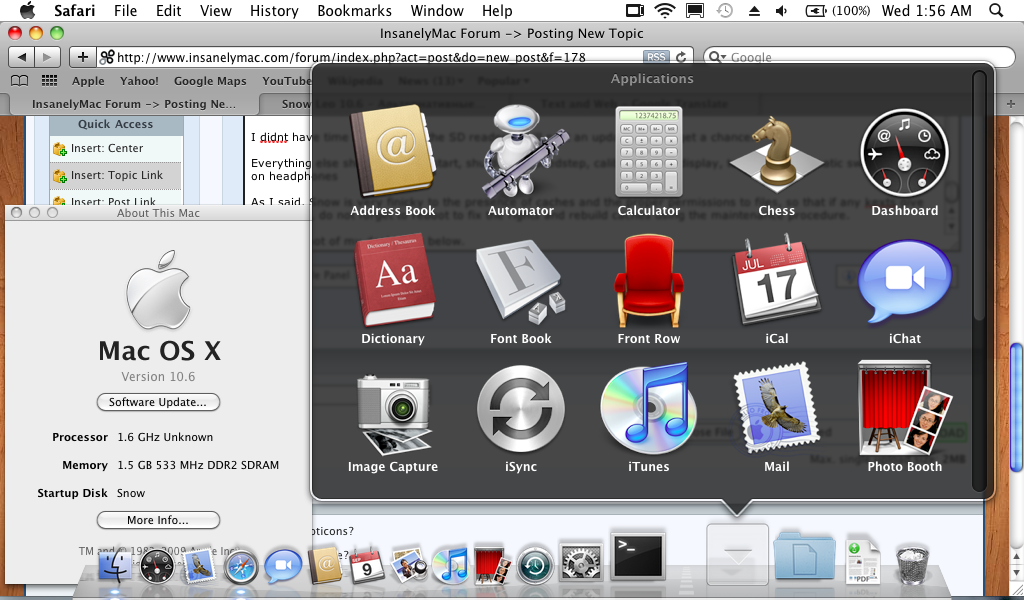

theproto Posted September 21, 2009 Share Posted September 21, 2009 Neodymium - What exactly did you do to get full resolution/QE on the GMA950 (Aspire One)? I used the 72ae script, along with your EFI string and DSDT (matched mine aside for the OVGA portion you worked on) so I used yours to get going quick. I have tried sooooo many things now... I mean even slipping the 27a2 device ID into the DSDT (the OS saw the device ID but wouldn't load the drivers still). Once I get this last piece working I will likely stray from the included kexts and such but I figure if I follow exactly what you did to get the video working I will be in good shape from there. On a side note... I am up and running with 10.6 on my notebook (Toshiba using Boot Think 2.3) however this is my wife's netbook and I am hoping to get everything right. I am running airport cards in both devices flawlessly form eBay for $15 shipped... Thanks! Link to comment https://www.insanelymac.com/forum/topic/185194-perfectly-working-106-on-acer-aspire-one-a150/#findComment-1274627 Share on other sites More sharing options...
Neodymium Posted September 21, 2009 Author Share Posted September 21, 2009 Neodymium - What exactly did you do to get full resolution/QE on the GMA950 (Aspire One)? I used the 72ae script, along with your EFI string and DSDT (matched mine aside for the OVGA portion you worked on) so I used yours to get going quick. I have tried sooooo many things now... I mean even slipping the 27a2 device ID into the DSDT (the OS saw the device ID but wouldn't load the drivers still). Once I get this last piece working I will likely stray from the included kexts and such but I figure if I follow exactly what you did to get the video working I will be in good shape from there. On a side note... I am up and running with 10.6 on my notebook (Toshiba using Boot Think 2.3) however this is my wife's netbook and I am hoping to get everything right. I am running airport cards in both devices flawlessly form eBay for $15 shipped... Thanks! http://www.mediafire.com/?sharekey=4334f6f...04e75f6e8ebb871 Get the SnowGMA.zip from here and go through the maintenance procedure again...(see below) In the terminal type (This is done from within Snow, if you cannot access Snow, you can also do this from Leo) a. chown root:wheel / b.mount the EFI partition - mkdir /Volumes/EFI - mount_hfs /dev/diskXs1 /Volumes/EFI - kextcache -a i386 -m /System/Library/Caches/com.apple.kext.caches/Startup/Extensions.mkext /System/Library/Extensions /Volumes/EFI/Extra/Extensions - kextcache -a i386 -m /Volumes/EFI/Extra/Extensions.mkext /Volumes/EFI/Extra/Extensions /System/Library/Extensions - umount-f /Volumes/EFI - rm -rf /Volumes/EFI - reboot Link to comment https://www.insanelymac.com/forum/topic/185194-perfectly-working-106-on-acer-aspire-one-a150/#findComment-1275548 Share on other sites More sharing options...
theproto Posted September 21, 2009 Share Posted September 21, 2009 http://www.mediafire.com/?sharekey=4334f6f...04e75f6e8ebb871 Might I ask how exactly you patched these files as mine did not work when I used the script and tried others? I've have been around since the 10.4 days on the BX2 and have always done my setups by hand rarely requiring me to ask a question until we get to the video part and this one kicked me in the butt. I will try these out shortly (right now). Link to comment https://www.insanelymac.com/forum/topic/185194-perfectly-working-106-on-acer-aspire-one-a150/#findComment-1275939 Share on other sites More sharing options...
theproto Posted September 22, 2009 Share Posted September 22, 2009 Well... I did get it going and found out why I was unable to before... I needed to remote the original kexts out of /S/L/E... I am not sure if this is a "Boot Think" loader issue or this is how it must be done as I am not used to having duplicate kexts in the first place. Oh well... I will dig further, thanks for the files. Link to comment https://www.insanelymac.com/forum/topic/185194-perfectly-working-106-on-acer-aspire-one-a150/#findComment-1275973 Share on other sites More sharing options...
