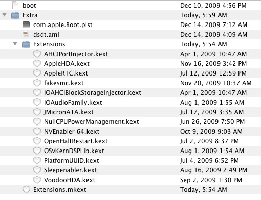

poonone Posted December 19, 2009 Share Posted December 19, 2009 Since I don't want to abandon this thread here's how I got the Coaxial SPDIF Out working in OS 10.6 on my P5W DH Deluxe with the 975X Intel chipset and a Realtek ALC 882 Onboard Audio Card. All this boots up with a Chameleon boot. 1) I used the attached kexts in the Extra/Extensions Folder. -The AppleHDA.kext is patched by dropping my Linux Codec Dump file on Taruga's AppleHDAPatcherv1.20 after backing up the original one in my System/Library/Extensions Folder. The patcher patches the file directly into that folder so MAKE SURE TO BACK UP. 2) I moved the patched file out of there into my Extra/Extensions Folder. 3) I just used the voodooHDA.kext file that I found looking around dated Nov 26, 2009 as it seemed to have a description that handled more of my problems. 4) That was dropped in the Extra/Extensions Folder also. 5) Run the permissions stuff in post 80 in this thread. 6) Set system sounds and output to SPDIF. 7) THE KEY FOR ME WAS...........> Go into MIDI handler (type midi into spotlight). Click on SPDIF-out and change the format to 48000.0 Hz and choose 2ch-16bit. I know this isn't everything to everyone, but it got me audio out of the SPDIF Coaxial.... A big plus for me. See screengrab in my last post for the Extra folder contents I use... My dsdt.aml is patched off my bios which is 2901 I believe. I have HD Audio set to Vista in my BIOS. NOW.... Anyone know how to get this damn thing to come back from sleep...? ALC882_SPDIF_kexts.zip Link to comment https://www.insanelymac.com/forum/topic/181769-%EF%A3%BF-p5w-dh-deluxe-success/page/8/#findComment-1363667 Share on other sites More sharing options...
