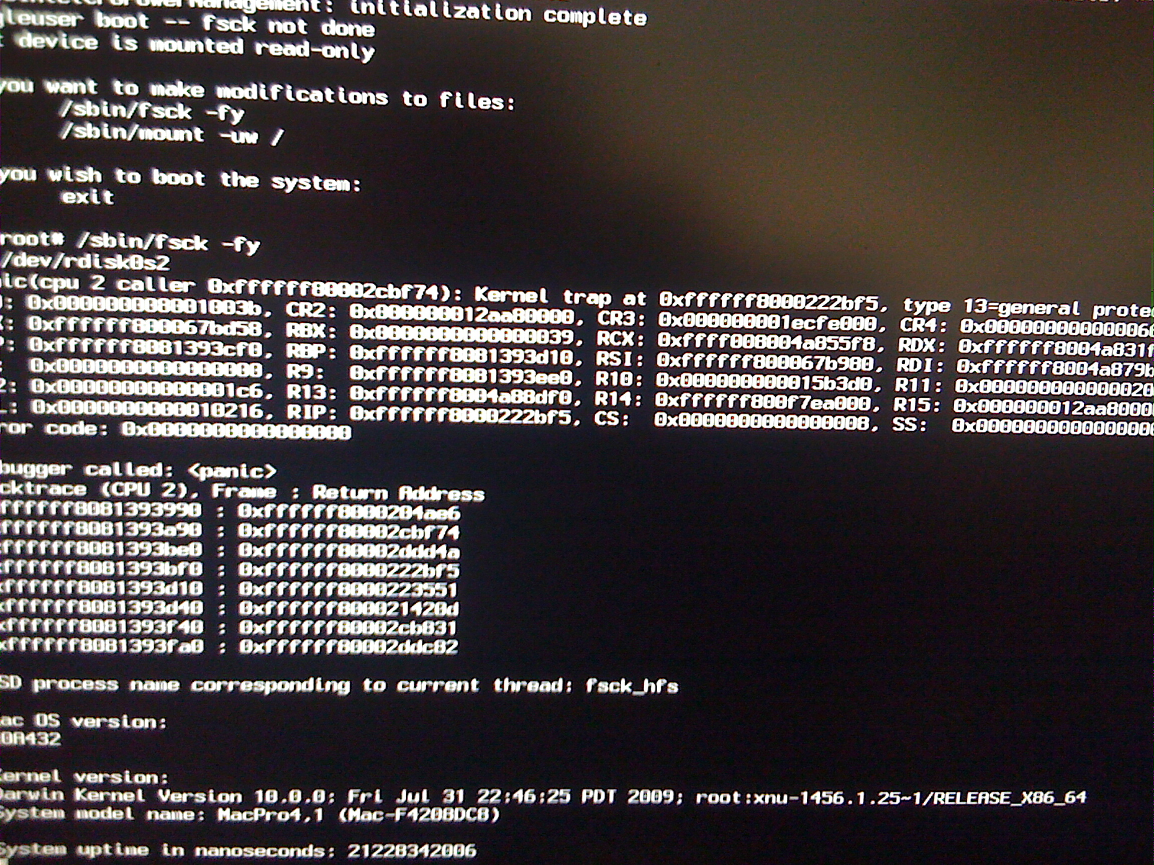

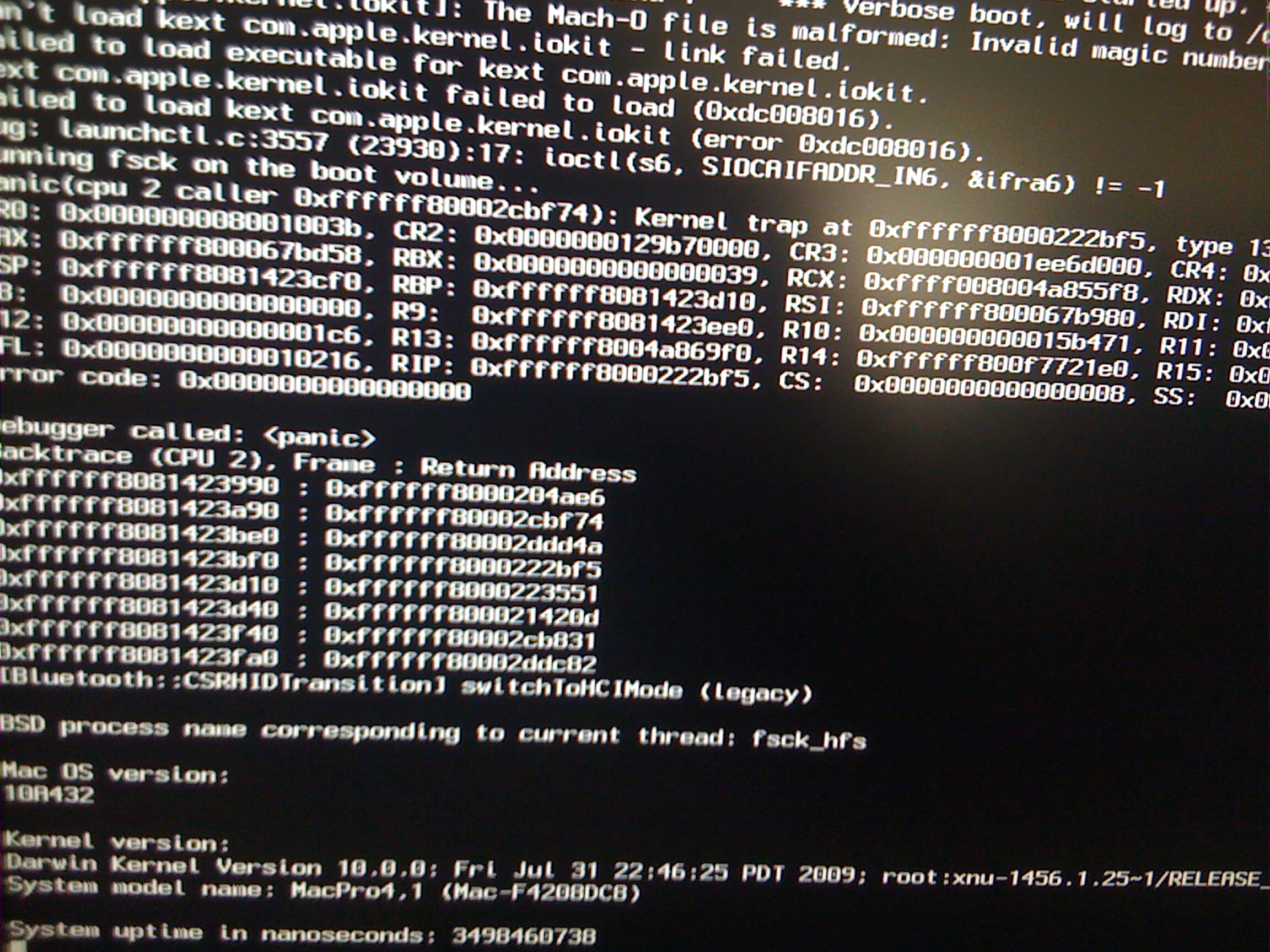

KariNeko Posted August 23, 2009 Share Posted August 23, 2009 Update: Fixed, use PCEfi 10.1 instead of 10.2. Â Â Original Post: As I pointed in my other thread titled "Waiting for DSMOS... thats the best result I get with this motherboard, it's booting in safe mode and in default 64bit mode and geting stuck there. Â So summing this up, my results where (my default mode is 64 bit): Â When I boot in -x32 -x I get a Kernel Panic. Â When I boot in -s I get a Kernel Panic when I try to run fsck command. Â When I boot without arguments I get a Kernel Panic. Â When I boot in -x I get stuck at "Waiting for DSMOS..." thing. Â My install steps where: 1 Installed Snow Leopard to another drive from within Leopard. 2 Installed Chameleon-2.0-r431 to that drive. 3 Replaced boot file at that volume with PCEfi 10.2 ones. 4 Placed DSDT.aml at / of that partition. Also tried on /Extra. 5 Placed fakesmc.kext first at /S/L/E. Then at /E. Tried both versions of fakesmc.kext, and also dsmos Snow build. 6 chmod 775, chown 0:0 those files. I'm also using nektas AppleIntelPIIXATA.kext in either /E and /S/L/E as it seems that this motherboard has problems in AHCI mode and I have to set it to IDE Compatible mode. Link to comment https://www.insanelymac.com/forum/topic/181197-fixed-asus-p6t-deluxe-v2-kernel-panic-almost-every-method-to-boot/ Share on other sites More sharing options...
KariNeko Posted August 23, 2009 Author Share Posted August 23, 2009 Update  Replaced EFI Boot 10.2 with 10.1 and it changed a little for better but not that much: (default mode 64 bit)  -x32 "Waiting for DSMOS..."  -x32 -s Can run fsck, made the mkext file, then exited and the then again "Waiting for DSMOS..."  -s Kernel Panic when running fsck manually  no parameters Kernel Panic Link to comment https://www.insanelymac.com/forum/topic/181197-fixed-asus-p6t-deluxe-v2-kernel-panic-almost-every-method-to-boot/#findComment-1232894 Share on other sites More sharing options...
