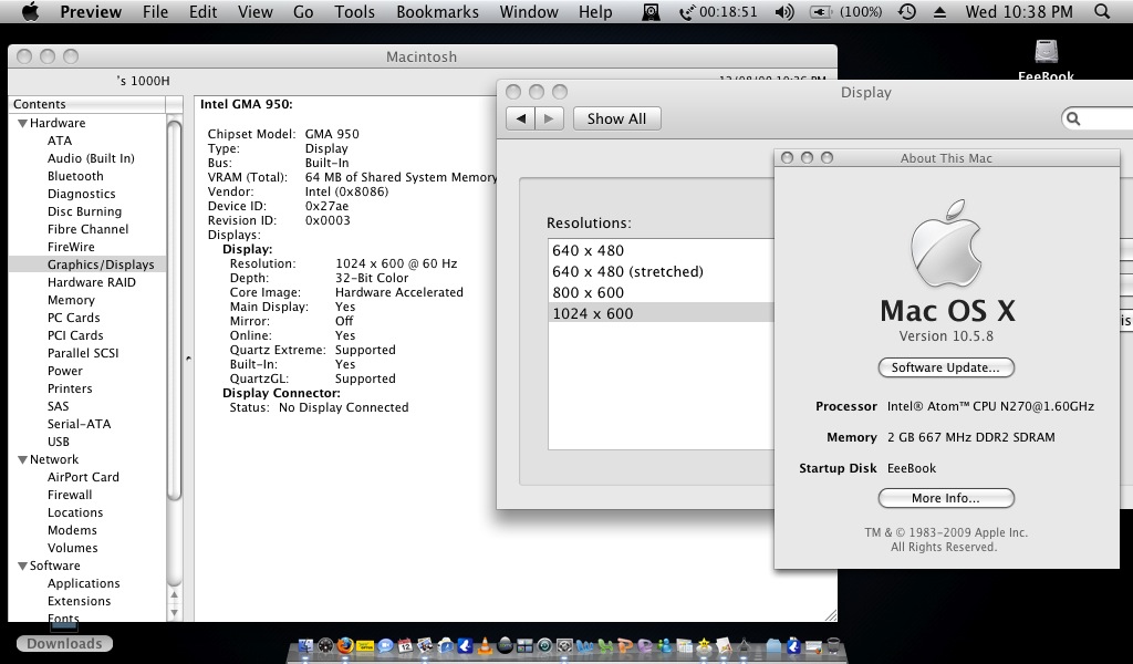

N00bishMacer Posted August 12, 2009 Share Posted August 12, 2009 I currently have a 1000HA running OS X 10.5.8 . I too had issues with the resolution stuck at 800x600. I followed the modification to both the AppleIntelIntegratedFrameBuffer.kext , and AppleIntelGMA950.kext, with no success. But when combined with Natit.kext and ClamshellDisplay.kext from the Eee Utilities, l got full hardware support including QE/CI running at 1024 x 600. Big thanks to Sparc4 for the information he has provided. And l hope this info helps others. Link to comment https://www.insanelymac.com/forum/topic/178926-1058-gma950-27ae-for-eeepc-and-others/#findComment-1223855 Share on other sites More sharing options...

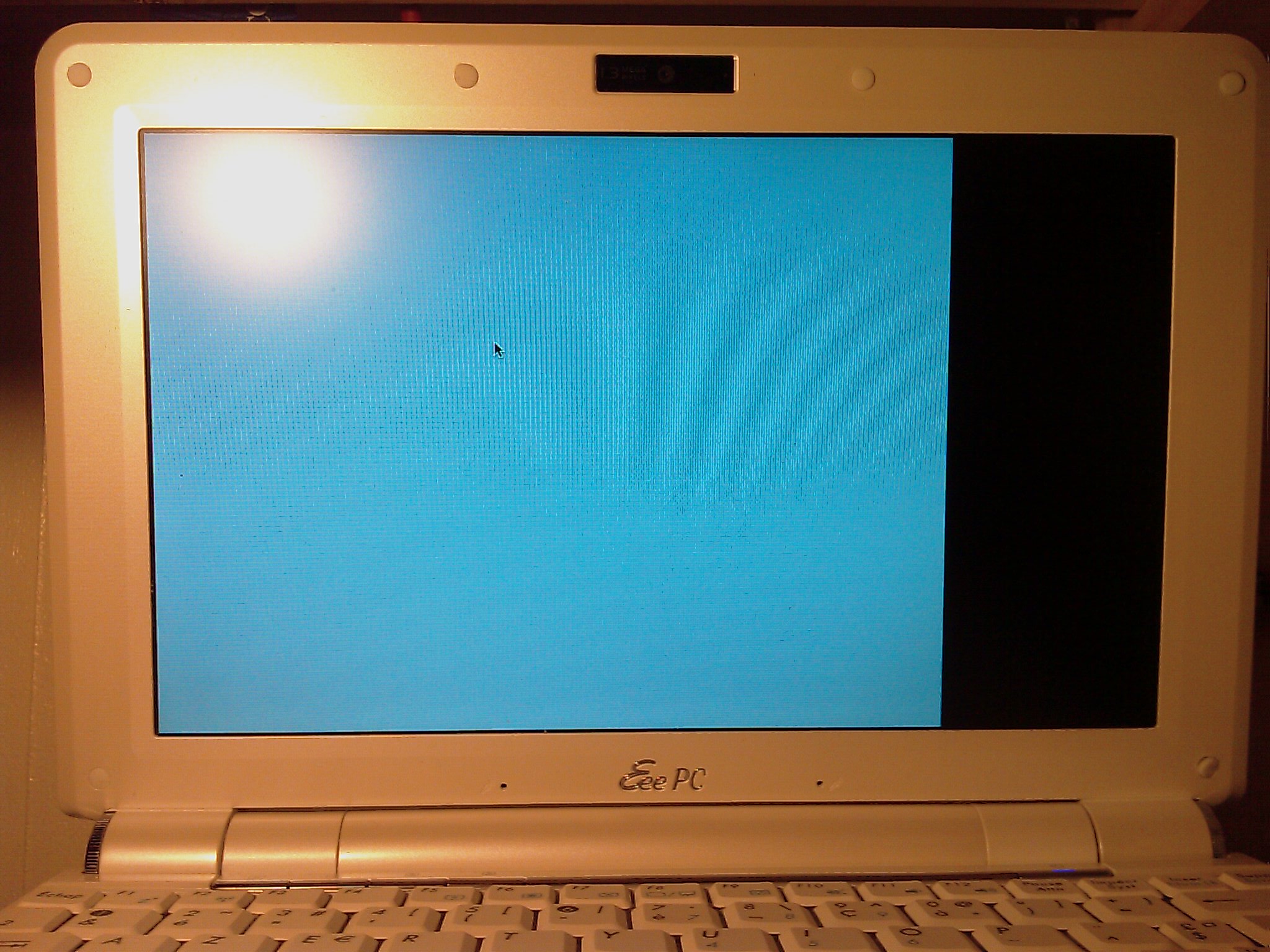

yrebanga Posted August 12, 2009 Share Posted August 12, 2009 I modified AppleIntelGMA950.kext and AppleIntelIntergratedFramebuffer.kext. I do believe that you need to modify Info.plist in the kexts as well. I did and it probably helped. Ohh and the hex is 86 80 A2 27 changed to 86 80 AE 27. Hello and thank you to all for trying to help for this problem. My config. and try : - EEEPC 1000H - 2 GO RAM - iAktos 10.5.7 (new install) -> resolution 800 x 600 -> with files : AppleIntelGMA950.kext + AppleIntelIntegratedFramebuffer.kext found : http://ipis-osx.wikidot.com/forum/t-140358...-10-5-6-cracked -> video driver is better but not good -> with SwitchResX found : http://www.madrau.com/SRX3/html/SRX/About.html -> i could have good resolution 1024 x600 Since i made the Apple update 10.5.8, the video down to 800 x 600 again. I reload kext from ipis-osx.wikidot.com as i did before : i had a kernel panic such this one : So, i made a clean install 0sx 10.5.7 + Apple update 10.5.8 : still 800 x 600. I try other kext : kernel panic ! So, i found your posts and i try to made modifications but i don't think i am doing well. Can you help me please ? In the first post, schnullimaus was talking about "eeeutilities", so i found them and download from : http://eeemac.blogspot.com/2009/03/install...a-901-1000.html -> http://www.pd.net/eeeboot/ I found the files : AppleIntelIntegratedFrameBuffer.kext AppleIntelGMA950.kext I could open the packages and see the files : info.plist version. plist So, why schnullimaus talk about a specify software "HexEditor" if we can open theses files with extEdit.app, search, found, replace 86 80 A2 27 for 86 80 AE 27 ? I only see 86 80 A2 27 to change to 86 80 AE 27 one time in the file : info.plist from AppleIntelGMA950.kext I didn't see 86 80 A2 27 (it was already 86 80 AE 27) in files (with TextEdit.app ot HexEditor) : version.plist from AppleIntelGMA950.kext info.plist and version. plist from AppleIntelIntegratedFrameBuffer.kext So, with only 1 change in 1 file info.plist from AppleIntelGMA950.kext, i try and it still didn't work. At 1st reboot : At 2nd reboot and after : So, cand you help me to tell me what i did wrong or what i didn't anderstood well ? Thank you very much for helping. Link to comment https://www.insanelymac.com/forum/topic/178926-1058-gma950-27ae-for-eeepc-and-others/#findComment-1224342 Share on other sites More sharing options...

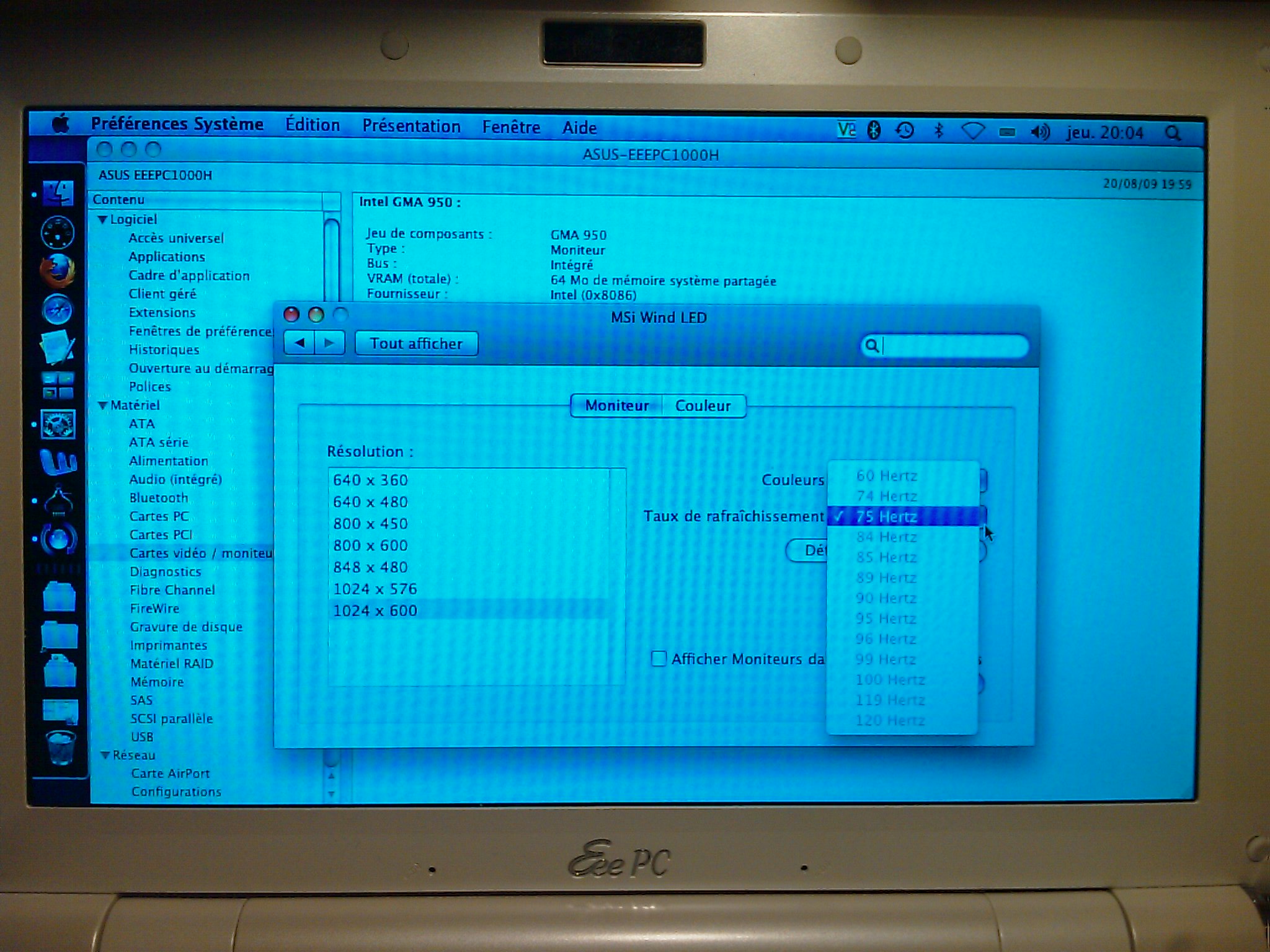

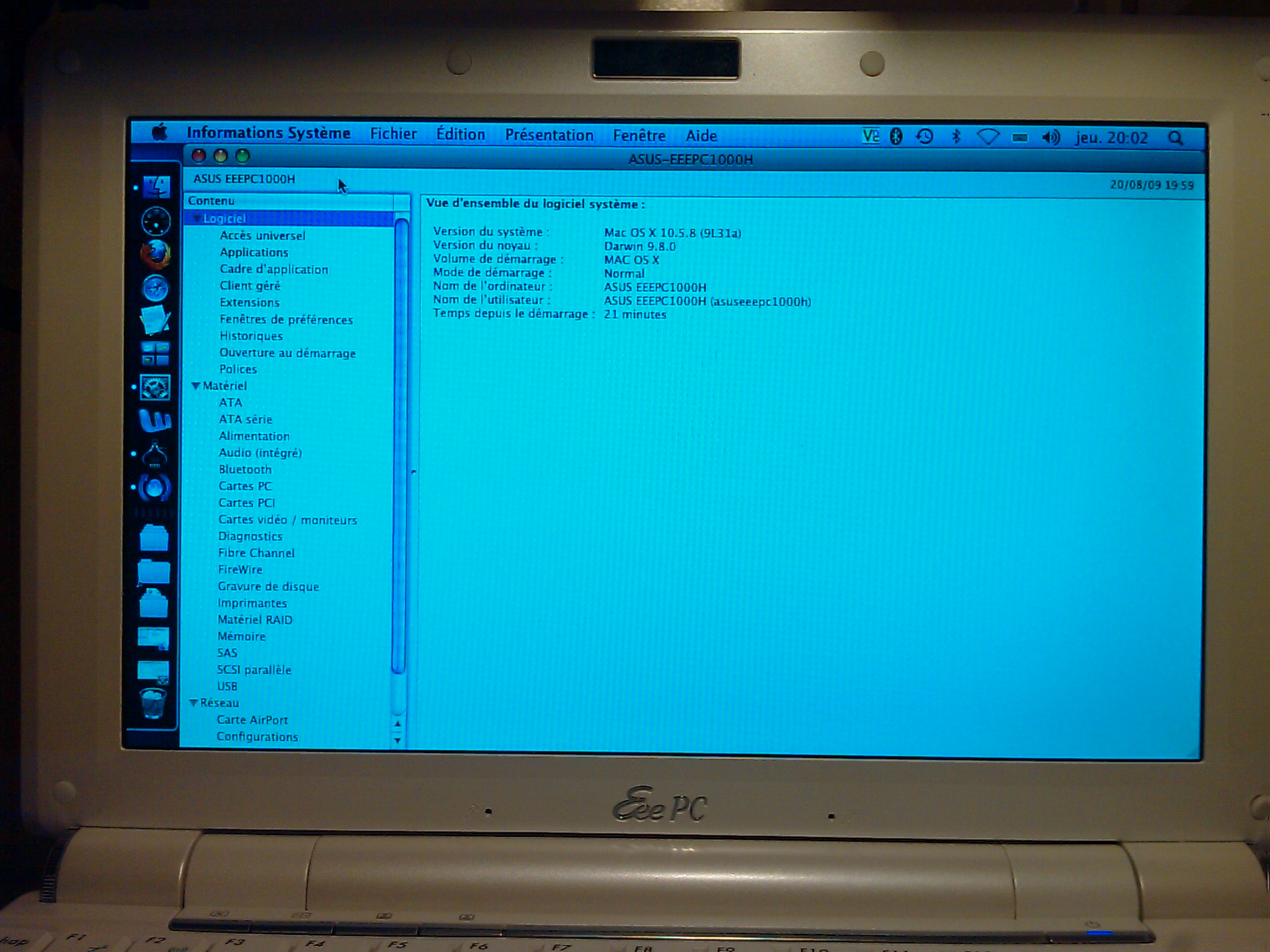

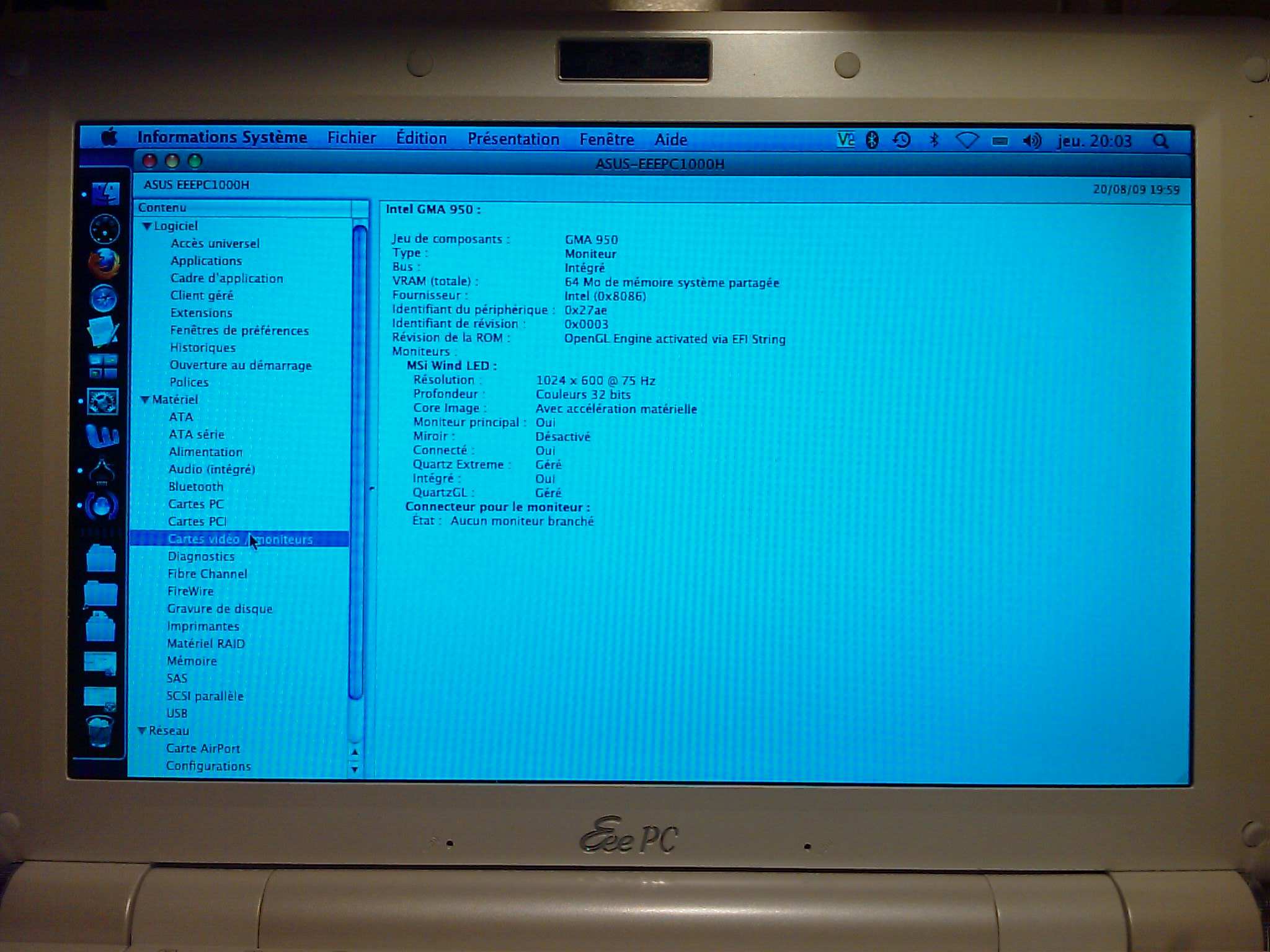

yrebanga Posted August 20, 2009 Share Posted August 20, 2009 Wow... thank you very much Sparc4 for your detailed answer I anderstand now that I was far from all what you did with editing kext ... In a couple of days i will try your solution and see what happens... I wil tell you (for the moment, I reinstall again Iatkos 10.5.7 + Update 10.5.8, I am still in 800x600 but i can manage with that ) Finally, IT WORKS !!!! BUT... i have to say that i didn't use the method described above. I found it in an other website : http://www.osx86install.com/support/39-iat...solutions-.html It is said : ISSUE 02:You got an HP530 laptop or MSI Wind with GMA950 (27AE id) and no driver from DVD gives you QE, CI and VGA monitor output. Solution: Firstly try this: select "GMA 950 Rare" and "GMA 950 Laptop" at the same time, if not working then, Don´t select ANY GMA950 driver and/or EFI string on install. After you arrive to desktop, install this: http://ul.to/0bx92c , then boot again the DVD and install ONLY the EFI string for intel. Thanks to Marcos for testing. They are talking about HP530 and MSI Wind... but my ASUS EEEPC1000H have also an Intel GMA950 27AE. So, i test the method : i download the 2 files (il 1 zip) at http://ul.to/0bx92c installed : WindWSVGADisplay_v5.5.pkg reboot, installed : WindVideo_v5.5.pkg reboot, the system hang on a blue desktop... reboot a 2nd time the system hang on a blue desktop... as described in the method, i reboot with iAtkos V7, try to install only "EFI string for intel"... but the installation failed ! i reboot (was scare to reinstall all )... and then, my desktop arrived in good resolution 1024 x 600 Look : I forgot to tell you that BEFORE installing these drivers, i've installed OSx86 Tools to enable Quartz GL Look at the "MSi Wind LED" inscription on the resolution window : Thank Sparc4 for all your knowledge and help ... and all for supporting to resolve this issue Link to comment https://www.insanelymac.com/forum/topic/178926-1058-gma950-27ae-for-eeepc-and-others/#findComment-1230783 Share on other sites More sharing options...

eoinenator Posted August 27, 2009 Share Posted August 27, 2009 I currently have a 1000HA running OS X 10.5.8 . I too had issues with the resolution stuck at 800x600. I followed the modification to both the AppleIntelIntegratedFrameBuffer.kext , and AppleIntelGMA950.kext, with no success. But when combined with Natit.kext and ClamshellDisplay.kext from the Eee Utilities, l got full hardware support including QE/CI running at 1024 x 600. Big thanks to Sparc4 for the information he has provided. And l hope this info helps others. Hi I'm stuck on 10.5.8 with 800x600 on a 1005HA and I can't find the hex values in the kexts so could you please post your kexts that work? Thanks alot eoinenator Link to comment https://www.insanelymac.com/forum/topic/178926-1058-gma950-27ae-for-eeepc-and-others/#findComment-1237670 Share on other sites More sharing options...
tuanhoangvn Posted September 9, 2009 Share Posted September 9, 2009 Finally, IT WORKS !!!! BUT... i have to say that i didn't use the method described above. I found it in an other website : http://www.osx86install.com/support/39-iat...solutions-.html It is said : They are talking about HP530 and MSI Wind... but my ASUS EEEPC1000H have also an Intel GMA950 27AE. So, i test the method : i download the 2 files (il 1 zip) at http://ul.to/0bx92c installed : WindWSVGADisplay_v5.5.pkg reboot, installed : WindVideo_v5.5.pkg reboot, the system hang on a blue desktop... reboot a 2nd time the system hang on a blue desktop... as described in the method, i reboot with iAtkos V7, try to install only "EFI string for intel"... but the installation failed ! i reboot (was scare to reinstall all )... and then, my desktop arrived in good resolution 1024 x 600 Look : I forgot to tell you that BEFORE installing these drivers, i've installed OSx86 Tools to enable Quartz GL Look at the "MSi Wind LED" inscription on the resolution window : Thank Sparc4 for all your knowledge and help ... and all for supporting to resolve this issue I cant download at http://ul.to/0bx92c you cant upload from RS or MF ? I used lap HP 520 GMA 950 0x8086 27AE ThanK Link to comment https://www.insanelymac.com/forum/topic/178926-1058-gma950-27ae-for-eeepc-and-others/#findComment-1258420 Share on other sites More sharing options...

yrebanga Posted September 9, 2009 Share Posted September 9, 2009 I cant download at http://ul.to/0bx92cyou cant upload from RS or MF ? I used lap HP 520 GMA 950 0x8086 27AE ThanK You can find the file : Intelgma950-29AE-HP530-WInd.zip That you can find at the link : http://ul.to/0bx92c At this new link : http://rapidshare.com/files/277788390/Inte...0-WInd.zip.html(MD5: 53E87A6498F11DF3707F089BD6685D19) Unfortunately, RapideShare wrote : Your file has been saved and can now be downloaded 10 times. It will be deleted after 90 days without download. If you would like to enable more people to download your file, please transfer it to a free Collector's Account or a Premium Account. So, I hope that you will be able to download it before the 10 times downloads. If you arrive too late to download it, tell me and I will updload it an other time. Link to comment https://www.insanelymac.com/forum/topic/178926-1058-gma950-27ae-for-eeepc-and-others/#findComment-1259028 Share on other sites More sharing options...
