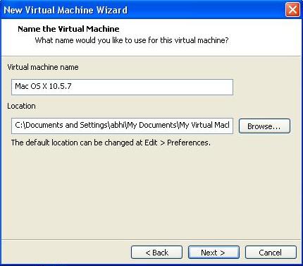

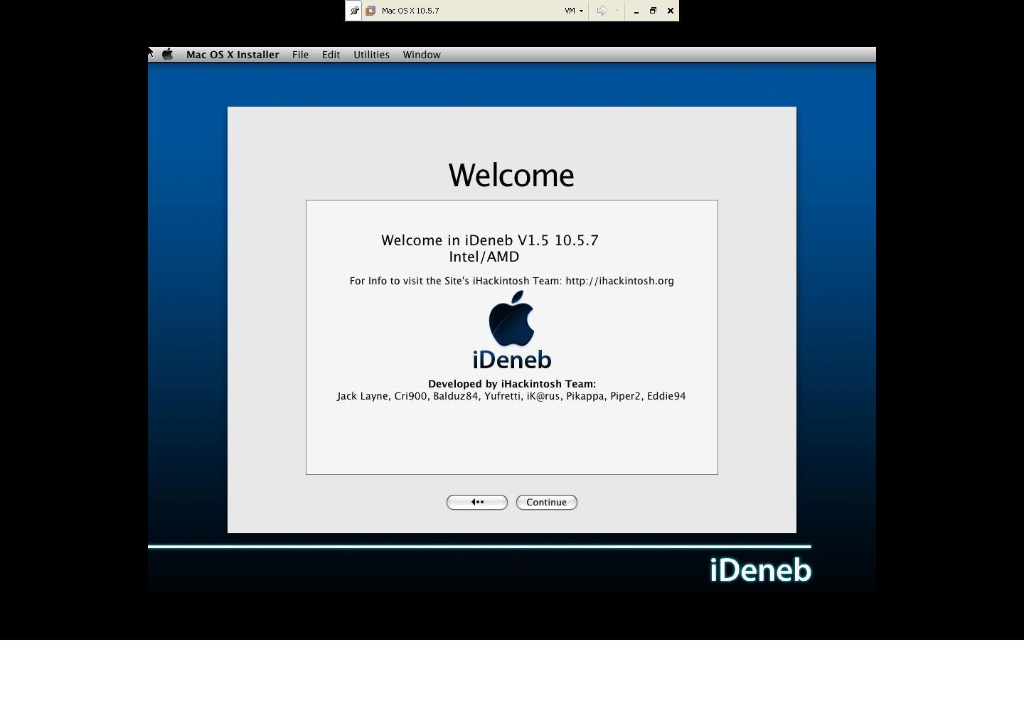

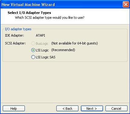

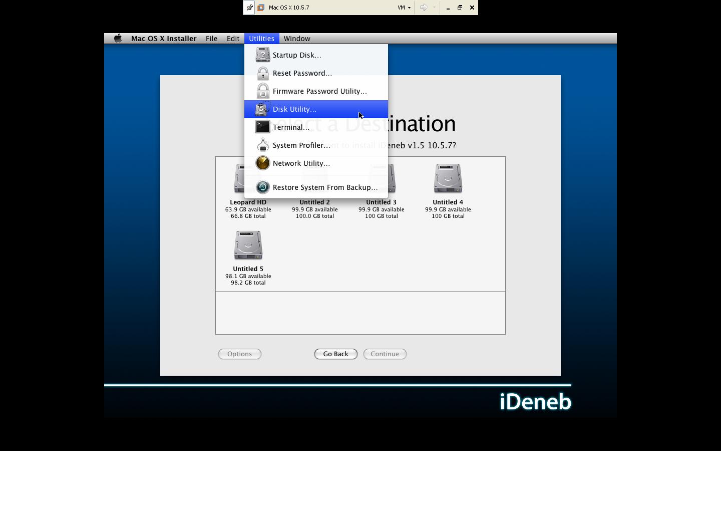

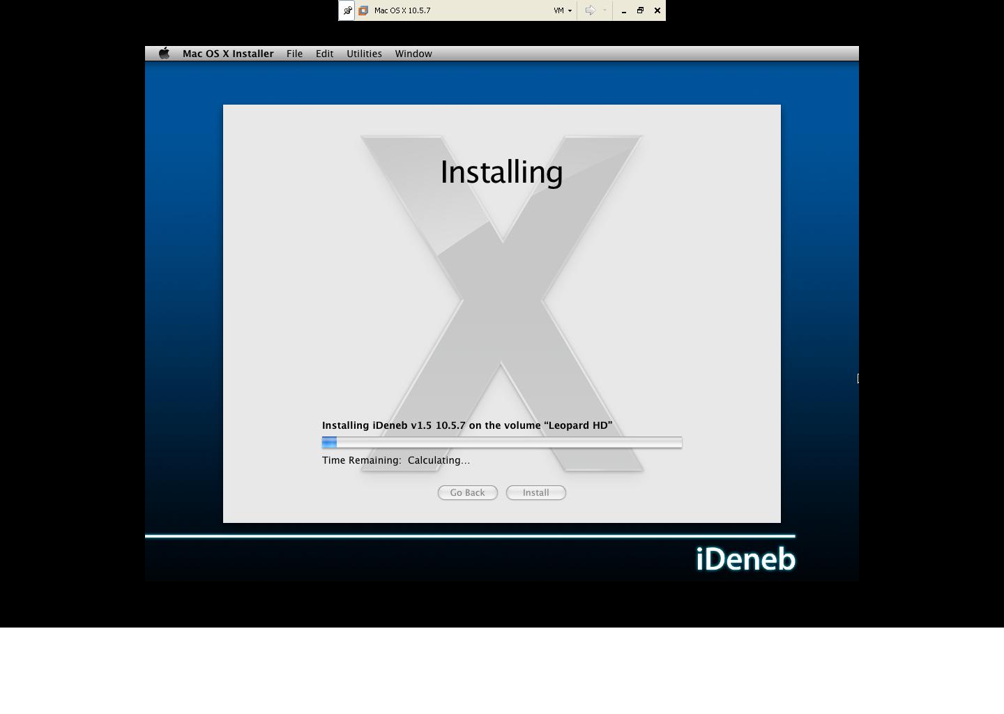

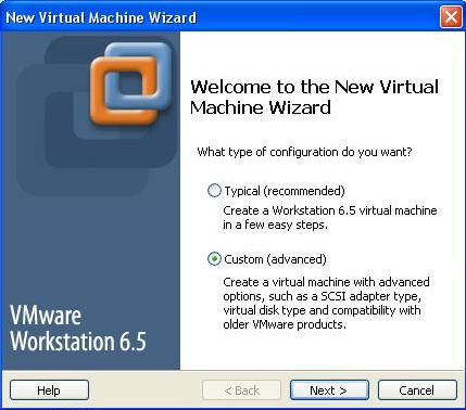

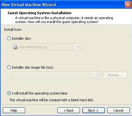

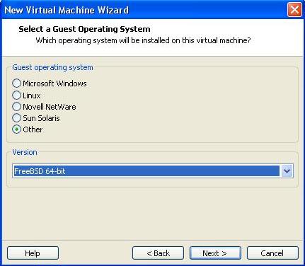

abhilash Posted July 27, 2009 Share Posted July 27, 2009 iDeneb 10.5.7 installation on vmware and natively. This installation procedure resolves the problem "still waiting for root device" and kernel panics for nforce motherboards or any other motherboard. The following tutorial shows the installation of iDeneb 10.5.7 on vmware workstation 6.5.1 and run natively. NOTE: This installation is done on XFX 680i LT SLI Motherboard with Intel core2 duo E6750 2.66 Ghz processor. BIOS settings for nforce motherboards. 1.) Enable APIC Mode. 2.) Disable C1E Enhanced Halt state. 3.) Disable Limit CPUID MaxVal. 4.) Disable Intel SpeedStep. 5.) Disable CPU Thermal Control. The following images will guide you upto the end of installation. step 1: Open vmware workstation and click New Virtual Machine. If you want to run natively then select an physical hard disk otherwise create a new virtual disk. Browse the ISO file of iDeneb 10.5.7. click ok and exit vmware. Goto My Virtual Machines and find your virtual machines configuration files folder and open the .vmx file with wordpad and do the following changes. guestos = "darwin" and add the line paevm = "TRUE" and save the file. Now double click the vmx file and start the virtual machine. press F8 when the it prompts and type -v and press enter. Select the packages which your host support if you want to run natively. Otherwise dont select any package if you want to run on vmware. Grab a cup of coffee until the installation is finished. If you want to run natively stop the virtual machine after reboot and restart your host machine and boot from the physical disk in which you have done your installation. Have fun !!!!!!!! Link to comment Share on other sites More sharing options...

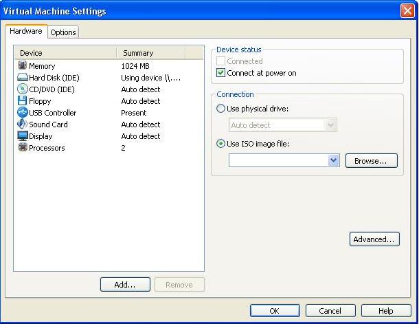

john steel Posted July 29, 2009 Share Posted July 29, 2009 Hi..Abhilash. Having some problem here...When I try to start virtual machine it shown nothing the whole screen goes blank. When I try to close it after some time like 15minutes then also it says that VM Mac...10.5.7...is busy. And where you said (Browse the ISO file of iDeneb 10.5.7.) there its hard to understand where to browse so I try cd dvd rom there is a option for ISO file. Is there any thing wrong...there should I have to do some thing els I try to follow every thing as you said and my mobo is 680i sli XFX. Link to comment Share on other sites More sharing options...

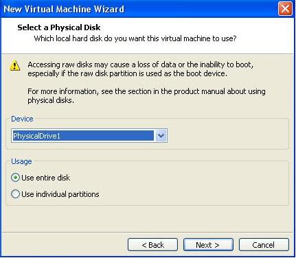

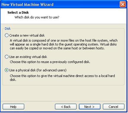

john steel Posted July 30, 2009 Share Posted July 30, 2009 Hi Abhilash...Images are again start working..Thanks.. In "select a physical Disk" my pc is showing Physicaldrive0 whether in your pc it shows Physicaldrive1 is that the problem???? thanks Link to comment Share on other sites More sharing options...

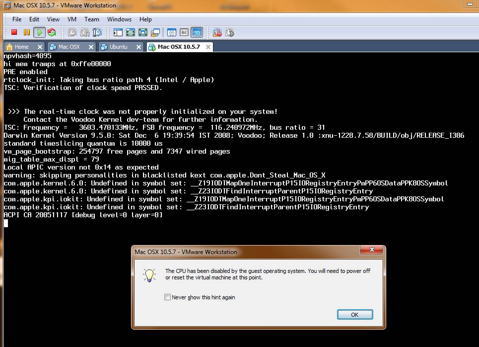

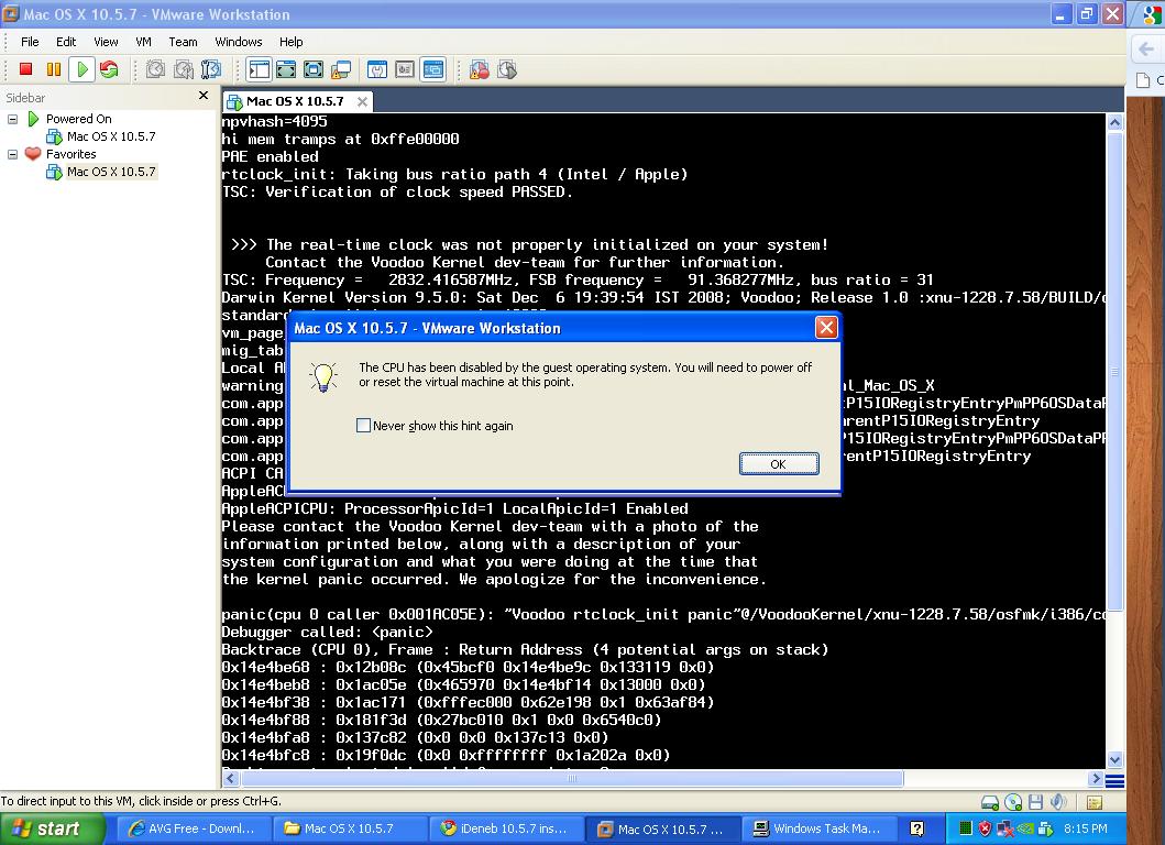

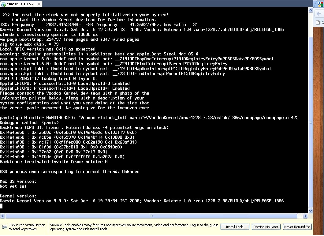

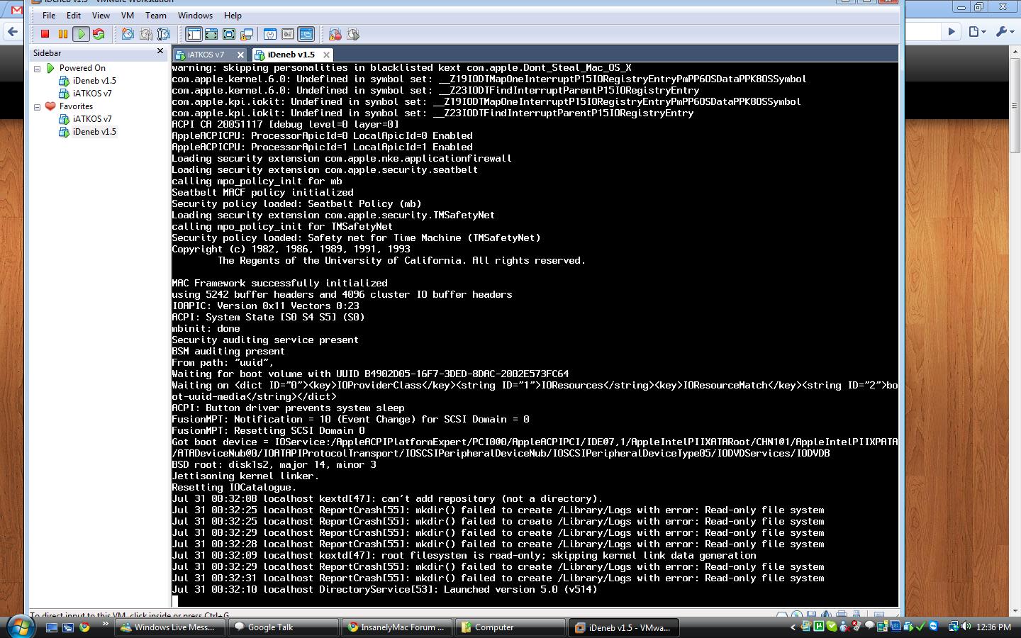

phantom8 Posted July 30, 2009 Share Posted July 30, 2009 I've followed your instructions, but it didn't work. I got a ACPI error and the CPU is disabled. I'm using Vmware Workstaion for Windows ver 6.5.2 build-156735. Can you let me know which version you have? Here is the screen capture of the error message. Link to comment Share on other sites More sharing options...
abhilash Posted July 30, 2009 Author Share Posted July 30, 2009 Hi Abhilash...Images are again start working..Thanks..In "select a physical Disk" my pc is showing Physicaldrive0 whether in your pc it shows Physicaldrive1 is that the problem???? thanks Hi john steel.. I have two disks one with xp installed and other one is empty.. In this case i am installing on physical drive 1 which is empty. Remember that if you i have only one disk and want to install it on a partition then select that partition in vmware, not the whole disk.. Hi..Abhilash. Having some problem here...When I try to start virtual machine it shown nothing the whole screen goes blank. When I try to close it after some time like 15minutes then also it says that VM Mac...10.5.7...is busy. And where you said (Browse the ISO file of iDeneb 10.5.7.) there its hard to understand where to browse so I try cd dvd rom there is a option for ISO file. Is there any thing wrong...there should I have to do some thing els I try to follow every thing as you said and my mobo is 680i sli XFX. If you have the ISO file of iDeneb 10.5.7 then click browse and goto that file and select it.. I've followed your instructions, but it didn't work. I got a ACPI error and the CPU is disabled. I'm using Vmware Workstaion for Windows ver 6.5.2 build-156735. Can you let me know which version you have? Here is the screen capture of the error message. Hi... can you mention your system configuration.. Does your board support ACPI Management.. If you provide the details i will help you.. I can't open the images larger. images are working fine and they are larger.. Link to comment Share on other sites More sharing options...
john steel Posted July 30, 2009 Share Posted July 30, 2009 Hi abhilash...ya I have Ideneb 10.5.7 and Actually I did browse to it but I don't know why its not showing any thing "blank". bye...I am clueless... Link to comment Share on other sites More sharing options...
abhilash Posted July 30, 2009 Author Share Posted July 30, 2009 Hi abhilash...ya I have Ideneb 10.5.7 and Actually I did browse to it but I don't know why its not showing any thing "blank".bye...I am clueless... check whether you have selected boot from cd in vmware.... if it is correct then mount your iso using daemon tools and check the files whether they are present or not... Link to comment Share on other sites More sharing options...

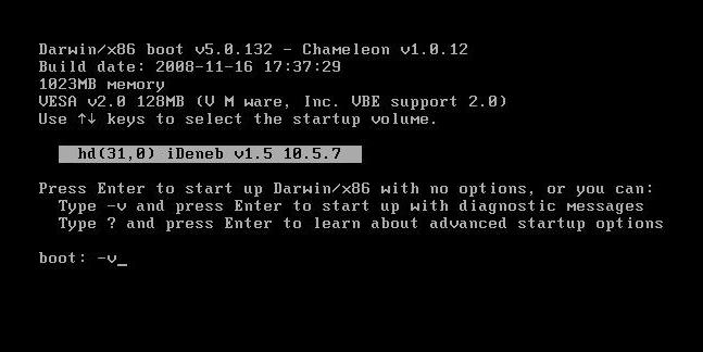

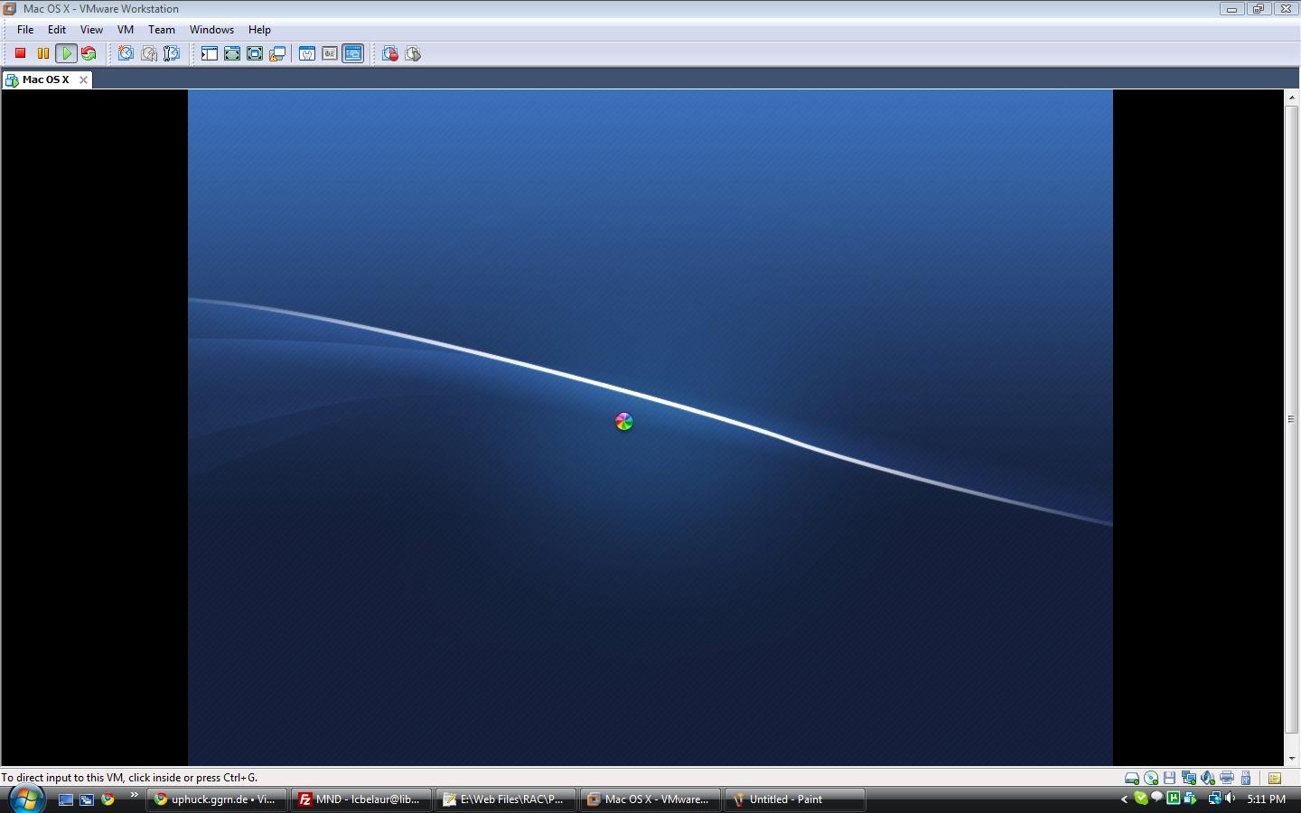

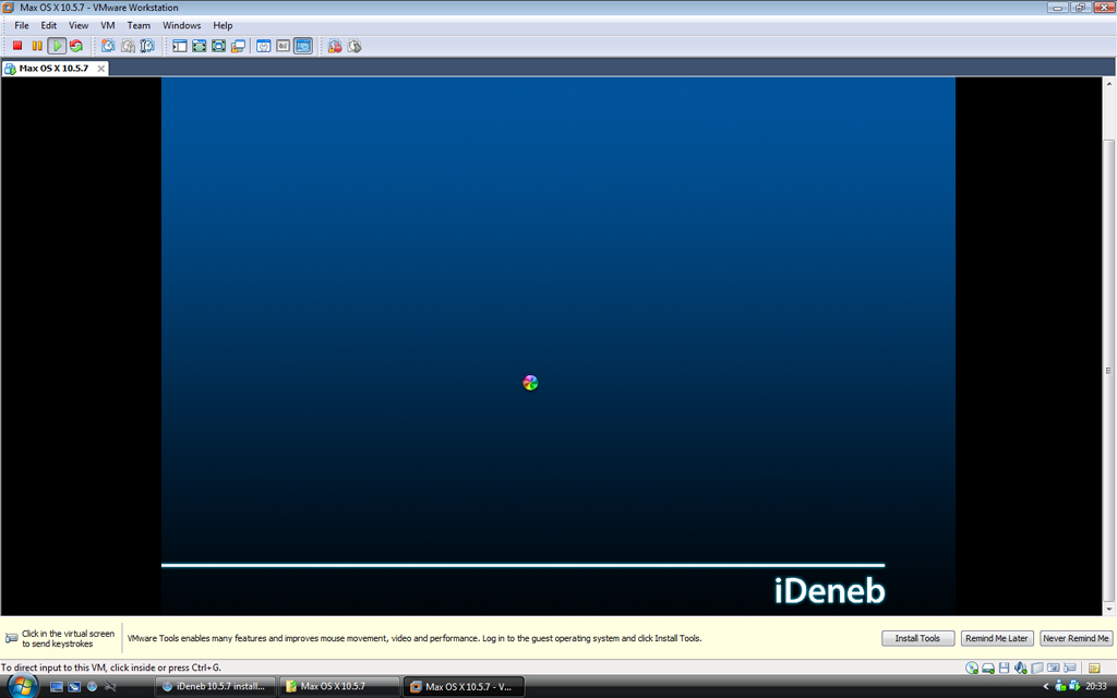

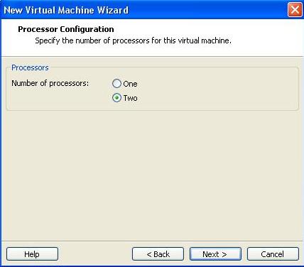

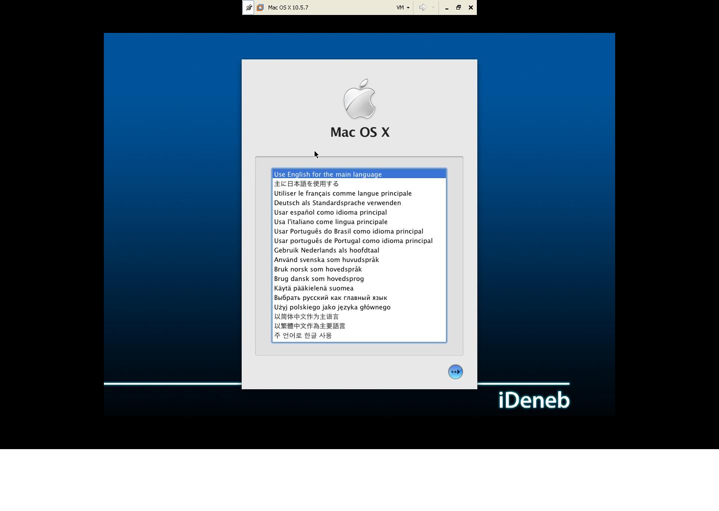

extreme.aly Posted July 30, 2009 Share Posted July 30, 2009 I'm installing it on an VM hdd IDE (15gb) I got everything correct till booting.. but i used this command: busratio=20 -v because without it, it was restarting again and again... after that, it shows me iDeneb background and shows me a loading animated cursor (pinwheel) but doesn't show me the language selecting dialogue... it is just loading and loading something.. i don't know whether its doing something or not... please tell me what to do? My Specs: Pentium 4 HT 3.06Ghz (i selected 1 number of processors instead of 2) Motherboard: P5B-MX (wifi) 2GB RAM Link to comment Share on other sites More sharing options...
abhilash Posted July 30, 2009 Author Share Posted July 30, 2009 I'm installing it on an VM hdd IDE (15gb)I got everything correct till booting.. but i used this command: busratio=20 -v because without it, it was restarting again and again... after that, it shows me iDeneb background and shows me a loading animated cursor (pinwheel) but doesn't show me the language selecting dialogue... it is just loading and loading something.. i don't know whether its doing something or not... please tell me what to do? My Specs: Pentium 4 HT 3.06Ghz (i selected 1 number of processors instead of 2) Motherboard: P5B-MX (wifi) 2GB RAM Why did you select 1 if you have 2 cores..??? no need to use busratio=20 all that.. please carefully follow the tutorial .. you will be error free.. Link to comment Share on other sites More sharing options...
Spoor Posted July 30, 2009 Share Posted July 30, 2009 just stayed on this screen for about 10 minutes tried resettings but just sits there Link to comment Share on other sites More sharing options...
extreme.aly Posted July 31, 2009 Share Posted July 31, 2009 Why did you select 1 if you have 2 cores..??? no need to use busratio=20 all that.. please carefully follow the tutorial .. you will be error free.. without busratio=20 it simply restarts just after i enter the command.. and i think pentium 4 has only 1 core... any way, i selected 2 with busratio=20, it showed me this screen (errors attached) Link to comment Share on other sites More sharing options...
abhilash Posted July 31, 2009 Author Share Posted July 31, 2009 without busratio=20 it simply restarts just after i enter the command..and i think pentium 4 has only 1 core... any way, i selected 2 with busratio=20, it showed me this screen (errors attached) If you have only one core why did you select two.. use one and try.. Link to comment Share on other sites More sharing options...

GeleiaHP Posted August 1, 2009 Share Posted August 1, 2009 What is your vmware version Spoor? I have the same problem! My vmware version is 6.5.2 build 156735 - Blue screen with loading animated cursor.... My spec: Intel Celeron M 1.5Ghz 1Gb RAM Intel 915GM Thanks! Link to comment Share on other sites More sharing options...
Spoor Posted August 1, 2009 Share Posted August 1, 2009 What is your vmware version Spoor? I have the same problem!My vmware version is 6.5.2 build 156735 - Blue screen with loading animated cursor.... My spec: Intel Celeron M 1.5Ghz 1Gb RAM Intel 915GM Thanks! I have 6.5.1 as what was said in the main topic which works. Link to comment Share on other sites More sharing options...

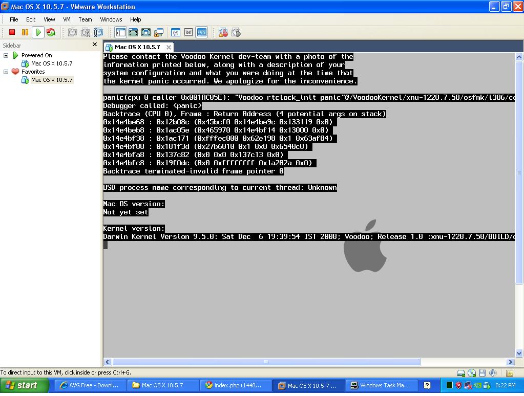

john steel Posted August 1, 2009 Share Posted August 1, 2009 Ya..so I have reinstalled my OS and now I can boot to my Ideneb iso...but now I am getting panic erro.. Can it be solve.. Link to comment Share on other sites More sharing options...
abhilash Posted August 1, 2009 Author Share Posted August 1, 2009 What is your vmware version Spoor? I have the same problem!My vmware version is 6.5.2 build 156735 - Blue screen with loading animated cursor.... My spec: Intel Celeron M 1.5Ghz 1Gb RAM Intel 915GM Thanks! Did you check the processor instructions whether your processor is SSE3 and EM64T supported.. Link to comment Share on other sites More sharing options...

extreme.aly Posted August 1, 2009 Share Posted August 1, 2009 I've followed your instructions, but it didn't work. I got a ACPI error and the CPU is disabled. I'm using Vmware Workstaion for Windows ver 6.5.2 build-156735. Can you let me know which version you have? Here is the screen capture of the error message. try using this command: busratio=20 -v i also had the same problem... If you have only one core why did you select two.. use one and try.. i said even if i select 1 core, it passes the booting problem and shows me this screen (attached) and its not doing anything else...just the cursor is animating... Link to comment Share on other sites More sharing options...
