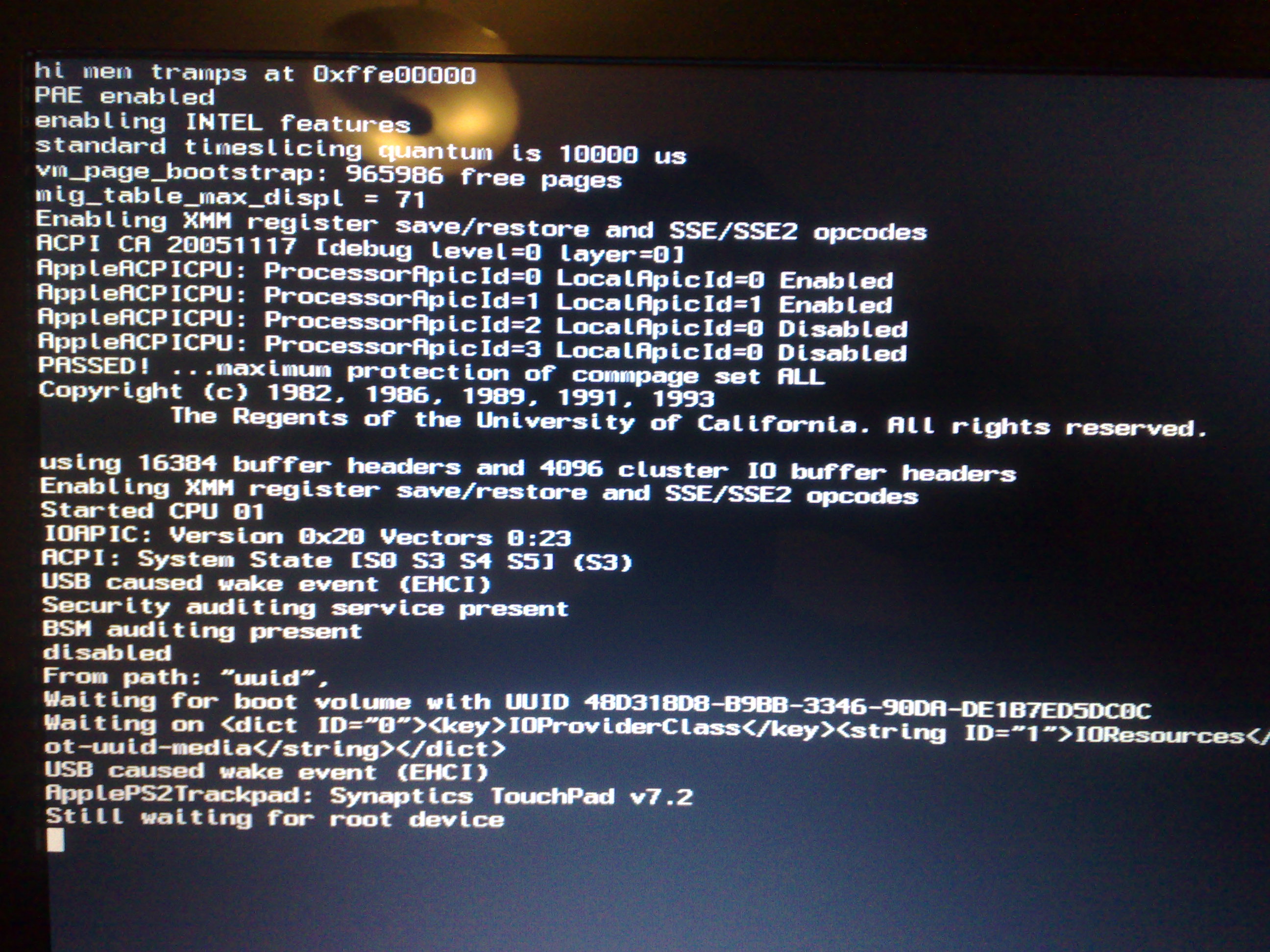

elfineer Posted July 2, 2009 Share Posted July 2, 2009 Hi, can someone please tell me if it is possible to install Mac OS X on HP ProBook 4510s? During the installation I have got the message "Still waiting for root device", but also when I set in BIOS SATA: IDE, it does not work. Screenshot of my problem: http://tinyurl.com/nbenhm Specification of ntb: http://tinyurl.com/mtmqfs Thanks! Link to comment Share on other sites More sharing options...

theo58 Posted October 3, 2009 Share Posted October 3, 2009 Any news? Yep..... I installed 10.5.6 on a external HD and could boot from it ! I did not make any changes in the bios and I used IPC 10.5.6 for installation. Not working yet : Sound, Lan, Wlan, Working: SD cardreader Custom setup: IPC osx86 10.5.6 base system KERNELS: no kernel selected DRIVERS: Legacy Time Mahine Fix, just selected this and I do not know if it is needed CHIPSET: Intel ICHx Sata drivers USB DRIVERS: Patched USB Drivers, just selected this and I do not know if it is needed POWER MANAGEMENT: AppleACIBatteryManager PS/2 SUPPORT: PS/2 Keyboard Fix, had to install later.Luckily I had a USB keyboard to go on with the setup APPLICATIONS: Kext Helper b7 This first run shows that it is possible to run 10.5.6 on the probook. I need to fine tune now and see if there any drivers for sound, lan, wlan and video Suggestions are always welcom Link to comment Share on other sites More sharing options...

theo58 Posted October 18, 2009 Share Posted October 18, 2009 Have u gotten any further? It was possible for me to get the OS running but no lan what so ever... and i can only run in 1024x768.. HELP!? =) I cannot boot anymore from my external HD HELP I installed osx on another HD and got the same result cannot boot anymore from USB. I did test with a bootable USB stick and could boot....... Something wrong in the BIOS ? I did install easybcd and can now boot from the external HD and can play with the system. You can change the resolution by adding two lines in the /Library/Preferences/SystemConfiguration/com.apple.Boot.plist add: <key>Graphics Mode</key> <string>1366x768x32</string> Now you have 1366 by 768 resolution, google for change resolution osx86. Link to comment Share on other sites More sharing options...
theo58 Posted October 21, 2009 Share Posted October 21, 2009 I cannot boot anymore from my external HD HELPI installed osx on another HD and got the same result cannot boot anymore from USB. I did test with a bootable USB stick and could boot....... Something wrong in the BIOS ? I did install easybcd and can now boot from the external HD and can play with the system. You can change the resolution by adding two lines in the /Library/Preferences/SystemConfiguration/com.apple.Boot.plist add: <key>Graphics Mode</key> <string>1366x768x32</string> Now you have 1366 by 768 resolution, google for change resolution osx86. Found out why I cannot boot anymore from the external HD from system bootmenu: Bootloader.....I installed the bootloader from x86tools on the external HD and can boot from the HD. After some playing, erasing-partioning the HD this isssue occurred. I can continue testing Link to comment Share on other sites More sharing options...
theo58 Posted October 21, 2009 Share Posted October 21, 2009 Found out why I cannot boot anymore from the external HD from system bootmenu:Bootloader.....I installed the bootloader from x86tools on the external HD and can boot from the HD. After some playing, erasing-partioning the HD this isssue occurred. I can continue testing Sound is working. You need to install HDAEnabler.kext and VoodooHDA.kext You can find both here: http://www.osx86.nl/dload/audio/index.html have fun Link to comment Share on other sites More sharing options...
