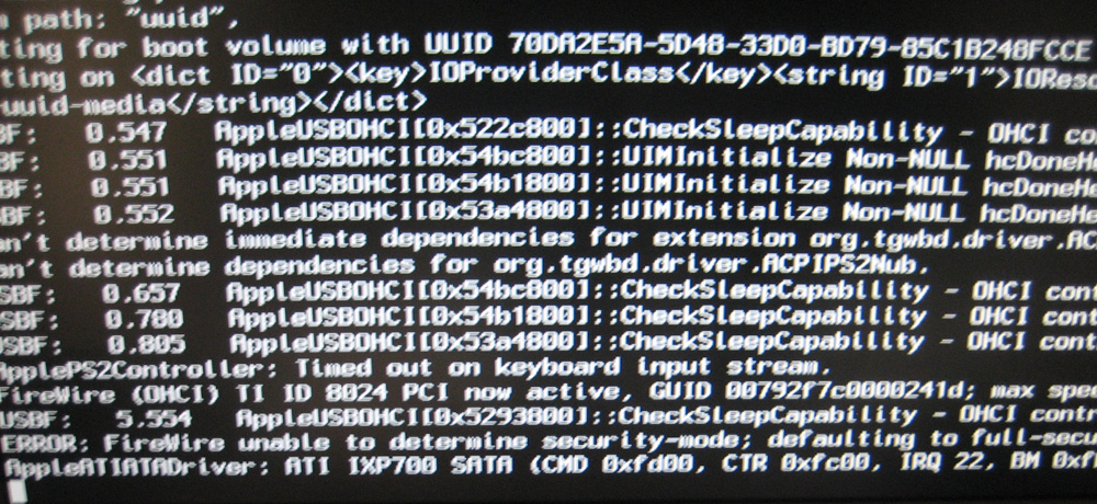

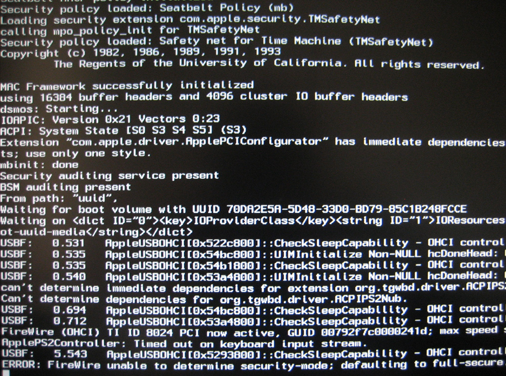

hk93 Posted June 19, 2009 Share Posted June 19, 2009 I lost a lot of time trying to install MacOS on that motherboard. Well i finally succeded. I used the iDeneb v1.4 distro. What i done to get leopard install and work: - Disabled the IDE controller - Disabled the GSATA controller - Set the SB7xx's SATAs ports to AHCI - attached a SATA hd to the first SATA port (the number one, blue) - THAT's REALLY IMPORTANT: OTHERWISE YOU WILL GET STILL WAITING FOR ROOT DEVICE AFTER SETUP - used an external dvd to install leo Well with that mods, i finally get into leo's installer. Before, i got always "still waiting for root device" In the installer, i selected: - Voodoo kernel, seatbelt fix, sb7xx chipset driver, R1000 lan driver. Well, then install leo. After, at first startup you will get a kernel panic...DAMN!!! why? simple. the kernel reads wrong FSB and molti settings from the mobo. how to fix? again simple. Press F8 on startup then write "fsb=200000000 fsbratio=175" (if your molti is 17.5...if not just change the value). If you don't want to type at each boot this values, just add them in your boot file. And...what? leo will magically boot... I hope that will help anyone. Link to comment https://www.insanelymac.com/forum/topic/171524-how-install-macosx-on-ga-ma790xt-ud4p/ Share on other sites More sharing options...
mGreenie Posted June 19, 2009 Share Posted June 19, 2009 Can I ask you ? "attached a SATA hd to the first SATA port (the number one, blue) - THAT's REALLY IMPORTANT: OTHERWISE YOU WILL GET STILL WAITING FOR ROOT DEVICE AFTER SETUP" This you did in bios or in PC ? if Bios, where ? - Greenie Link to comment https://www.insanelymac.com/forum/topic/171524-how-install-macosx-on-ga-ma790xt-ud4p/#findComment-1181768 Share on other sites More sharing options...
hk93 Posted June 19, 2009 Author Share Posted June 19, 2009 on the mobo. you can see six blue colored sata ports on the right. you need to connect the hd to the first one (the one with number 1). oh well the only problem i have so far is with the audio laggy...has anyone got how to fix that issue? Link to comment https://www.insanelymac.com/forum/topic/171524-how-install-macosx-on-ga-ma790xt-ud4p/#findComment-1181774 Share on other sites More sharing options...
mGreenie Posted June 19, 2009 Share Posted June 19, 2009 Hey, I opened the case and I don't understand to it so I thought Im doing it correctly. Look CLICK HERE The red cabel in HD and yellow cable in DVD (I guess both are SATA) I switched (There are connected in the yellow thing) but when I tried it, it didnt work. so ? Link to comment https://www.insanelymac.com/forum/topic/171524-how-install-macosx-on-ga-ma790xt-ud4p/#findComment-1181791 Share on other sites More sharing options...
hk93 Posted June 19, 2009 Author Share Posted June 19, 2009 are you sure you have my mobo? these settings are specific for ga-ma790xt or similar... Link to comment https://www.insanelymac.com/forum/topic/171524-how-install-macosx-on-ga-ma790xt-ud4p/#findComment-1181813 Share on other sites More sharing options...

SabbatoR Posted February 28, 2010 Share Posted February 28, 2010 I used the iDeneb v1.4 distro.What i done to get leopard install and work: - Disabled the IDE controller - Disabled the GSATA controller - Set the SB7xx's SATAs ports to AHCI - attached a SATA hd to the first SATA port (the number one, blue) - THAT's REALLY IMPORTANT: OTHERWISE YOU WILL GET STILL WAITING FOR ROOT DEVICE AFTER SETUP - used an external dvd to install leo Well with that mods, i finally get into leo's installer. Before, i got always "still waiting for root device" Ok, I should have tried before posting :x I can't install leo with ideneb 1.4, I still have 'still waiting for root device' ... I didn't even think about before, but: how do I boot on my (IDE) DVD if I disable IDE controller ? So, I tried with IDE enabled (and GSATA disabled), my only HDD is plugged to the first SATA port. I put OnBoard SATA Type to AHCI instead of native IDE. (Even if I change anything => "still waiting for root device" ...) Here some photos of what I get: IDE : enabled OnBoard SATA Type : AHCI GSATA: disabled IDE : enabled OnBoard SATA Type : IDE GSATA: disabled Please help me :'( Thanks Link to comment https://www.insanelymac.com/forum/topic/171524-how-install-macosx-on-ga-ma790xt-ud4p/#findComment-1419851 Share on other sites More sharing options...

NµLL Posted February 28, 2010 Share Posted February 28, 2010 Ok, I should have tried before posting :xI can't install leo with ideneb 1.4, I still have 'still waiting for root device' ... I didn't even think about before, but: how do I boot on my (IDE) DVD if I disable IDE controller ? So, I tried with IDE enabled (and GSATA disabled), my only HDD is plugged to the first SATA port. I put OnBoard SATA Type to AHCI instead of native IDE. (Even if I change anything => "still waiting for root device" ...) Here some photos of what I get: Please help me :'( Thanks Read my post above. I did not disable IDE since I booted from the Kakewalk CD. then from the kakewalk cd i booted in to an 8 gig USB with the iDeneb 1.4 image restored on it (using another mac's disk utility). This was the only way I could get it to boot properly. My hardware: Processor: AMD Phenom II x3 720 @ 3.4GHz Graphics: HD 4870 (1GB) (Albatron with custom double-cooler) Memory: 4 GB Mushkin (2x2) @ 800MHz Motherboard: ECS GF8200A (Onboard Sound) Hard Drive: Western 640GB & 750GB (Sata 2) Monitor: Samsung 206BW Syncmaster (1680x1050) Keyboard: Microsoft Natural Elite 4000 Whoever helps me to install iAtkos v7 on this Computer with all features working (Graphics, Sound and Internet) without random crashes and Kernel Panic at every sleep will get an original Call of Duty 2 CD-Key or 10e via Paypal. The work will be done via Msn or iChat (got leopard via VMware). Well, where do you live? Bring that sucker over. I`ve GigaByte-Extreme and trying to install 10.5.8 always before booting the computer restarts ., do you know whats wrong with me i7 6GB DDR3 4890 ATI Here's a link to the Kakewalk CD. be sure to donate if it works (I did): http://puru.se/ Link to comment https://www.insanelymac.com/forum/topic/171524-how-install-macosx-on-ga-ma790xt-ud4p/#findComment-1419971 Share on other sites More sharing options...
