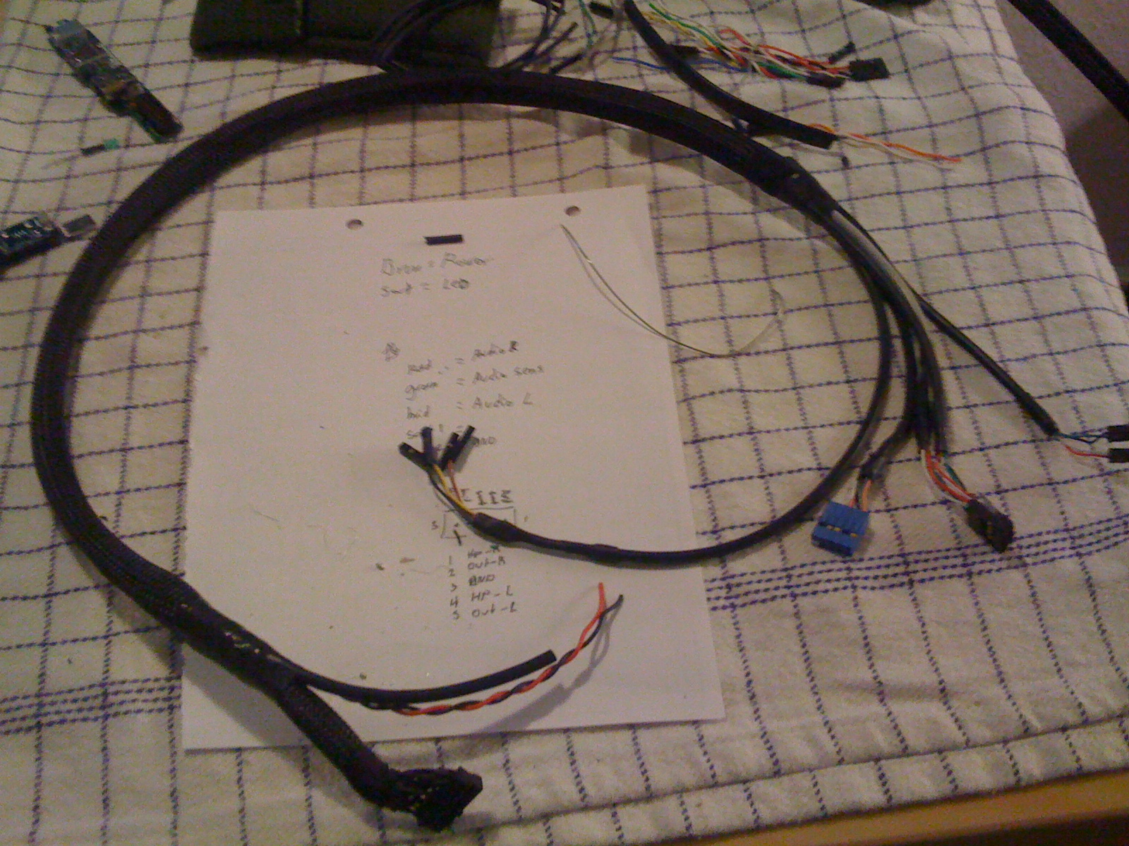

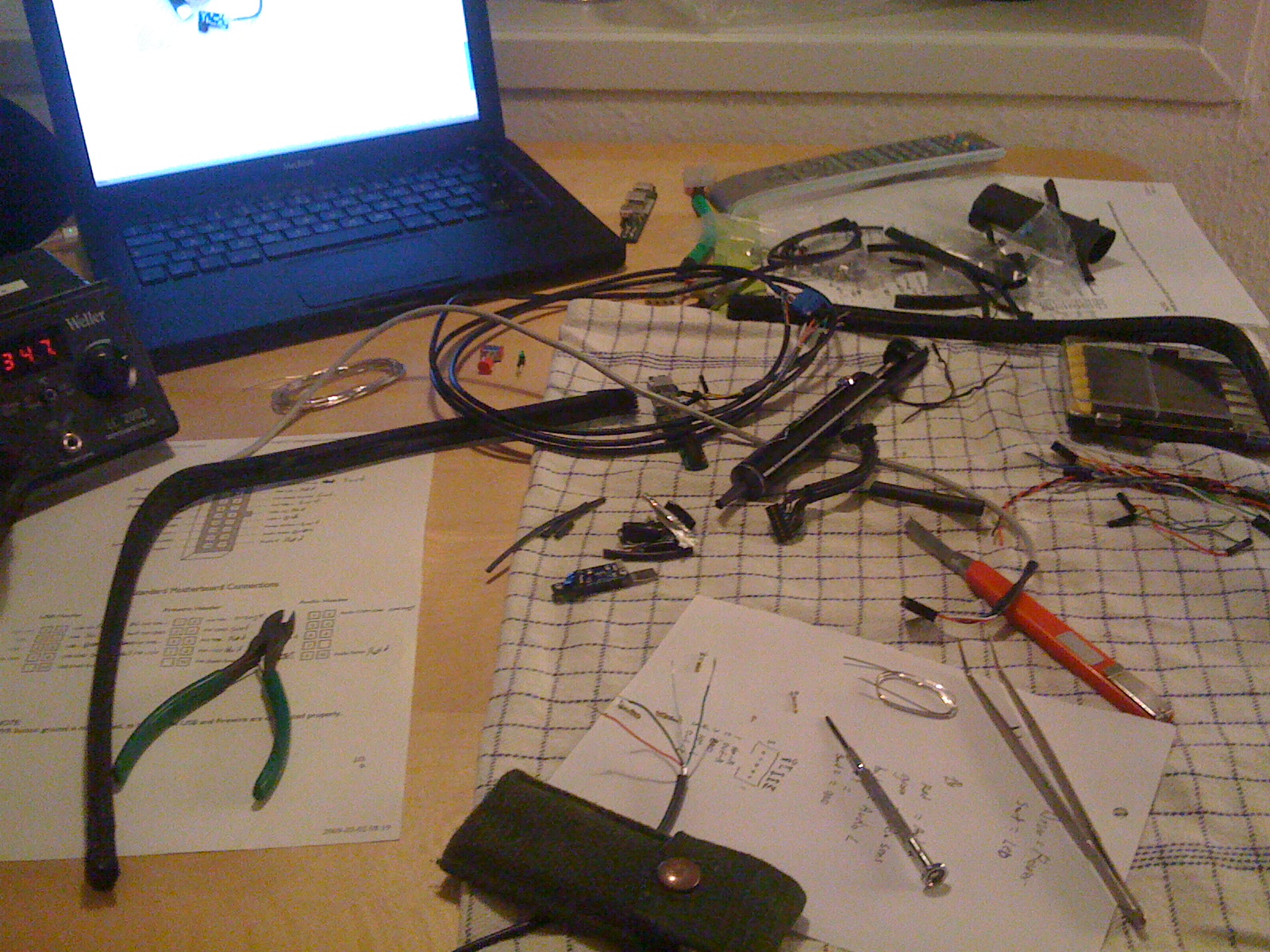

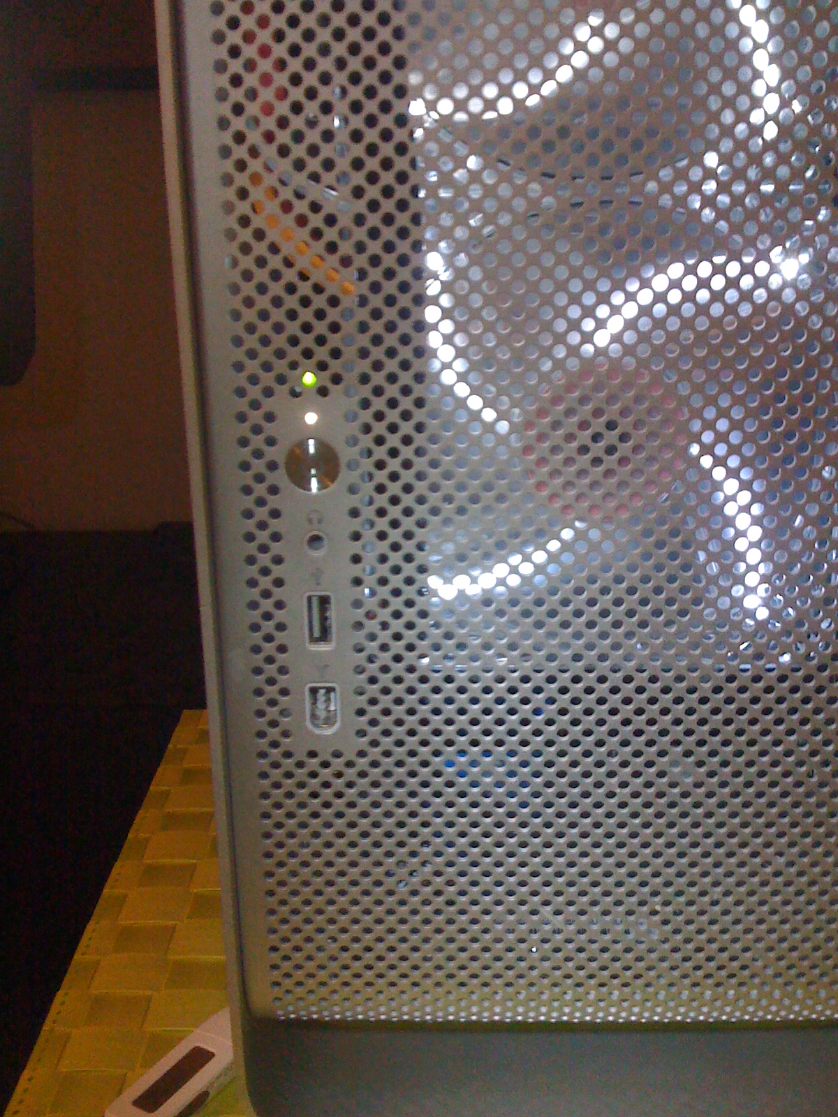

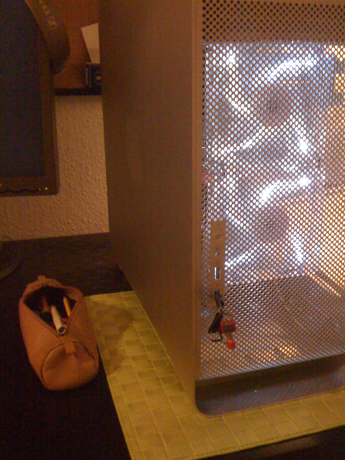

Just got the front panel work 100%
Before:
After:
USB,Firewire, Sound, HD LED(green) and power LED works
+ is working on gette Infrared in front
