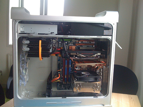

nerdalertdk Posted June 10, 2009 Share Posted June 10, 2009 Hi, Just what to share my photos of my Hackintosh mod. the front panel works also Spec: PowerMac G5 Case Intel Q9550 2.81 (Speedstep) GA-EP45T-Extreme (Intel P45, ICH10R, ALC889a(DSDT patch), Realtek 8111C(Bonjour fix) 4Gb DDR3 1333Mhz 500Gb(system) + 320Gb(Windows) GeForce 9800GTX+ (EFI String) Retail OSX 10.6.4(64Bit) + Chameleon 2 RC4 To come: SAS disks, need the controller Infrared Photos: http://www.flickr.com/photos/ilovecode/set...4562487/detail/ My Extra folder v1 (SL 10.6.1 - 64/32bit - bonjour fix(only in 32Bit)): Extra_2.zip My Extra folder v2 (SL 10.6.2 - 64bit - Bonjour fix, CPU Throttle ): Extra.zip Link to comment https://www.insanelymac.com/forum/topic/170112-powerhack-g5/ Share on other sites More sharing options...

nerdalertdk Posted July 8, 2009 Author Share Posted July 8, 2009 some more pic. The back of the case. It's missing the power plug but put it where its normal will be. Used an lian li motherboard tray My disksbay The to front fans is strip the the HD cage to provent redundancy Here you can se the small rubber rings Link to comment https://www.insanelymac.com/forum/topic/170112-powerhack-g5/#findComment-1195143 Share on other sites More sharing options...

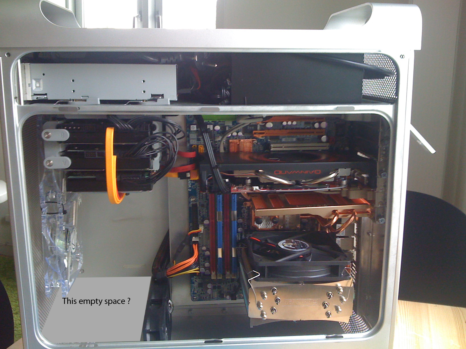

Scottapotamas Posted August 15, 2009 Share Posted August 15, 2009 i think you are right about the mobo tray being too wide. It appears to be 2.5 to 3 cm wider... Your PSU appears to be almost the same size as my Thermaltake 430NP-A2... but i need a new PSU anyway... Would you be able to roughly measure that empty space near the front of the case? i could end up putting my current one there until i get another one. Thanks a lot! Also, how did you get the front panel / headers to work.... Is there a guide here? Link to comment https://www.insanelymac.com/forum/topic/170112-powerhack-g5/#findComment-1226447 Share on other sites More sharing options...

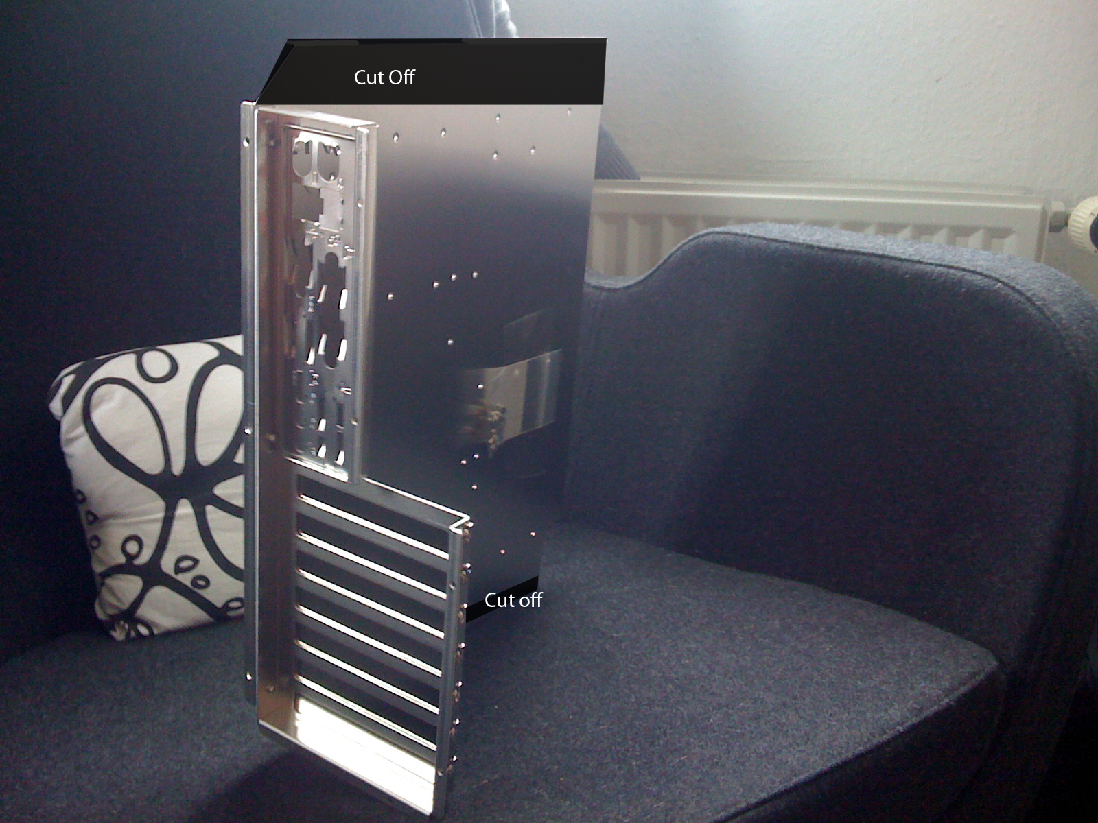

nerdalertdk Posted August 15, 2009 Author Share Posted August 15, 2009 i think you are right about the mobo tray being too wide. It appears to be 2.5 to 3 cm wider... Your PSU appears to be almost the same size as my Thermaltake 430NP-A2... but i need a new PSU anyway... Would you be able to roughly measure that empty space near the front of the case? i could end up putting my current one there until i get another one. Thanks a lot! Also, how did you get the front panel / headers to work.... Is there a guide here? Hi, I'm not sure what space we a talking about ? Is it this ? Also the tray to get it to fit you have to cut this off. Link to comment https://www.insanelymac.com/forum/topic/170112-powerhack-g5/#findComment-1226607 Share on other sites More sharing options...
Scottapotamas Posted August 15, 2009 Share Posted August 15, 2009 yes, that empty space... it looks nearly large enough to fit my current PSU... Thanks for telling me about the bits of the tray to cut! Link to comment https://www.insanelymac.com/forum/topic/170112-powerhack-g5/#findComment-1226631 Share on other sites More sharing options...

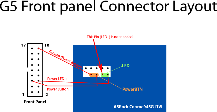

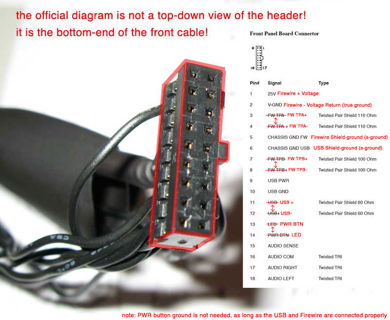

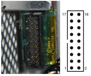

nerdalertdk Posted August 15, 2009 Author Share Posted August 15, 2009 H: 110mm (from bottom to the fans) L: 170mm (from front to the black fans) w: 190mm (side to side) Np My front panel was HELL to make, there is a lot of diagrams on the subject out there, but can post he ones I used Link to comment https://www.insanelymac.com/forum/topic/170112-powerhack-g5/#findComment-1226642 Share on other sites More sharing options...

nerdalertdk Posted August 18, 2009 Author Share Posted August 18, 2009 Hi.Nice work. I am, myself, looking to do something very similar. One question - did you have to modify the Lian-Li motherboard tray at all or did you use it as you bought it? Thanks Read http://www.insanelymac.com/forum/index.php...t&p=1226607 I made the Alu backplate my self out of 0.8mm Alu Link to comment https://www.insanelymac.com/forum/topic/170112-powerhack-g5/#findComment-1229448 Share on other sites More sharing options...
gazfocus Posted August 18, 2009 Share Posted August 18, 2009 Read http://www.insanelymac.com/forum/index.php...t&p=1226607 I made the Alu backplate my self out of 0.8mm Alu Thansk. That's really usefull. What type of saw do I need to cut metal? (Sorry I know it's probably a really basic question but never done it before). Link to comment https://www.insanelymac.com/forum/topic/170112-powerhack-g5/#findComment-1229456 Share on other sites More sharing options...
nerdalertdk Posted August 18, 2009 Author Share Posted August 18, 2009 Used a Angelgrinder with a 1mm metal disk Link to comment https://www.insanelymac.com/forum/topic/170112-powerhack-g5/#findComment-1229459 Share on other sites More sharing options...
