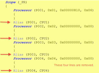

Gringo Vermelho Posted September 14, 2010 Share Posted September 14, 2010 A modded P5Q BIOS doesn't do anything magical for your sound, LAN, sleep or anything else. Neither does it include any of the common DSDT fixes to your HPET device, etc as that would break compatibility with other operating systems. The modded BIOSes for P5Q series boards have the CPU aliases removed in the DSDT table: This allows you to boot retail OS X on those motherboards with a Dual- or Quad Core CPU installed, without having to use a patched DSDT and/or booting with CPUS=1. That's all there is to it. If you have a P5Q series board and already have OS X running, there is absolutely no reason or benefit to using a modded BIOS. Now for the good news: If you use the Chameleon 2.0 RC5 bootloader it is no longer necessary to use a patched DSDT or modded BIOS in order to boot OS X on an Asus P5Q series motherboard: http://www.insanelymac.com/forum/index.php?showtopic=225766 Link to comment Share on other sites More sharing options...
