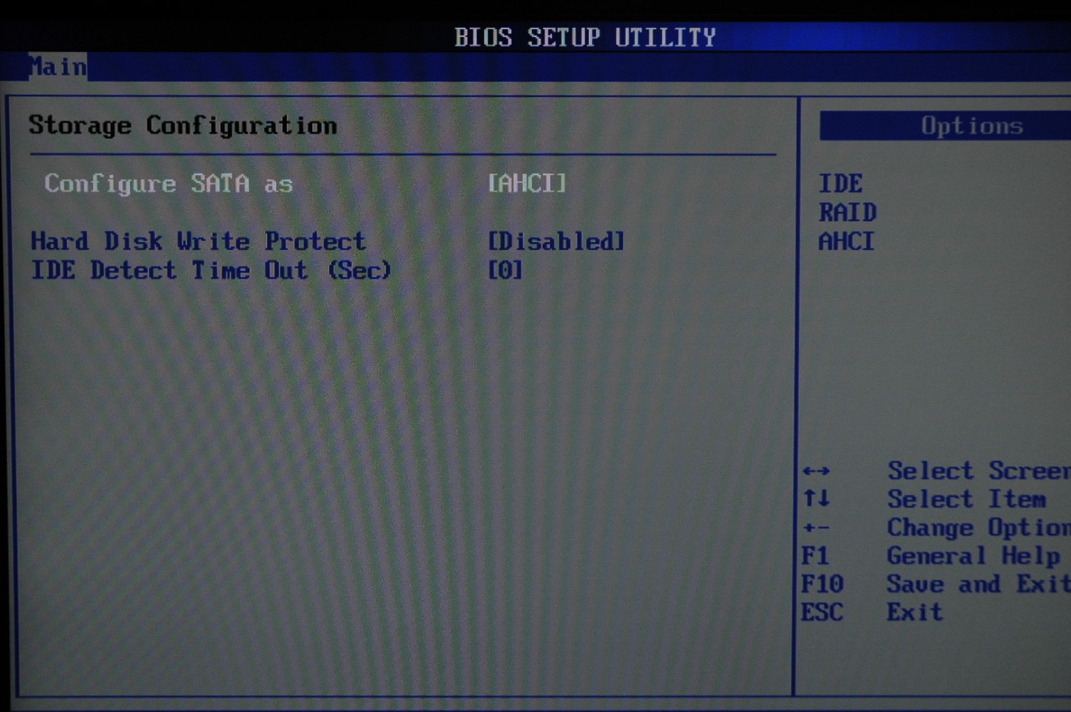

silverosx Posted December 11, 2009 Share Posted December 11, 2009 AHCI. As I said, I could install and am working with Leopard retail using your modded BIOS ( one would suppose HD settings are on AHCI in BIOS ). Anyway, will try to shoot some picts with my iPhone. May not be perfect. Link to comment Share on other sites More sharing options...
Shaumux Posted December 11, 2009 Share Posted December 11, 2009 AHCI. As I said, I could install and am working with Leopard retail using your modded BIOS ( one would suppose HD settings are on AHCI in BIOS ). Anyway, will try to shoot some picts with my iPhone. May not be perfect. Well they need not be perfect just to get an idea about what might the problem be.The problem might not even be with the hd. it can be with the dvd drive. Well the settings should be in Ahci but that might not be the case, best check it yourself. Try other modes if possible. Link to comment Share on other sites More sharing options...

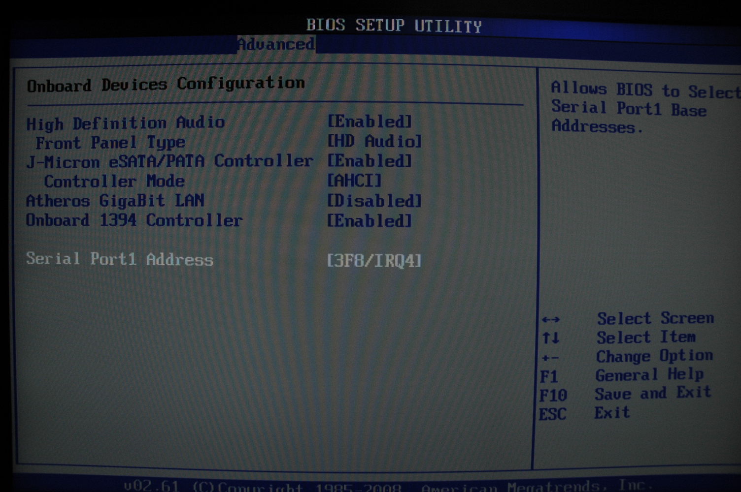

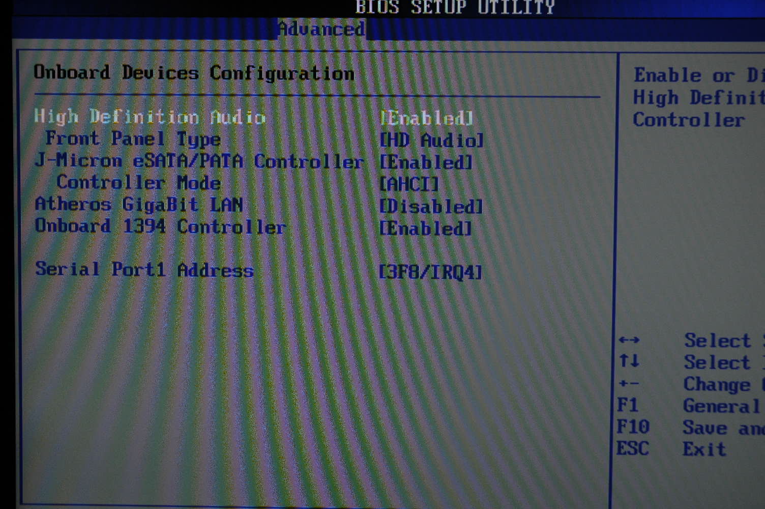

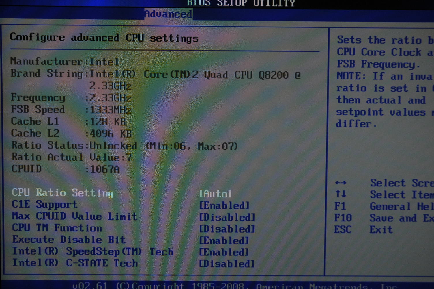

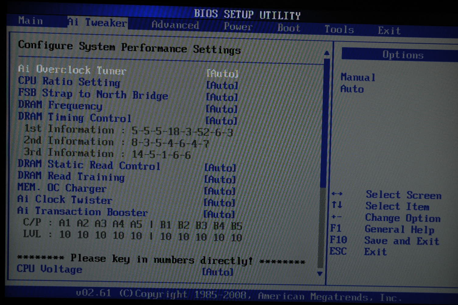

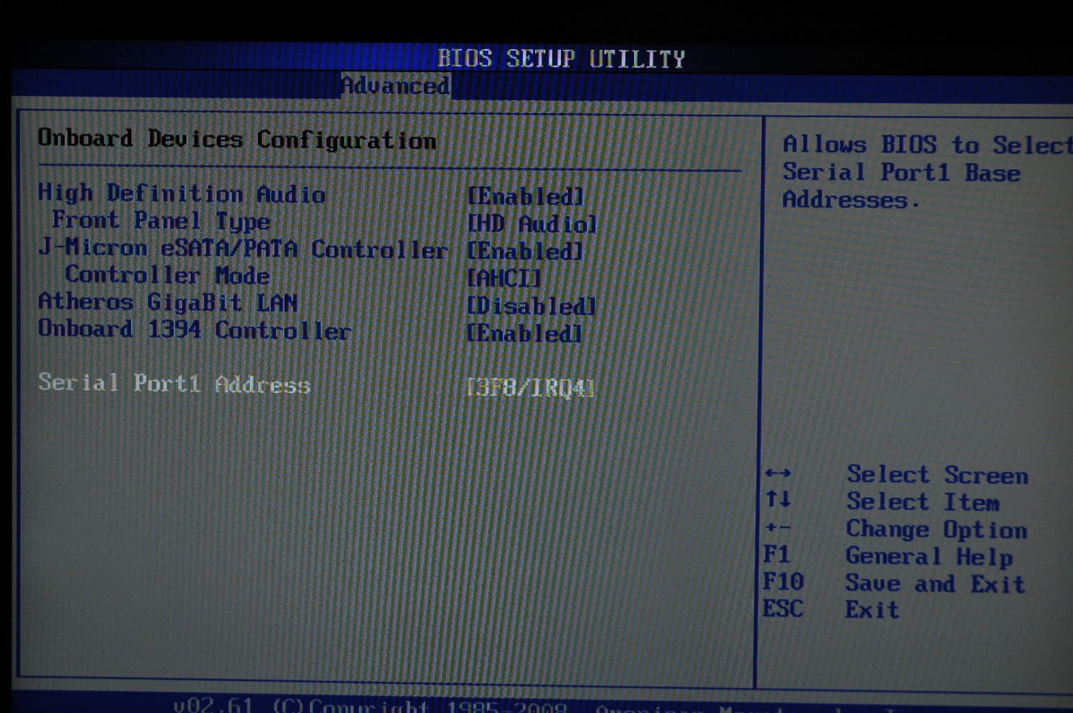

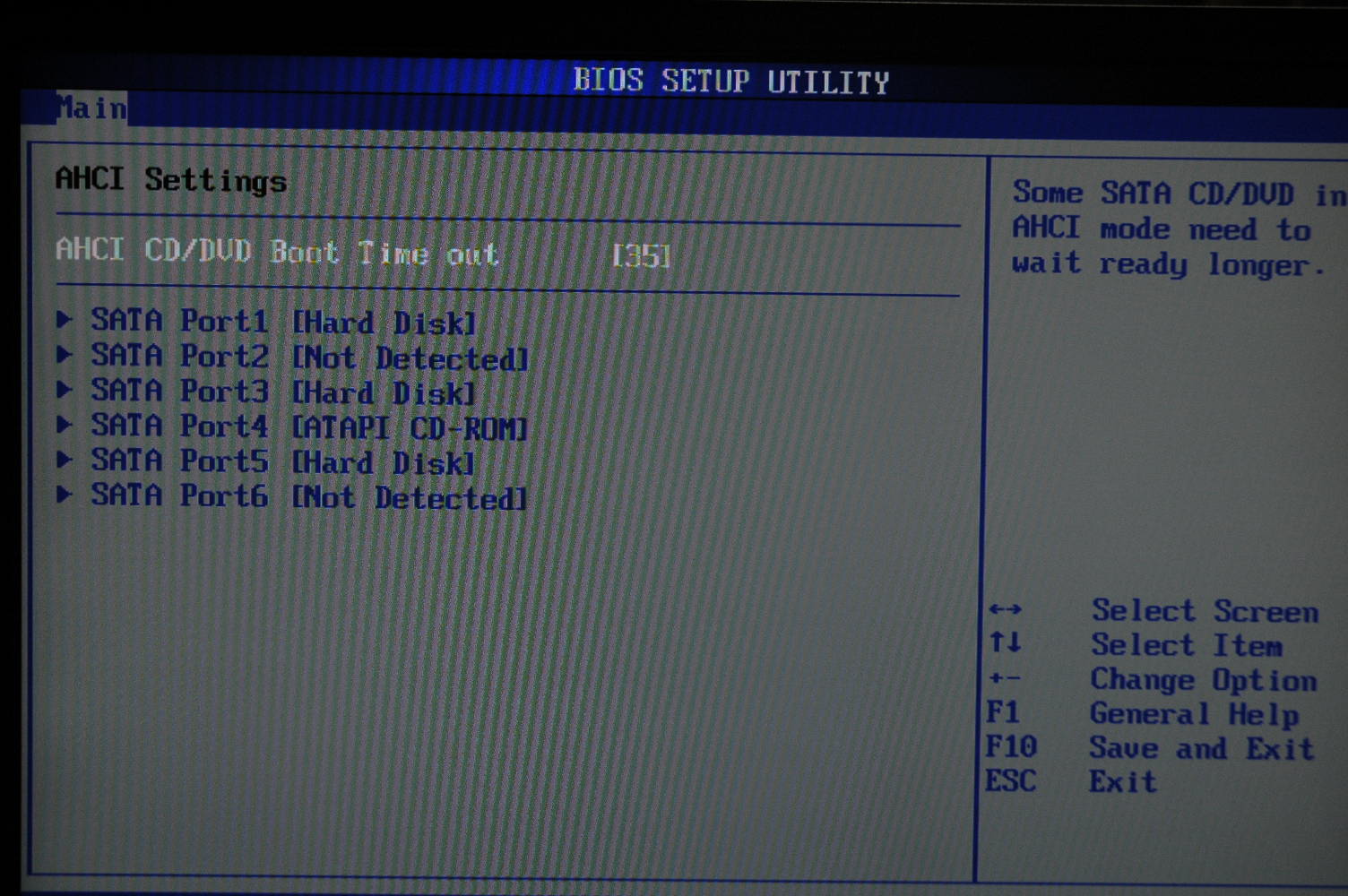

silverosx Posted January 8, 2010 Share Posted January 8, 2010 Well, after the hollidays I'm back and ready to keep trying install SL in my P5Q Pro Turbo. Shamaux, here are my MoBo settings. Maybe i'm not using a right version of your modded BIOS. Is there a link to the latest BIOS mod that you did? Link to comment Share on other sites More sharing options...
Shaumux Posted January 8, 2010 Share Posted January 8, 2010 Well, after the hollidays I'm back and ready to keep trying install SL in my P5Q Pro Turbo. Shamaux, here are my MoBo settings. Maybe i'm not using a right version of your modded BIOS. Is there a link to the latest BIOS mod that you did? Ok i see that you jmicron controller is enabled. Disable it and try to install SL. If you want to enable it install SL first then install the kext for it then enable it. Link to comment Share on other sites More sharing options...

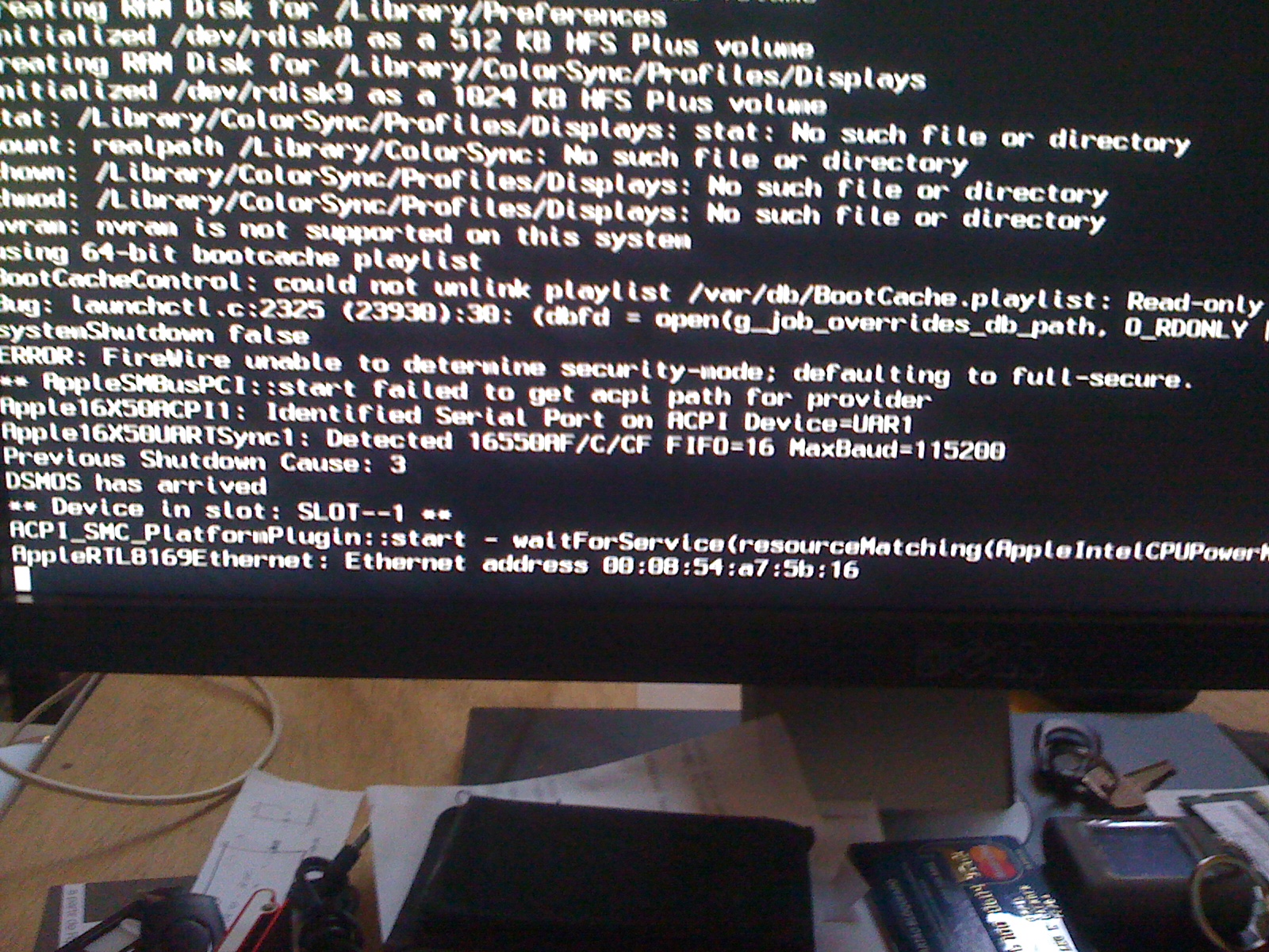

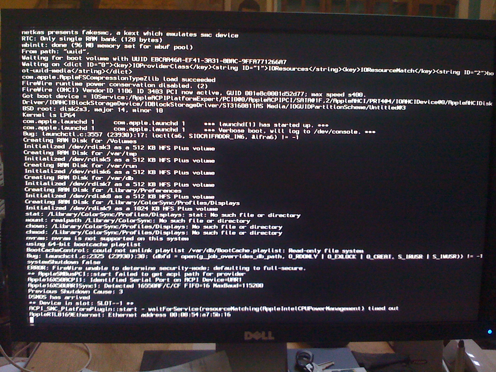

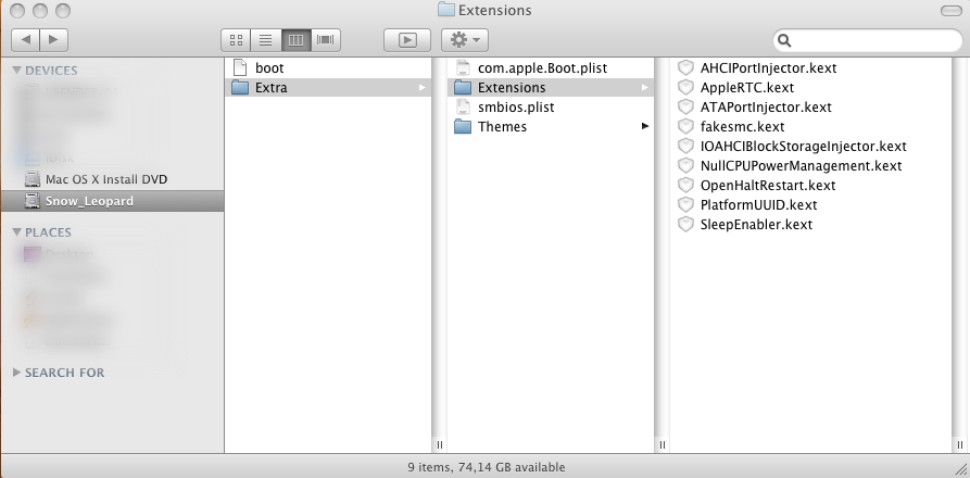

silverosx Posted January 11, 2010 Share Posted January 11, 2010 Tried with jmicron disable. Got the same error as before ( look at pictures ). Maybe I'm trying a wrong process to install it. How would you suggest a install SL under this board? Or maybe my modded BIOS is the wrong one ( but works flawless with Leo ). How is this new one different from the one you posted before? At last, Shaumux], maybe you could help me walk step by step in the process ( although I'm not that dumb in doing it ). All I know is that there's something I might be doing wrong, and I want to know what. Link to comment Share on other sites More sharing options...
Shaumux Posted January 11, 2010 Share Posted January 11, 2010 Tried with jmicron disable. Got the same error as before ( look at pictures ). Maybe I'm trying a wrong process to install it. How would you suggest a install SL under this board? Or maybe my modded BIOS is the wrong one ( but works flawless with Leo ). How is this new one different from the one you posted before? At last, Shaumux], maybe you could help me walk step by step in the process ( although I'm not that dumb in doing it ). All I know is that there's something I might be doing wrong, and I want to know what. From the photos i'd say most probably its a kext issue. Maybe a cache issue. sev1972 here faced something similar while experimenting. Try regenrating cache. Are your !0.5 kexts in the /extra kext folder? They might interfere. Link to comment Share on other sites More sharing options...
silverosx Posted January 18, 2010 Share Posted January 18, 2010 From the photos i'd say most probably its a kext issue.Maybe a cache issue. sev1972 here faced something similar while experimenting. Try regenrating cache. Are your !0.5 kexts in the /extra kext folder? They might interfere. Well, I sort understood what sev1972 tryed but couldn´t figure ou how he did it. As far as I can say, he just removed some kext from the bootloader that were giving him the load error. The thing is, I don´t know exactly wich kext or extensions to remove. Here´s what I have so far: 1) Have Leo 10.5.8 retail working 98% ( as expected ). 2) in the same HD as Leo, have a partition with an img of SL redy for install. 3) have a separate HD formated as GUID and waiting to install SL in it. 4) downloaded Chameleon RC4 and manually installed at SL HD. 5) doanloaded your Extra folder ( from the page you linked at above post - also followed the instructions to modify PlatformUUID.kext ) and placed in the SL HD root. 6) boot and choose SL HD as the boot HD. 7) Chameleon RC4 interface appears giving me the option of my current Leo partition or the SL Install partition. 8) verbose mode on SL Install and after a while, same error as posted in screenshot above shows up. Things I want to know about my ASUS P5Q Pro Turbo: 1) is it really possible to install SL on it ( I saw 1 or 2 topics stating successful installs but none of them gave the how-to )? 2) if it is so, is it better to go with modded BIOS or DSDT? How can I learn more about DSDT for my MoBo ( if this is the case )? 3) if modded BIOS is the solution, am I using the right one ( showed in screenshot above )? 4) I do have to say that I´m using Leo with current ( modded BIOS ) with no concern. 5) which are the preferred kext to use for SL in this MoBo? Thank you for your attention once more. PS: here´s a pict of SL HD as it is after Chameleon RC4 and your Extra folder: Link to comment Share on other sites More sharing options...

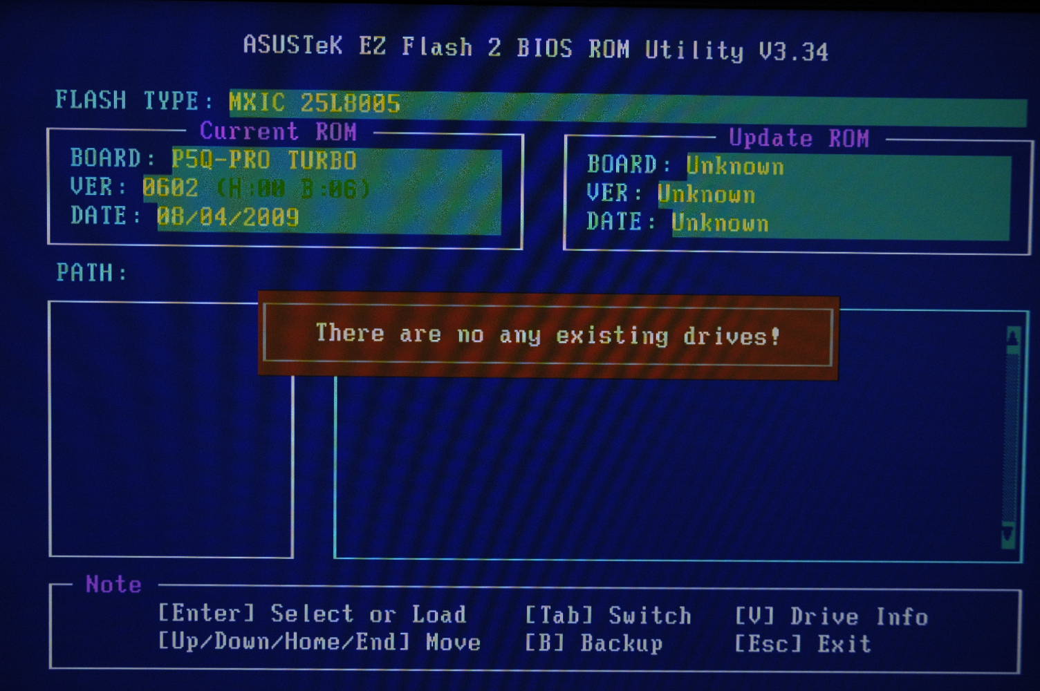

*Crysis* Posted February 6, 2010 Share Posted February 6, 2010 Thx, you're the best! I'll post my results... SLI enabled Wait, I can use SLI now? Or did you mean Crossfire? (I thought the board was Crossfire only?) UPDATE: BIOS works perfectly! w00t! BTW, If anyone gets an error when trying to update the BIOS using the BIOS' built-in tool EZ FLASH, "Error while erasing blocks", you have to rename the .ROM file to just the revision number. For example: ASUS_P5Q3_0806.rom needs to be 0806.rom Link to comment Share on other sites More sharing options...
