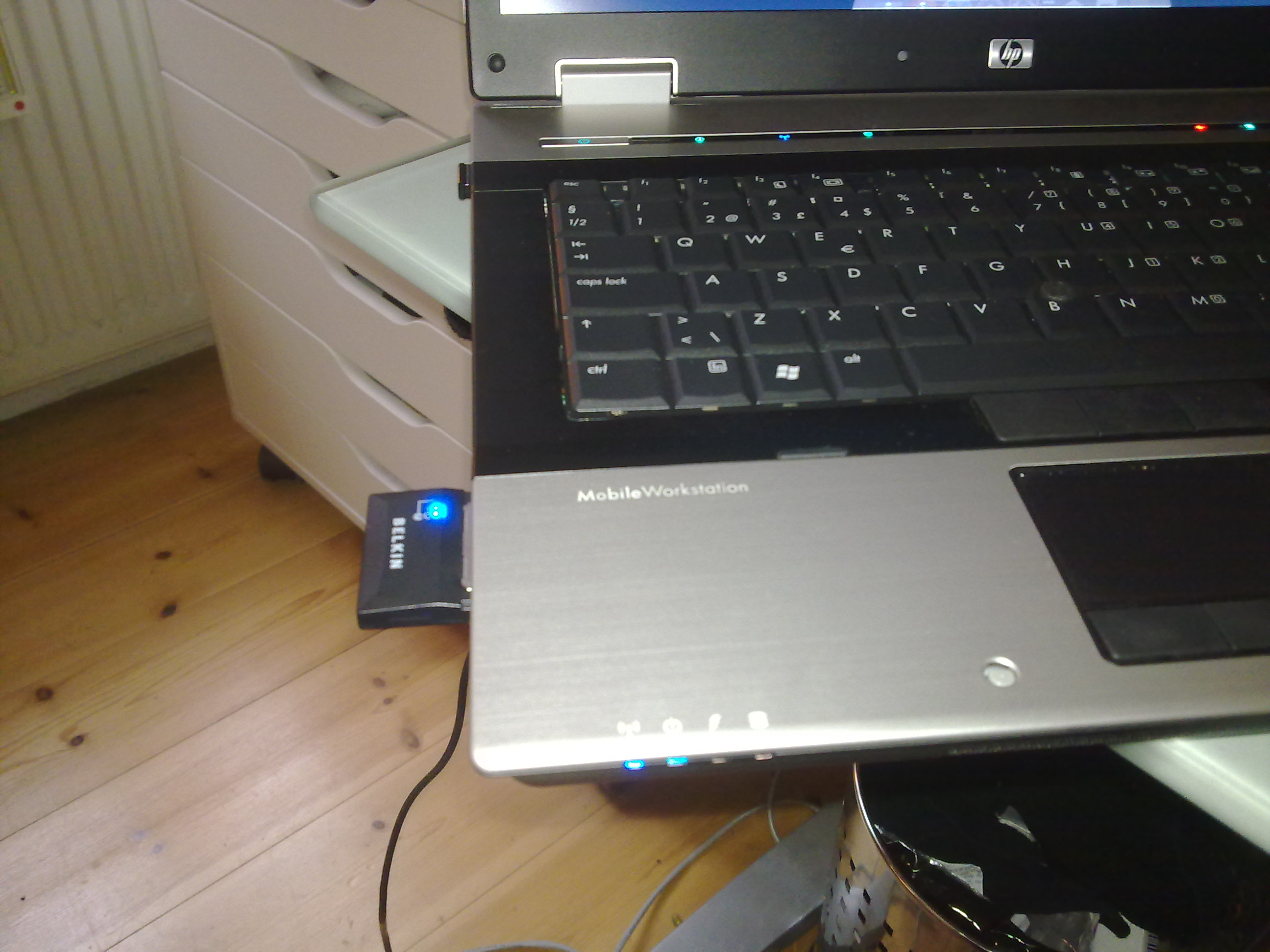

stevns Posted August 21, 2009 Share Posted August 21, 2009 EPIC fail x2 Apparently the card is INTEL!! I'll just nip off and shoot me self... Belkin ExpressCard bought and installed. (RT2860 driver) FRAG! That fruitless and EXPENSIVE! Link to comment Share on other sites More sharing options...

stevns Posted August 21, 2009 Share Posted August 21, 2009 Google Belkin F5D8073, because i bought my in Denmark, from a danish company. Around 40-50 USD. Driver: http://www.ralinktech.com.tw/data/drivers/..._2009_02_17.dmg I have attached a picture of the installed card. Acceptable "stiky-outy-ness" for permanent install, I think. Cheers Stevns Link to comment Share on other sites More sharing options...
