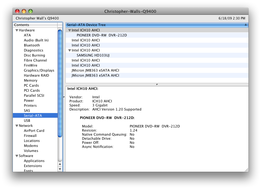

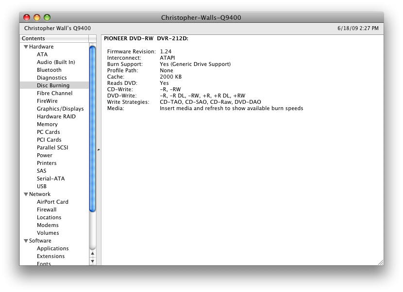

cwall64 Posted June 18, 2009 Share Posted June 18, 2009 True I didn't even think of that - I guess Iwill try to find a Pioneer! I just looked at my old Mac Pro and it is an IDE Pioneer DVR-111D. I bought a Pioneer DVR-212D and it is the Samsung drives! Auto-sleep works fine without a CD/DVD in the drive. It has entered sleep from the timer now 3 times. Craziest thing I have ever seen, problem is that the Pioneer was only available in beige where I bought it and case is black (http://www.microcenter.com/single_product_results.phtml?product_id=0295215)! Link to comment https://www.insanelymac.com/forum/topic/163899-gigabyte-ep45-ud3p-rev-11-retail-install-notes/page/3/#findComment-1180519 Share on other sites More sharing options...
Bart86 Posted June 18, 2009 Author Share Posted June 18, 2009 I bought a Pioneer DVR-212D and it is the Samsung drives! Auto-sleep works fine without a CD/DVD in the drive. It has entered sleep from the timer now 3 times. Craziest thing I have ever seen, problem is that the Pioneer was only available in beige where I bought it and case is black (http://www.microcenter.com/single_product_results.phtml?product_id=0295215)! Thats awsome! Can you do some more testing at some point? - If you have a spare sata port, can you also connect the original samsung drive in addtion to the Pioneer and see if you get the old issue back? - Can you cut and past the info in system profiler for the drive - Can you burn a DVD or 2 and verify the functionality of the Pioneer drive This may be more of an Apple bug than a hackintosh one. The ultimate test would be to replace the optical drive in one of the newer ICH10 Mac Pros with a SH-203N or similar and see if the problem exists. Those machines are so new and I suspect not many have had the need/desire to replace their drive yet. Link to comment https://www.insanelymac.com/forum/topic/163899-gigabyte-ep45-ud3p-rev-11-retail-install-notes/page/3/#findComment-1180991 Share on other sites More sharing options...
cwall64 Posted June 18, 2009 Share Posted June 18, 2009 Thats awsome! Can you do some more testing at some point? - If you have a spare sata port, can you also connect the original samsung drive in addtion to the Pioneer and see if you get the old issue back? - Can you cut and past the info in system profiler for the drive - Can you burn a DVD or 2 and verify the functionality of the Pioneer drive This may be more of an Apple bug than a hackintosh one. The ultimate test would be to replace the optical drive in one of the newer ICH10 Mac Pros with a SH-203N or similar and see if the problem exists. Those machines are so new and I suspect not many have had the need/desire to replace their drive yet. Sure, will try to get to that this afternoon. EDIT: the drive burns disk fine (2 Linux distros burnt). Images of System Profiler attached: Link to comment https://www.insanelymac.com/forum/topic/163899-gigabyte-ep45-ud3p-rev-11-retail-install-notes/page/3/#findComment-1181035 Share on other sites More sharing options...
