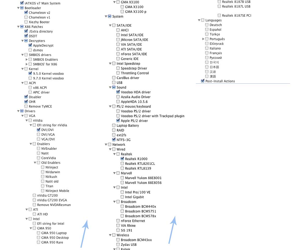

johnymist Posted November 5, 2009 Share Posted November 5, 2009 HELLO EVERYBODY i ve succesfully instal OSX on MSI G31M3-L V2. If you follow my steps you ll make it just fine... NOTE: I used iatkos v7. Consider one thing: MSI G31M3-L and MSI G31M3-F are basicaly the same whitch means YES you can use the same BIOS witch i'll attach belowA7529IMS.120.zip 1. after flashing of BIOS, Disable USB legasy support 2. on BIOS settings Choose ACPI -S1. Default is S3. 3. I Suppose you move on the set up. I attached a jpg you can print and use the settings from there. NOTE? although it seems that system profiller regognise on board Ethernet, it doesn't seem to work, so i pluged a thirt party PCI Ethernet (Realtek). Here's the spects I used: GIGABYTE GEFORCE 9400GT CUDA 1GB 4 gig ram 2xKINGSTON KVR667D2N5 2gb INTEL CORE 2 DUO E7500 2.93 GHZ SEAGATE BARRACUDA ST3750528AS 750GB dvd: SONY OPTIARC AD-5240S Whola! After installation TRY the following attached drivers for Audio.AzaliaAudio.pkg.zipALC888Audio.mpkg.zipALC883Audio.mpkg.zip NOTE: the system profiner shows no audio card but it doesnt matter, it works. CHEERS Link to comment https://www.insanelymac.com/forum/topic/163142-1056-on-msi-g31m3-f/#findComment-1320786 Share on other sites More sharing options...
