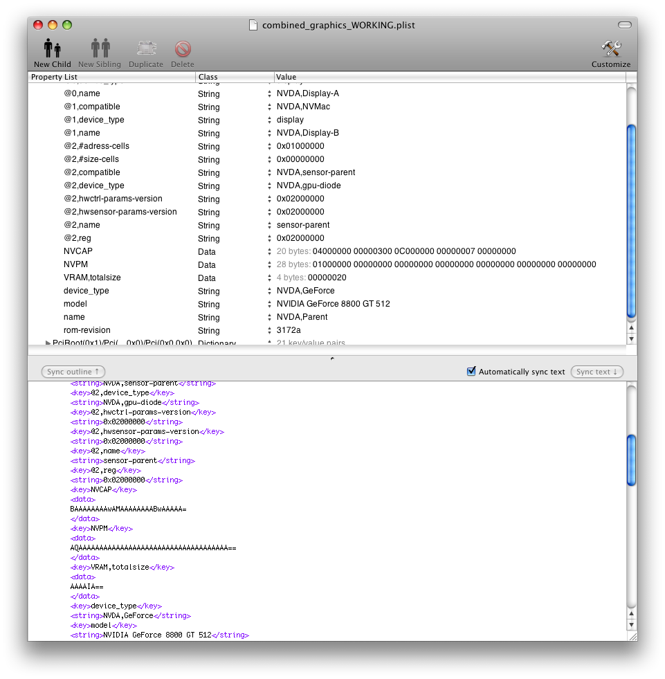

EGOvoruhk Posted July 21, 2009 Share Posted July 21, 2009 Do you know how to set up the DSDT.aml for a 9800 GX2/dual card? It just started working thanks to the new GTX 285 drivers, so it's not in the ACPI Patcher. Can we skip this step and still have it work via strings? What do we select? Thanks Link to comment https://www.insanelymac.com/forum/topic/161303-guidega-ep35-ds4-install-chameleon-20-rc2-efi-patition-1056-retail-update-1058-boot132-dsdt-patched-gfx-audio-nic/page/5/#findComment-1205076 Share on other sites More sharing options...
kdawg Posted July 21, 2009 Share Posted July 21, 2009 Do you know how to set up the DSDT.aml for a 9800 GX2/dual card? It just started working thanks to the new GTX 285 drivers, so it's not in the ACPI Patcher. Can we skip this step and still have it work via strings? What do we select? Thanks Do you have a working EFI string? If so attach the plist and current DSDT. What MOBO do you have? Link to comment https://www.insanelymac.com/forum/topic/161303-guidega-ep35-ds4-install-chameleon-20-rc2-efi-patition-1056-retail-update-1058-boot132-dsdt-patched-gfx-audio-nic/page/5/#findComment-1205105 Share on other sites More sharing options...
FKA Posted July 21, 2009 Author Share Posted July 21, 2009 Thanks. I think the sleep problems stem from two things. The USB fix and the Samsung/Toshiba (SH-S223F) optical dives. I tried updating the firmware on them to SB03 with no luck. Perhaps take a look at the USB section of my DSDT and take a peek. In the meantime I think I'll purchase a new optical drive. I've tried both the kext and DSDT fix for USB - both appear to be working fine. I've upgraded firmware for my TSSTcorp drive and disconnected it and tried with a disk in the drive. I believe my sleep problem is due to ATI GFX card. Do you know how to set up the DSDT.aml for a 9800 GX2/dual card? It just started working thanks to the new GTX 285 drivers, so it's not in the ACPI Patcher. Can we skip this step and still have it work via strings? What do we select? Thanks Hi Ego You can not set any parameters for GFX in koalala's patcher - compile and use efi strings. You will get errors on the compile but it worked like this for me in the past. Also you can try to set as 9000 series in the patcher with corrcet RAM value. You can change the model name to whatever as long as you follow the format .. ie change 'NVidia 9000 series' to 'NVidia 9800' **EDIT** roisoft has managed to get dual GFX cards working here *** kdawg - with all due respect, what exact process would you use to copy plist info into you DSDT.dsl?? Its too early for me .... i didn't read your post correctly !!! D. Link to comment https://www.insanelymac.com/forum/topic/161303-guidega-ep35-ds4-install-chameleon-20-rc2-efi-patition-1056-retail-update-1058-boot132-dsdt-patched-gfx-audio-nic/page/5/#findComment-1205109 Share on other sites More sharing options...
kdawg Posted July 21, 2009 Share Posted July 21, 2009 I've tried both the kext and DSDT fix for USB - both appear to be working fine. I've upgraded firmware for my TSSTcorp drive and disconnected it and tried with a disk in the drive. I believe my sleep problem is due to ATI GFX card. Hi Ego You can not set any parameters for GFX in koalala's patcher - compile and use efi strings. You will get errors on the compile but it worked like this for me in the past. Also you can try to set as 9000 series in the patcher with corrcet RAM value. You can change the model name to whatever as long as you follow the format .. ie change 'NVidia 9000 series' to 'NVidia 9800' **EDIT** roisoft has managed to get dual GFX cards working here *** kdawg - with all due respect, what exact process would you use to copy plist info into you DSDT.dsl?? Its too early for me .... i didn't read your post correctly !!! D. Any Plist editor would convert the hex values from his com.apple.Boot.plist then just plug those values into the DSDT. I would have generated the DSDT values by hand because I know koalala's patcher doesnt include those. Link to comment https://www.insanelymac.com/forum/topic/161303-guidega-ep35-ds4-install-chameleon-20-rc2-efi-patition-1056-retail-update-1058-boot132-dsdt-patched-gfx-audio-nic/page/5/#findComment-1205131 Share on other sites More sharing options...
FKA Posted July 21, 2009 Author Share Posted July 21, 2009 I read your post as ' I'm going to copy and paste plist values to the DSDT' ... apologies and please do carry on .. D Link to comment https://www.insanelymac.com/forum/topic/161303-guidega-ep35-ds4-install-chameleon-20-rc2-efi-patition-1056-retail-update-1058-boot132-dsdt-patched-gfx-audio-nic/page/5/#findComment-1205138 Share on other sites More sharing options...
EGOvoruhk Posted July 21, 2009 Share Posted July 21, 2009 **EDIT** roisoft has managed to get dual GFX cards working here *** Thanks! Any Plist editor would convert the hex values from his com.apple.Boot.plist then just plug those values into the DSDT. I would have generated the DSDT values by hand because I know koalala's patcher doesnt include those. So I could just take the giant 2 card hex I have in my com.apple.Boot.plist and throw them in my DSDT.aml? What tool would I use to edit it? ACPI Patcher under XP is the only thing I've messed with so far. Thanks Link to comment https://www.insanelymac.com/forum/topic/161303-guidega-ep35-ds4-install-chameleon-20-rc2-efi-patition-1056-retail-update-1058-boot132-dsdt-patched-gfx-audio-nic/page/5/#findComment-1205146 Share on other sites More sharing options...
FKA Posted July 21, 2009 Author Share Posted July 21, 2009 So I could just take the giant 2 card hex I have in my com.apple.Boot.plist and throw them in my DSDT.aml? What tool would I use to edit it? ACPI Patcher under XP is the only thing I've messed with so far. Thanks I have to admitt I'm starting to stuggle with this but have a read of post #9 in this thread here basically copy the HEx to a hex editor, save as *.dat, decompile the *.dat with iasl. D Link to comment https://www.insanelymac.com/forum/topic/161303-guidega-ep35-ds4-install-chameleon-20-rc2-efi-patition-1056-retail-update-1058-boot132-dsdt-patched-gfx-audio-nic/page/5/#findComment-1205185 Share on other sites More sharing options...
kdawg Posted July 21, 2009 Share Posted July 21, 2009 Thanks!So I could just take the giant 2 card hex I have in my com.apple.Boot.plist and throw them in my DSDT.aml? What tool would I use to edit it? ACPI Patcher under XP is the only thing I've messed with so far. Thanks I would do like FormerlyKnownAs suggests and try and use the closest match for your card with ACPI patcher. Then open your com.apple.Boot.plist (not in Hex format) in something like PlistEditorPro. The most important thing is you also have to be sure you're hitting the right PCI slots in the DSDT tree. Match the STRING values from the plist editor and plug them into your DSDT.dsl file. (See the attached visual in my last post) I assure you there will be a lot of trial and error so I hope you have a backup install that works so you can go back in and fix what you might have done wrong previously. You can take a look at my DSDT file to see where my two cards sit but you can't just copy my file. If you spend enough time looking at the DSDT you'll should be able to decipher enough of it to get your cards running. If you can get the cards working with EFI strings and Apple drivers you should be able to get them running via DSDT. Found some working EFI strings for the 285 here if the ones you're using don't fully work. http://aquamac.proboards.com/index.cgi?boa...&thread=509 Also, IRC is a good resource for knowledge when it comes to bleeding edge stuff like DSDT and newer cards like yours. Google "IRC OSX86" and you'll come up with some. Link to comment https://www.insanelymac.com/forum/topic/161303-guidega-ep35-ds4-install-chameleon-20-rc2-efi-patition-1056-retail-update-1058-boot132-dsdt-patched-gfx-audio-nic/page/5/#findComment-1205186 Share on other sites More sharing options...
kdawg Posted July 21, 2009 Share Posted July 21, 2009 Thanks!So I could just take the giant 2 card hex I have in my com.apple.Boot.plist and throw them in my DSDT.aml? What tool would I use to edit it? ACPI Patcher under XP is the only thing I've messed with so far. Thanks I did some digging and it seems the GTX 285 might be a bit different. You could flash your card with the Mac ROM from Netkas. Seems hairy though. This seems to be the way to go however. 1. Use this injector. 2. With these drivers 3. Then use pacifist to extract and install the kexts. But I still think it can be done via DSDT and eliminate the injector. What are the details of your setup? What's your string look like? Link to comment https://www.insanelymac.com/forum/topic/161303-guidega-ep35-ds4-install-chameleon-20-rc2-efi-patition-1056-retail-update-1058-boot132-dsdt-patched-gfx-audio-nic/page/5/#findComment-1205394 Share on other sites More sharing options...
EGOvoruhk Posted July 22, 2009 Share Posted July 22, 2009 What are the details of your setup? What's your string look like? http://www.insanelymac.com/forum/index.php...t&p=1202064 But I guess it doesn't work with DSDT, because of the built in PCI bridge on the GX2 Link to comment https://www.insanelymac.com/forum/topic/161303-guidega-ep35-ds4-install-chameleon-20-rc2-efi-patition-1056-retail-update-1058-boot132-dsdt-patched-gfx-audio-nic/page/5/#findComment-1205854 Share on other sites More sharing options...
FKA Posted July 22, 2009 Author Share Posted July 22, 2009 http://www.insanelymac.com/forum/index.php...t&p=1202064 But I guess it doesn't work with DSDT, because of the built in PCI bridge on the GX2 As ffosilva says, because there isn't an apple driver for the bridge you will still need the additional driver from EVGA. It is possible you can use DSDT and the additional drivers instead of EFI string or injector. For my ATI card I must have patched ATI kexts installed but use DSDT instead of natit. D Link to comment https://www.insanelymac.com/forum/topic/161303-guidega-ep35-ds4-install-chameleon-20-rc2-efi-patition-1056-retail-update-1058-boot132-dsdt-patched-gfx-audio-nic/page/5/#findComment-1206274 Share on other sites More sharing options...
