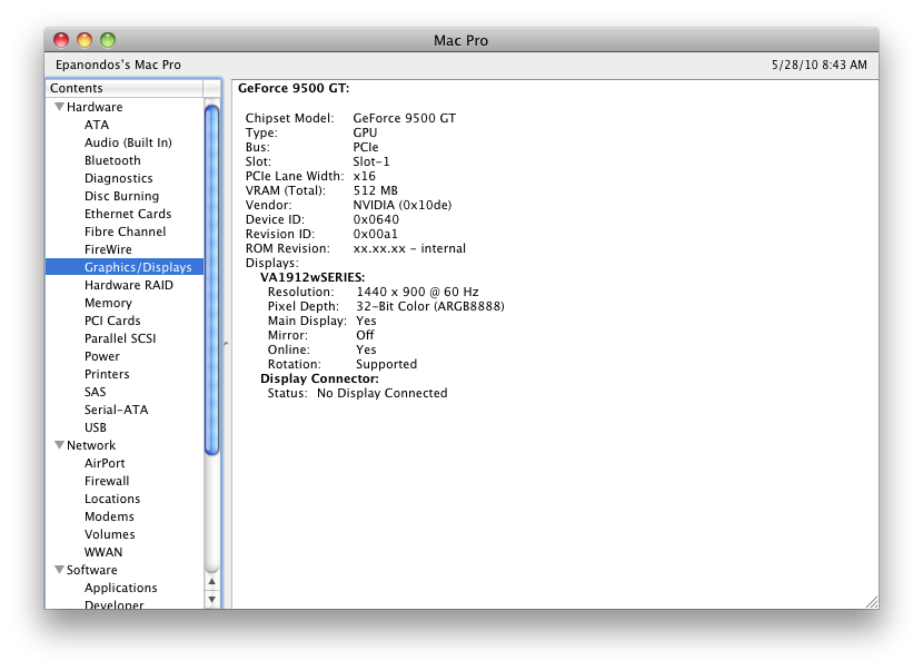

Going Bald Posted May 28, 2010 Share Posted May 28, 2010 I'm wondering this as well, doesn't seem there is an adaptor that goes from a DVI female to Mini Display Port Male. Would installing the Apple GT120 or 4870 in a hackintosh work? Specifically the GT120, I've looked around the forum and didn't see anybody talking about wether this was possible. The GT120 available from your local Apple Store will work. I got one for my nephew to add to his MP dual Nehalem that came with one so he could rum more monitors. It will work in a Hackintosh - we tried it on mine and the system recognizes it as a GE Force 9500GT. Be aware, however, that this card has only 2 outputs- DVI-D and Mini Display Link to comment https://www.insanelymac.com/forum/topic/158852-led-cinema-display-24-flat-panel/page/2/#findComment-1477300 Share on other sites More sharing options...
