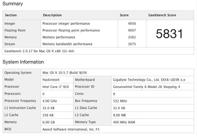

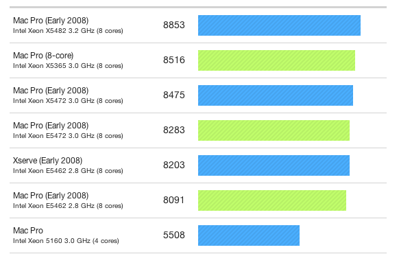

Ritz Carltn Posted April 6, 2009 Share Posted April 6, 2009 I installed 10.5.7 with boot-132 as followings. i7 920 GA-EX58-UD3R NVIDIA GeForce 9800 GTX 512 MB AHCI SATA-II 300G H.D.D. But, Performance is not reasonable. The result of Xbench http://db.xbench.com/merge.xhtml?doc1=3591...;setCookie=true Well I never Tried boot 132 methodI used the iAtkos CD But here are the modified kexts I use EX58_UD3R.zip Link to comment https://www.insanelymac.com/forum/topic/154516-os-x-install-on-ga-ex58-ud3r/#findComment-1125573 Share on other sites More sharing options...
AppleIIGuy Posted April 6, 2009 Author Share Posted April 6, 2009 I installed 10.5.7 with boot-132 as followings. i7 920 GA-EX58-UD3R NVIDIA GeForce 9800 GTX 512 MB AHCI SATA-II 300G H.D.D. But, Performance is not reasonable. The result of Xbench http://db.xbench.com/merge.xhtml?doc1=3591...;setCookie=true Here are my scores. Geekbench Result XBench Result What kernel are you using? And are you using DDR3 Ram in 3 channel mode? also are you using the proper kexts? Link to comment https://www.insanelymac.com/forum/topic/154516-os-x-install-on-ga-ex58-ud3r/#findComment-1125744 Share on other sites More sharing options...
