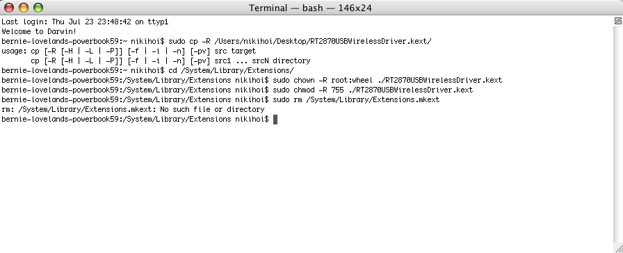

nikihoi Posted July 24, 2009 Share Posted July 24, 2009 "Tried dragging the extension directly into the extensions folder"That tells me you just used Finder to install the kext. That's not how you install kexts. There are ways to do it in Terminal, but the easiest way is with KextHelper. Just install KextHelper and use it to install the kexts. It says "You cannot open the application "Kext Helper B7" its not supported on this system" UGH!!! Link to comment https://www.insanelymac.com/forum/topic/151237-wusb54gc-how-to-use-new-official-driver-utility/page/5/#findComment-1207800 Share on other sites More sharing options...
Warstrong Posted July 24, 2009 Author Share Posted July 24, 2009 It says "You cannot open the application "Kext Helper B7" its not supported on this system" UGH!!! Open a terminal window (in Applications/Utilities). Type the following exactly as written. Only replace the <> fields with the correct entries (enter your password when asked): sudo cp -R <drag first kext here (doesn't matter which one)> cd /System/Library/Extensions sudo chown -R root:wheel ./nameof.kext sudo chmod -R 755 ./nameof.kext sudo rm /System/Library/Extensions.mkext sudo rm /System/Library/Extensions.kextcache quit (or exit, I forget) Open a new Terminal window sudo cp -R <drag second kext here> cd /System/Library/Extensions sudo chown -R root:wheel ./nameof.kext sudo chmod -R 755 ./nameof.kext sudo rm /System/Library/Extensions.mkext sudo rm /System/Library/Extensions.kextcache quit (or exit, I forget) Hopefully this works... It's been a long time since I've entered this manually and I had to use another post on this site. Link to comment https://www.insanelymac.com/forum/topic/151237-wusb54gc-how-to-use-new-official-driver-utility/page/5/#findComment-1207802 Share on other sites More sharing options...
nikihoi Posted July 24, 2009 Share Posted July 24, 2009 Open a terminal window (in Applications/Utilities). Type the following exactly as written. Only replace the <> fields with the correct entries (enter your password when asked): sudo cp -R <drag first kext here (doesn't matter which one)> cd /System/Library/Extensions sudo chown -R root:wheel ./nameof.kext sudo chmod -R 755 ./nameof.kext sudo rm /System/Library/Extensions.mkext sudo rm /System/Library/Extensions.kextcache quit (or exit, I forget) Open a new Terminal window sudo cp -R <drag second kext here> cd /System/Library/Extensions sudo chown -R root:wheel ./nameof.kext sudo chmod -R 755 ./nameof.kext sudo rm /System/Library/Extensions.mkext sudo rm /System/Library/Extensions.kextcache quit (or exit, I forget) Hopefully this works... It's been a long time since I've entered this manually and I had to use another post on this site. Do I type all that in on one line before hitting enter? And do I keep the < & > and enter the kext file names in between? Link to comment https://www.insanelymac.com/forum/topic/151237-wusb54gc-how-to-use-new-official-driver-utility/page/5/#findComment-1207809 Share on other sites More sharing options...
Warstrong Posted July 24, 2009 Author Share Posted July 24, 2009 Do I type all that in on one line before hitting enter? no, for each line you're supposed to type and then hit enter, and then move on to the next line. Link to comment https://www.insanelymac.com/forum/topic/151237-wusb54gc-how-to-use-new-official-driver-utility/page/5/#findComment-1207810 Share on other sites More sharing options...

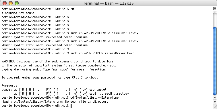

nikihoi Posted July 24, 2009 Share Posted July 24, 2009 no, for each line you're supposed to type and then hit enter, and then move on to the next line. Not having much luck here Take a look at the attached file... Link to comment https://www.insanelymac.com/forum/topic/151237-wusb54gc-how-to-use-new-official-driver-utility/page/5/#findComment-1207814 Share on other sites More sharing options...
Warstrong Posted July 24, 2009 Author Share Posted July 24, 2009 Not having much luck here Take a look at the attached file... Hahaha, sorry man. I should have said to not include the angle brackets. For example, you should have done this for the first line: sudo cp -R AndDragTheKextHereUsingAFinderWindow.kext The angle brackets indicate a new line with the terminal, which is why you can't use them with the name of a file. If you just give it the NAME of a kext it doesn't know where it is on the hard drive, so you must give the full address of it. The easiest way to do this is by using the Finder to drag the kext where you would type that. I also notice you didn't put a space in between CD (change directory) and the location of the Extensions folder. Use copy and paste to avoid further typos. Link to comment https://www.insanelymac.com/forum/topic/151237-wusb54gc-how-to-use-new-official-driver-utility/page/5/#findComment-1207821 Share on other sites More sharing options...
nikihoi Posted July 24, 2009 Share Posted July 24, 2009 Hahaha, sorry man. I should have said to not include the angle brackets. For example, you should have done this for the first line: sudo cp -R AndDragTheKextHereUsingAFinderWindow.kext The angle brackets indicate a new line with the terminal, which is why you can't use them with the name of a file. If you just give it the NAME of a kext it doesn't know where it is on the hard drive, so you must give the full address of it. The easiest way to do this is by using the Finder to drag the kext where you would type that. I also notice you didn't put a space in between CD (change directory) and the location of the Extensions folder. Use copy and paste to avoid further typos. The first worked fine but this one i am getting an error... do have any idea why? Link to comment https://www.insanelymac.com/forum/topic/151237-wusb54gc-how-to-use-new-official-driver-utility/page/5/#findComment-1207832 Share on other sites More sharing options...
Warstrong Posted July 24, 2009 Author Share Posted July 24, 2009 The first worked fine but this one i am getting an error... do have any idea why? Sorry for the late reply, I thought I had hit reply... It should be fine without removing Extensions.mkext. I would look in /System/Library/ with Finder to double check, but it looks like it just isn't there. You can probably just skip that line and not worry if the one after it doesn't work either. Link to comment https://www.insanelymac.com/forum/topic/151237-wusb54gc-how-to-use-new-official-driver-utility/page/5/#findComment-1207861 Share on other sites More sharing options...

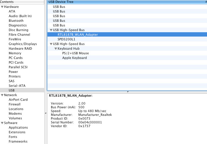

ovi Posted August 3, 2009 Share Posted August 3, 2009 i tried all of the methods but i cant work my wusb54gc it still says No Device!! i think the problem is my product id.. i cant found a kext which contains my product id. RTL8187B_WLAN_Adapter: Version: 2.00 Bus Power (mA): 500 Speed: Up to 480 Mb/sec Manufacturer: Manufacturer_Realtek Product ID: 0x0073 Serial Number: 00e04c000001 Vendor ID: 0x1737 Link to comment https://www.insanelymac.com/forum/topic/151237-wusb54gc-how-to-use-new-official-driver-utility/page/5/#findComment-1216383 Share on other sites More sharing options...
playfullyrastadoul Posted August 5, 2009 Share Posted August 5, 2009 i tried all of the methods but i cant work my wusb54gc it still says No Device!! i think the problem is my product id.. i cant found a kext which contains my product id. RTL8187B_WLAN_Adapter: Version: 2.00 Bus Power (mA): 500 Speed: Up to 480 Mb/sec Manufacturer: Manufacturer_Realtek Product ID: 0x0073 Serial Number: 00e04c000001 Vendor ID: 0x1737 but it's a realtek driver for realtek devices... i'm not sure it will work... Link to comment https://www.insanelymac.com/forum/topic/151237-wusb54gc-how-to-use-new-official-driver-utility/page/5/#findComment-1217164 Share on other sites More sharing options...
Warstrong Posted August 6, 2009 Author Share Posted August 6, 2009 i tried all of the methods but i cant work my wusb54gc it still says No Device!! i think the problem is my product id.. i cant found a kext which contains my product id. RTL8187B_WLAN_Adapter: Version: 2.00 Bus Power (mA): 500 Speed: Up to 480 Mb/sec Manufacturer: Manufacturer_Realtek Product ID: 0x0073 Serial Number: 00e04c000001 Vendor ID: 0x1737 Yeah, I never knew that the 0073/1737 device was Realtek and not Ralink, but I think they might be the same (hard to tell because of RalinkTech and RealTek). Anyway, it's definitely in the RT2870 kext that's part of the "Apps and Kexts.zip" in the OP. If you don't believe me just open up the RT2870 kext and open up info.plist. The entry for your device is titled "WUSB54GC Version 2-2". Maybe this is a Realtek device and the people with this are the people who can't get theirs to work. Please post back with results, ovi. Link to comment https://www.insanelymac.com/forum/topic/151237-wusb54gc-how-to-use-new-official-driver-utility/page/5/#findComment-1217891 Share on other sites More sharing options...

ovi Posted August 6, 2009 Share Posted August 6, 2009 Yeah, I never knew that the 0073/1737 device was Realtek and not Ralink, but I think they might be the same (hard to tell because of RalinkTech and RealTek). Anyway, it's definitely in the RT2870 kext that's part of the "Apps and Kexts.zip" in the OP. If you don't believe me just open up the RT2870 kext and open up info.plist. The entry for your device is titled "WUSB54GC Version 2-2". Maybe this is a Realtek device and the people with this are the people who can't get theirs to work. Please post back with results, ovi. warstrong yes i see the device id named version2-2 in the kext.. but my wireless adapter still not working.. i take some photos maybe they may help you.. Link to comment https://www.insanelymac.com/forum/topic/151237-wusb54gc-how-to-use-new-official-driver-utility/page/5/#findComment-1218541 Share on other sites More sharing options...
