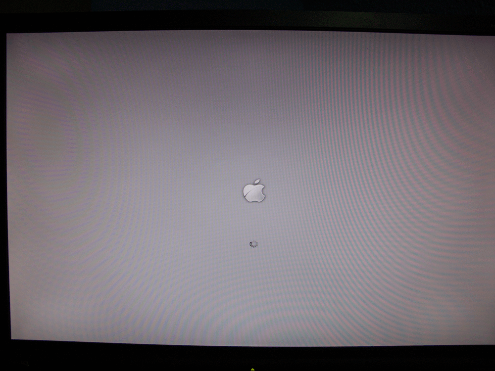

sock Posted May 28, 2009 Share Posted May 28, 2009 I have a ATI 4850 and this happened to me. The only solution I've found is to have the DVI to VGA adapter plugged into your second DVI port. Weird, but it works. I'm using the only DVI-out, there is a VGA-out and HDMI-out, I have added a different monitor to the VGA socket but nothing on there either. Does anyone else have any suggestions? Link to comment https://www.insanelymac.com/forum/topic/149505-guide-retail-os-x-install-1058-on-gigabyte-ga-ex58-ud5-core-i7-mobo/page/62/#findComment-1164802 Share on other sites More sharing options...

sock Posted May 28, 2009 Share Posted May 28, 2009 I fixed the black screen issue with netkas' framebuffer package! Now I can see a screen with nothing but a background and a mouse. No dock, no finder. No drive activity either. Any ideas? Or can someone tell me how to stop chameleon from loading OSX straight away so that I can type -v and enter verbose mode? [EDIT using the excellent instructions above it works! Woo! Thanks to everyone who made this possible Link to comment https://www.insanelymac.com/forum/topic/149505-guide-retail-os-x-install-1058-on-gigabyte-ga-ex58-ud5-core-i7-mobo/page/62/#findComment-1165220 Share on other sites More sharing options...
digital_dreamer Posted May 28, 2009 Author Share Posted May 28, 2009 I fixed the black screen issue with netkas' framebuffer package! Now I can see a screen with nothing but a background and a mouse. No dock, no finder. No drive activity either. Any ideas? Or can someone tell me how to stop chameleon from loading OSX straight away so that I can type -v and enter verbose mode? TIA In the boot.plist, change the "Quiet Boot" string to "No", or just delete that key and string entirely. regards, MAJ Link to comment https://www.insanelymac.com/forum/topic/149505-guide-retail-os-x-install-1058-on-gigabyte-ga-ex58-ud5-core-i7-mobo/page/62/#findComment-1165238 Share on other sites More sharing options...

koalaboy Posted May 30, 2009 Share Posted May 30, 2009 Just another (final) success story here: i7 920, UD5, 12GB RAM, ATI 4850. I used 3.6 with a HD connected to my macbook, and it all seemed to work fine except I had a black screen at the end of boot. This seemed to be related to the port I was using on the 4850 (it has 1 DVI, 1 VGA and 1 HDMI, and it's the DVI I want to use). After reading a few posts, I then applied the latest netkas along with the 'modified framebuffer' package, and that fixed it - I still can't use S3 sleep as the screen is corrupted on wake, but I rarely use sleep anyway on a desktop. I'm really grateful to DD, and the others who've posted help. I've tried severall times to get all sorts of 'retail' installs to work, with no joy and now this works amazingly - maybe 10.5.7 helped as I'd tried a previous script in the same way with bad results, but this combination is perfect. I don't use onboard audio, but a USB Line6 Toneport UX8, and that works great once official drivers are installed, as does the UAudio UAD-2. The only questions I'd have: 1) I have two .pkg files from netkas for the graphics fixes... how do I extract the relevant files and update the script to add these to chameleon, rather than install them direct ? 2) I assume the corrupt screen on wake is requiring a further netkas fix - or do I need to update my bios from F4 to F8b ? Anyway, thanks again for all the hard work and patience from you guys. I can finally demote windows into a fusion VM Link to comment https://www.insanelymac.com/forum/topic/149505-guide-retail-os-x-install-1058-on-gigabyte-ga-ex58-ud5-core-i7-mobo/page/62/#findComment-1166025 Share on other sites More sharing options...
