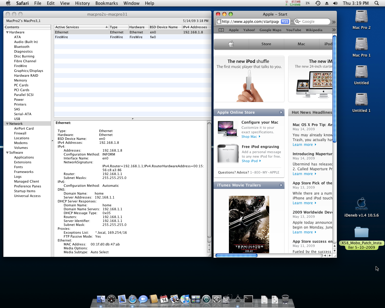

Godzillar Posted May 14, 2009 Share Posted May 14, 2009 If you're using the MacPro4,1 identifier, try changing it back to MacPro3,1 in /Extra/smbios.plist.EDIT: But, I'd wait until you've fully tested Safari 3 out first. Third KP. This time it happens when I try to wake up the computer. Actually the second KP was similar, the system KP when I woke the computer and started loading webpage in Safari. However, the first KP doesn't involve sleep/wake. Hope this helps! P.S. model identifier is MacPro4,1. Will try something like iMac8,1. I reinstalled Safari 4 Beta 2 and removed OpenHaltRestart.kext. I'll see if these works. Link to comment https://www.insanelymac.com/forum/topic/149505-guide-retail-os-x-install-1058-on-gigabyte-ga-ex58-ud5-core-i7-mobo/page/52/#findComment-1156213 Share on other sites More sharing options...

fallbrooks13 Posted May 14, 2009 Share Posted May 14, 2009 Those with no audio are probably not on the UD5 board. They may need the older AppleHDA.kext from 10.5.6.Netkas had this to say: Also, I thought the "Unable to determine UUID for host. Error: 35" errors were odd, because we already have the IONetworkingFamily.kext that includes the IOBuiltin = true fix for this. So, I just deleted the NetworkInterfaces.plist in Library/Preferences/SystemConfiguration and rebooted. Appears to take care of the issue. Sadly, the growl/Mail fix is not in, so we still have to use "show summary" to keep Mail from quitting. regards, MAJ Make sure that link is not actually dead and in need of a reset. I've had a Ethernet port got bad after a reboot on the Gigabyte board. Go in the BIOS and do a cable test with the SMART LAN1/LAN2. If it doesn't show "Detecting port..." then it's probably bad. Just do a BIOS CMOS clear or unplug the PSU for 10 seconds or so. MAJ OS 10.5.7, plus Chameleon 1012 and Voodoo-based 9.6.0 kernel combo appears to be fine, surprisingly (the new vanilla kernel is almost twice the size of the 9.6.0 version). About This Mac info doesn't report correctly and System Profiler/Hardware and Memory only report "error during reading" (Console shows "index beyond bounds" error). This is in spite of using the AppleSMBIOS.kext that's normally included. This environment hasn't been fully tested, but appears surprisingly functional, all things considered. MAJ Awesome! Thanks for that! Everyone will appreciate that info. MAJ Thanks! Cleared CMOS. Restored BIOS settings and now both ethernets are back Wooo! Link to comment https://www.insanelymac.com/forum/topic/149505-guide-retail-os-x-install-1058-on-gigabyte-ga-ex58-ud5-core-i7-mobo/page/52/#findComment-1156622 Share on other sites More sharing options...
