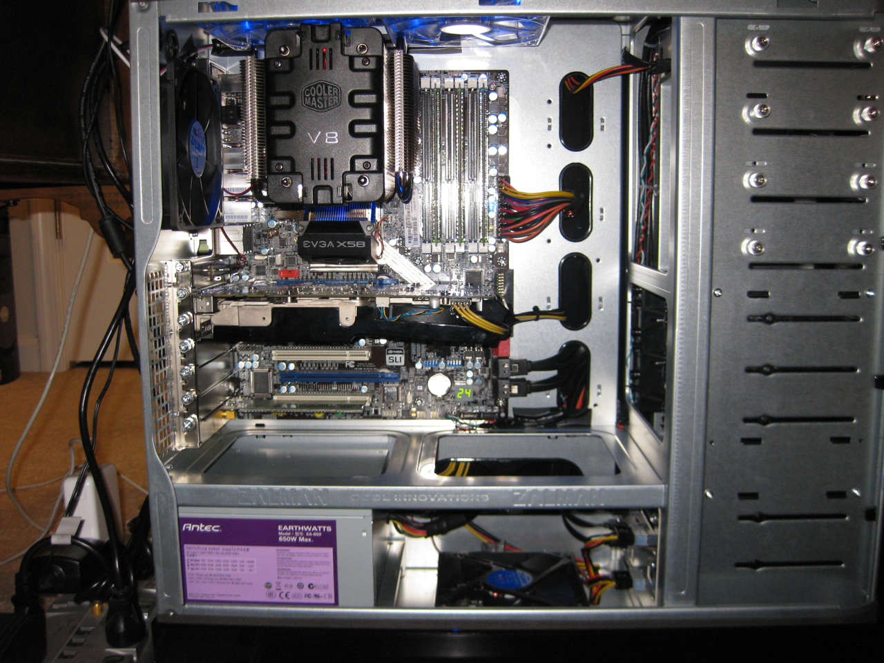

airwalk776 Posted May 15, 2009 Share Posted May 15, 2009 So I was little pissed off at how my cased looked in terms of cables all over the place. Been meaning to get a better case and finally got around to it today. Check It out BTW anyone know a better way to run the graphics card power, it been bugging be how it just sticks out there. Let me know whatcha think Link to comment https://www.insanelymac.com/forum/topic/149505-guide-retail-os-x-install-1058-on-gigabyte-ga-ex58-ud5-core-i7-mobo/page/53/#findComment-1156816 Share on other sites More sharing options...
AdamNJ77 Posted May 15, 2009 Share Posted May 15, 2009 So I was little pissed of at how my cased looked in terms of cables all over the place. Been meaning to get a better case and finally got around to it today. Check It out BTW anyone know a better way to run the graphics card power, it been bugging be how it just sticks out there. Let me know whatcha think WOW, very roomy. I don't think I have ever seen tower put together so neatly. I need to study this picture...I have wires everywhere lol. If you find anyway to get those video card wires out of the way let us know please. Having the two on my 4870 just sticking out there is just REALLY in the way Link to comment https://www.insanelymac.com/forum/topic/149505-guide-retail-os-x-install-1058-on-gigabyte-ga-ex58-ud5-core-i7-mobo/page/53/#findComment-1156821 Share on other sites More sharing options...
