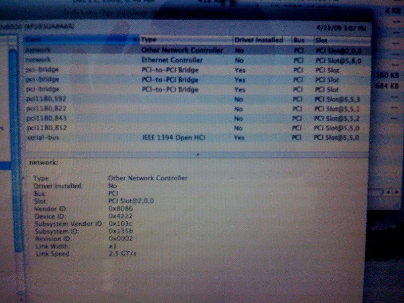

FedeSAN Posted April 23, 2009 Share Posted April 23, 2009 Hi, I can´t still resolve my problem whit My Ethernet card Intel PRO/100 VE in a HP DV6265us whit 10.5.6… if I look in Application – Utilities -- System Profiler I see that the Ethernet card is recognizing for OS but the driver it not installed, I upload a picture whit a capture of my screen… can any help me, I don´t know what more to do… Link to comment https://www.insanelymac.com/forum/topic/14840-intel-pro100-ve-nic/page/8/#findComment-1140327 Share on other sites More sharing options...
jazzminos Posted April 24, 2009 Share Posted April 24, 2009 to Fedesan Please, be patient... I have this problem too... We are trying to solve it at the moment. Link to comment https://www.insanelymac.com/forum/topic/14840-intel-pro100-ve-nic/page/8/#findComment-1140694 Share on other sites More sharing options...
