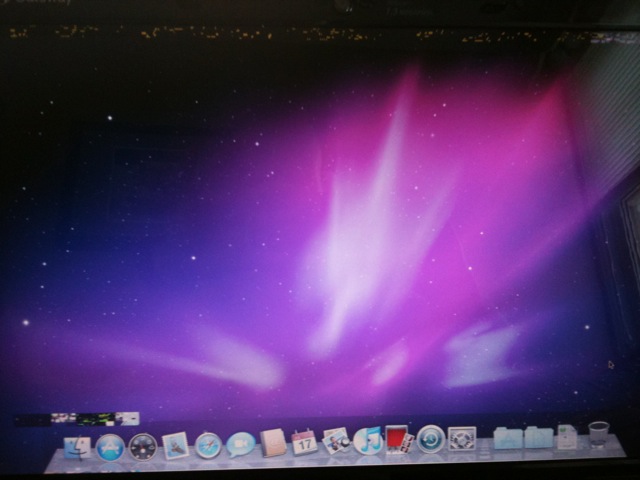

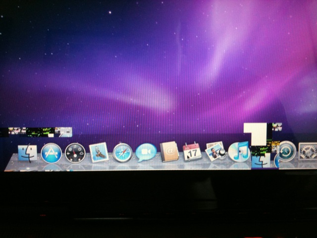

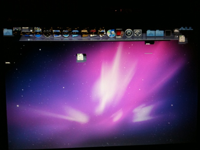

methvenc Posted April 7, 2011 Share Posted April 7, 2011 Hello, I am fairly new to this but have a basic understanding. I have been having issues trying to get my gfx card recognized correctly and working with Quartz Extreme. Unfortunately the basic result is scxreen corruption quickly followed by the system freezing on boot up. The best results I have had is gfx card recognized correctly with no quartz extreme. Below is my system and what I have tried up until now to get this working. System GateWay P7803h 9800 GTS 1 GB T7350 Core 2 Duo Mac OS X 10.6.5 (Retail install) [url="http://www.insanelymac.com/forum/topic/279450-why-insanelymac-does-not-support-tonymacx86/"]#####[/url] 2.6 [url="http://www.insanelymac.com/forum/topic/279450-why-insanelymac-does-not-support-tonymacx86/"]#####[/url] 3.3 (Chameleon 2 RC5) I have tried this with Mac OS X 10.6.3 - 10.6.6 and get the same results. 1. NvEnbaler tried in both /s/l/e and /Extra/e, I am sure this used to work for me but now I get this gfx corruption and freezing on boot up. Removed nvenabler.kext system is more stable. I assume it is using some generic driver as I am getting 1280X800 and in system profiler it is listed as GPU w/32 MB vRam. (But no flicker or freezing) 2. Tried booting with 'GraphicsEnabler=Yes' switch that I read somewhere in this fourm which resulted in the old behavior of freezing/flickering and gfx corruption. 3. Have also tried installing various drivers, tried NvInject and other suggestions i picked up from various forums. All get me same results. 4. Best results were when I manually injected gfx strings into the apple.boot.plist using the link below. With this method my card was recognized correctly in System profiler but no QE. I did try to manually add my device ID to nvdanv50hal.kext and nvdaresman with same results. (Link of post i followed to do this) http://aquamac.proboards.com/index.cgi? ... 509&page=1? (Post I created when no QE) http://aquamac.proboards.com/index.cgi?boa...amp;thread=1254 I am not sure what to try next, I have done several reinstalls after trying a couple of methods. I think I may try to follow a DSDT guide I saw somewhere in this site.. but if someone has a better suggestion i'd love to hear it. Or if someone kows how to find out what the conflict is, as far as I know my card is supported with Graphicsenabler=yes strin g so I have no idea what the problem is. I am beginning to think it may be a hardware issue but everything works fine in windows... Link to comment https://www.insanelymac.com/forum/topic/147377-help-installing-osx86-on-a-gateway-p-7805u/page/14/#findComment-1667032 Share on other sites More sharing options...
TheOriginalPol Posted April 7, 2011 Share Posted April 7, 2011 Hmmm. Weird, never heard of this issue before. We don't have QUITE the same card, as mine is a 9800M, but that shouldn't make too much difference. This is a weird suggestion, but have you tried it with... nothing? Full graphics have been working for me straight OOB ever since Leopard/Snow Leopard. So, maybe try removing all of those tweaks from your system? One thing I don't see mentioned here is the pciroot=0 fix. That has made all the difference for me before. Try searching for info on that one (it's easy). Another thing I'd really push, though I know this is a generic answer that nobody wants to hear, is a clean wipe and reinstall. Start over from scratch. A lot of times, especially with these more quirky issues, it is just an unexplainable corruption or something. It's funny how even when following all of the exact same steps you can get totally different results with this sort of thing. Could you maybe post a screenshot of what this stuff looks like? Also try booting verbose with -v flags to see if you get any interesting messages. Thanks for troubleshooting & searching & trying stuff on your own before posting. EDIT: nvm, I didn't see that you'd already tried bunches of reinstalls. My bad Link to comment https://www.insanelymac.com/forum/topic/147377-help-installing-osx86-on-a-gateway-p-7805u/page/14/#findComment-1667275 Share on other sites More sharing options...
methvenc Posted April 13, 2011 Share Posted April 13, 2011 Hmmm. Weird, never heard of this issue before. We don't have QUITE the same card, as mine is a 9800M, but that shouldn't make too much difference. This is a weird suggestion, but have you tried it with... nothing? Full graphics have been working for me straight OOB ever since Leopard/Snow Leopard. So, maybe try removing all of those tweaks from your system? One thing I don't see mentioned here is the pciroot=0 fix. That has made all the difference for me before. Try searching for info on that one (it's easy). Another thing I'd really push, though I know this is a generic answer that nobody wants to hear, is a clean wipe and reinstall. Start over from scratch. A lot of times, especially with these more quirky issues, it is just an unexplainable corruption or something. It's funny how even when following all of the exact same steps you can get totally different results with this sort of thing. Could you maybe post a screenshot of what this stuff looks like? Also try booting verbose with -v flags to see if you get any interesting messages. Thanks for troubleshooting & searching & trying stuff on your own before posting. EDIT: nvm, I didn't see that you'd already tried bunches of reinstalls. My bad Hey TheOriginalPol, Thanks for the reply. One thing I would like to clear up is we have the exact same card, typo on my part. My card is 9800M GTS as well. I am beginning to wonder if it is an issue with my gfx chip. One other thing of note is I may have updated my bios in the last few months. (Well.. I did update the bios but I cannot remember exactly when.) My bios version is 9C.25 I believe. I repartitioned the drive , reinstalled Mac OS X and used [url="http://www.insanelymac.com/forum/topic/279450-why-insanelymac-does-not-support-tonymacx86/"]#####[/url]/[url="http://www.insanelymac.com/forum/topic/279450-why-insanelymac-does-not-support-tonymacx86/"]#####[/url]. I just installed the [url="http://www.insanelymac.com/forum/topic/279450-why-insanelymac-does-not-support-tonymacx86/"]#####[/url] install and when I boot up with graphicsenabler=Y I get this funky gfx corruption and freezing. I will attach a picture taken with my iphone. (Cant screenshot as system freezes) I also have an output of my system profiler ill attach tomorrow which has the system.log of my last failed bootup. With graphicsenabler=N string I can boot up but gfx card is obviously not recognized properly. So I'm at a loss. Either it's a bad gfx chip, bad bios, or im am just missing something. Did you have to remove any of the Apple extensions.. for some reason I faintly remember having this issue when I first made installed Mac OSX (I may have failed to mention I had a stable system running for a good 6 months when I ran into this issue, it was a few days after I had updated to 10.6.6 but I am sure it was running fone for a few days after the update) Ill tinker around some more, uploiad that system profile report and check -v for anything strange.. is a log created when you boot using verbose? Thanks for all the help! **Uploaded Mac Pro.spx (system profiler report) had to change the name of file to Mac Pro.txt. Mac_Pro.txt Link to comment https://www.insanelymac.com/forum/topic/147377-help-installing-osx86-on-a-gateway-p-7805u/page/14/#findComment-1669503 Share on other sites More sharing options...
methvenc Posted April 29, 2011 Share Posted April 29, 2011 I figured out my issue! As stated below I had updated the bios so I figureed what the hell, I will reflash back to 9c.23 and do a fresh erase and install.. and it worked! I used the [url="http://www.insanelymac.com/forum/topic/279450-why-insanelymac-does-not-support-tonymacx86/"]#####[/url]/[url="http://www.insanelymac.com/forum/topic/279450-why-insanelymac-does-not-support-tonymacx86/"]#####[/url] method with retail SL. With [url="http://www.insanelymac.com/forum/topic/279450-why-insanelymac-does-not-support-tonymacx86/"]#####[/url] I used [url="http://www.insanelymac.com/forum/topic/279450-why-insanelymac-does-not-support-tonymacx86/"]#####[/url] install and for gfx to work all i needed was graphicsenabler=Y. This was so frustrating but hopefully someone else will elarn from this, anyone with this notebook, DO NOT flash to 9c.25 bios!!! (On the gateway website there is an FAQ about gfx corruption and blue screen in windows after flashing to this version of bios. Thanks to OriginalPol for taking the time to help, I havent had any response in other fourms, so I appreciate it! Hey TheOriginalPol, Thanks for the reply. One thing I would like to clear up is we have the exact same card, typo on my part. My card is 9800M GTS as well. I am beginning to wonder if it is an issue with my gfx chip. One other thing of note is I may have updated my bios in the last few months. (Well.. I did update the bios but I cannot remember exactly when.) My bios version is 9C.25 I believe. So I'm at a loss. Either it's a bad gfx chip, bad bios, or im am just missing something. Link to comment https://www.insanelymac.com/forum/topic/147377-help-installing-osx86-on-a-gateway-p-7805u/page/14/#findComment-1676335 Share on other sites More sharing options...
