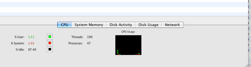

blackfish Posted October 6, 2009 Share Posted October 6, 2009 I have a Core2 Duo processor... Is this correct and my DG35EC Hackintosh is only using one core? Model Name: Mac Pro Model Identifier: MacPro3,1 Processor Speed: 2.4 GHz Number Of Processors: 1 Total Number Of Cores: 1 L2 Cache: 3 MB Memory: 8 GB Bus Speed: 1.07 GHz Boot ROM Version: MP31.00C1.B00 SMC Version (system): 1.13f3 Serial Number (system): W87234JHYA4 Hardware UUID: 00000000-0000-1000-8000-000000000000 Link to comment Share on other sites More sharing options...
LouCioccio Posted October 6, 2009 Share Posted October 6, 2009 To really check go to /Applications/Utilities/activity.app Look for cpu you should see two frames for both cores; that way you know its working. Ciao, Lou Cioccio Link to comment Share on other sites More sharing options...
blackfish Posted October 7, 2009 Share Posted October 7, 2009 This is what I see... ? -Fish Any idea why only 1 core is working? -Fish DG35EC 8 GB Ram NV 8400GS Core2Duo 2.4Ghz 10.6.1 Sata HD Sata DVD AHCI / HPET Vanilla Retail Instal as per this guide (early SL install-not updated with new Kexts/Boot) Any idea why only 1 core is working? -Fish Link to comment Share on other sites More sharing options...
blackfish Posted October 8, 2009 Share Posted October 8, 2009 Any idea why only 1 core is working? Ah... I figured it out. I have no idea why but the Multiplexing feature in y BIOS was Disabled. I changed it and voila! 2 cores. Thanks everyone... especially Sliptees! I love this SL Hackintosh! -Fish Link to comment Share on other sites More sharing options...
