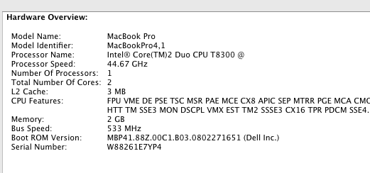

I tried.
This is my Boot.plist
<dict>
<key>Kernel</key>
<string>mach_kernel</string>
<key>Kernel Flags</key>
<string></string>
<key>Timeout</key>
<string>5</string>
		<key>SMbiosversion</key>
	 <string>MBP41.88Z.00C1.B03.0802271651</string>
	 <key>SMmanufacter</key>
	 <string>Apple Inc.</string>
	 <key>SMproductname</key>
	 <string>MacBookPro4,1</string>
	 <key>SMsystemversion</key>
	 <string>1.0.14</string>
	 <key>SMserial</key>
	 <string>W88261E7YP4</string>
<key>device-properties</key>
<string></string>
</dict>
My pictures and dsdt
dsdt_fixed.txt
Share this post
Link to post

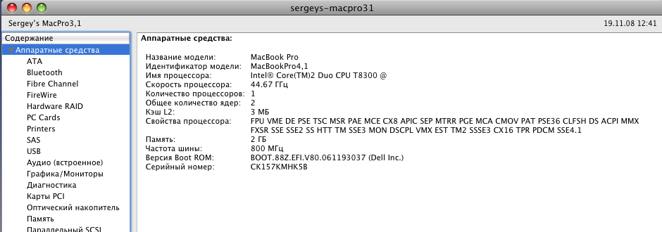

I tried.
I have currently no time to look at you DSDT. However I would suggest using vanilla AppleSMBIOS with SMBIOS-patching chameleon. Also looking at sysctl hw may give an answer.

Yes, I have vanilla SMBIOS without any SMBIOSEFI additions.
Looking for other informations...
Strange. Because serial in properties should be the same as in Boot.plist. Are you sure that you have installed Chameleon correctly?
Have you set your SMmaximalclock and SMexternalclock?

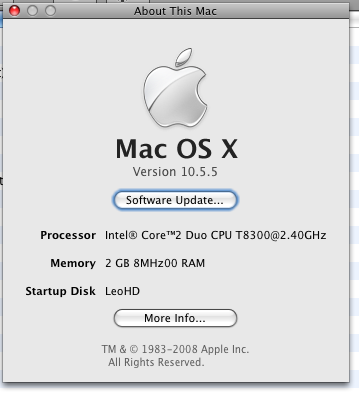

Hi!
Grat stuff!
Working serial, modell, etc... but what the format is SMExternalclock and SMMaxclock?
And SMmaxclock is my processor clock without multiplier?
I have Intel CoreDuo 2.17 Memory speed is 667.
How to set this keys?
Help Please!

Hi!
Grat stuff!
Help Please!
Your spelling is incorrect
Everything is in Mhz.
Here the description of the fields in SMBIOS specifications:
Max Speed: Maximum processor speed (in MHz) supported by the
system for this processor socket. 0E9h for a 233MHz
processor. If the value is unknown, the field is set to 0.
Note: This field identifies a capability for the system,
not the processor itself.
External Clock: External Clock Frequency, in MHz. If the value is
E.g. For Dual-Core 1.86Ghz at 133 FSB you should put:
<key>SMexternalclock</key>
<string>133</string>
<key>SMmaximalclock</key>
<string>1866</string>
to your com.apple.Boot.plist
I haven't tested this myself since theese values are correctly supplied by BIOS on my system.
Share this post
CK157KMHK5B serial number is from pcefi8 or some other netkas made iirc.

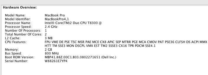

Next attempt
<string>2400</string>
How can I know that my AppleSMBIOS v1.0.14 is true vanilla?
EDITED: My problem is resolved. It is a bug of IntelEnhancedSpeedStep v1.4.0.
After replacing it by Superhai driver processor speed is OK.My bus speed must be 200.
Share this post

I am sorry about vanilla SMBIOS. Newest version is 1.0.14.
But new observation:
with version 1.0.9 I have some info about memory
with version 1.0.14 I have no any RAM info with the same Boot.plist.
I can inject custom values but I want to correct AppleSMBIOS for automatic RAM detection. Is it possible?
