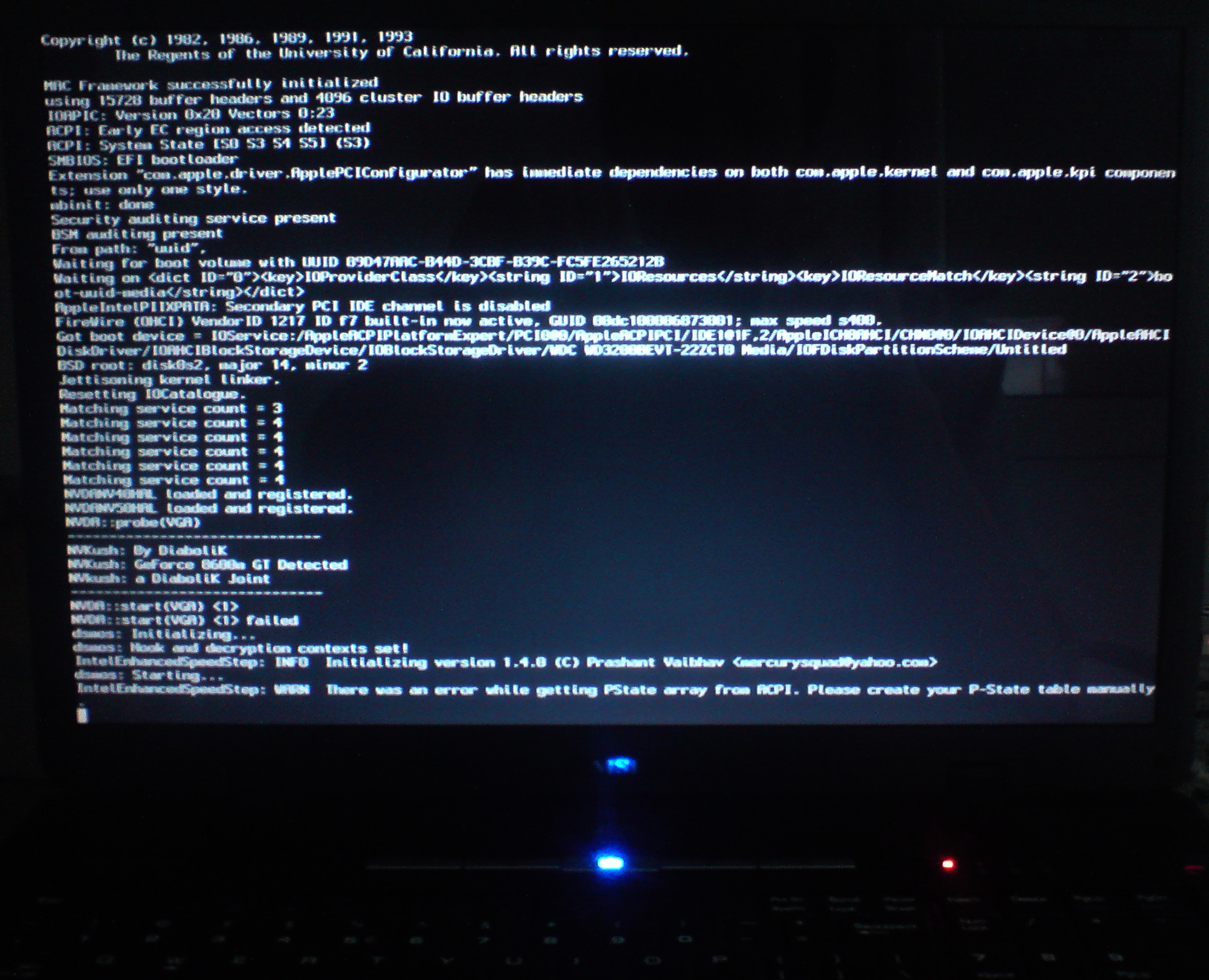

alyosa2001 Posted November 21, 2008 Author Share Posted November 21, 2008 When i try to use vanilla AppleAcpiPlatform my laptop freezes at boot. If i use the patched one included in ideneb DVD it says: IntelEnhancedSpeedStep: INFO Initialising version1.4.0 © Prashant Vaibhav <mercurysquad@yahoo.com> dsmos: Starting... IntelEnhancedSpeedStep: WARN There was an error while getting PState array from ACPI. Please create your P-State table manually My battery lasts only 45 mins, while in windows it can last upto 2 hours Link to comment https://www.insanelymac.com/forum/topic/136050-msi-megabook-gx700-owners-experieces/#findComment-973543 Share on other sites More sharing options...

alyosa2001 Posted November 23, 2008 Author Share Posted November 23, 2008 Yes, i've just enables both cores!!!! Here it is how: use the chameleon file in chameleon.zip to replace the boot file placed in the root of your instalation drive. then use the DSDT patcher inside DSDT_Patcher1.0.1e.zip to create dsdt.aml, which you copy again to the root. Reboot with CPUS=2 and, voila!!!! Does you card reader work? I don't know, haven't tested it yet Thank you very much Mackerintel, fssl, Kabyl, OriginalMacnut and all the people involved in the OSx86 project!! chameleon.zip DSDT_Patcher1.0.1e.zip Link to comment https://www.insanelymac.com/forum/topic/136050-msi-megabook-gx700-owners-experieces/#findComment-975306 Share on other sites More sharing options...
