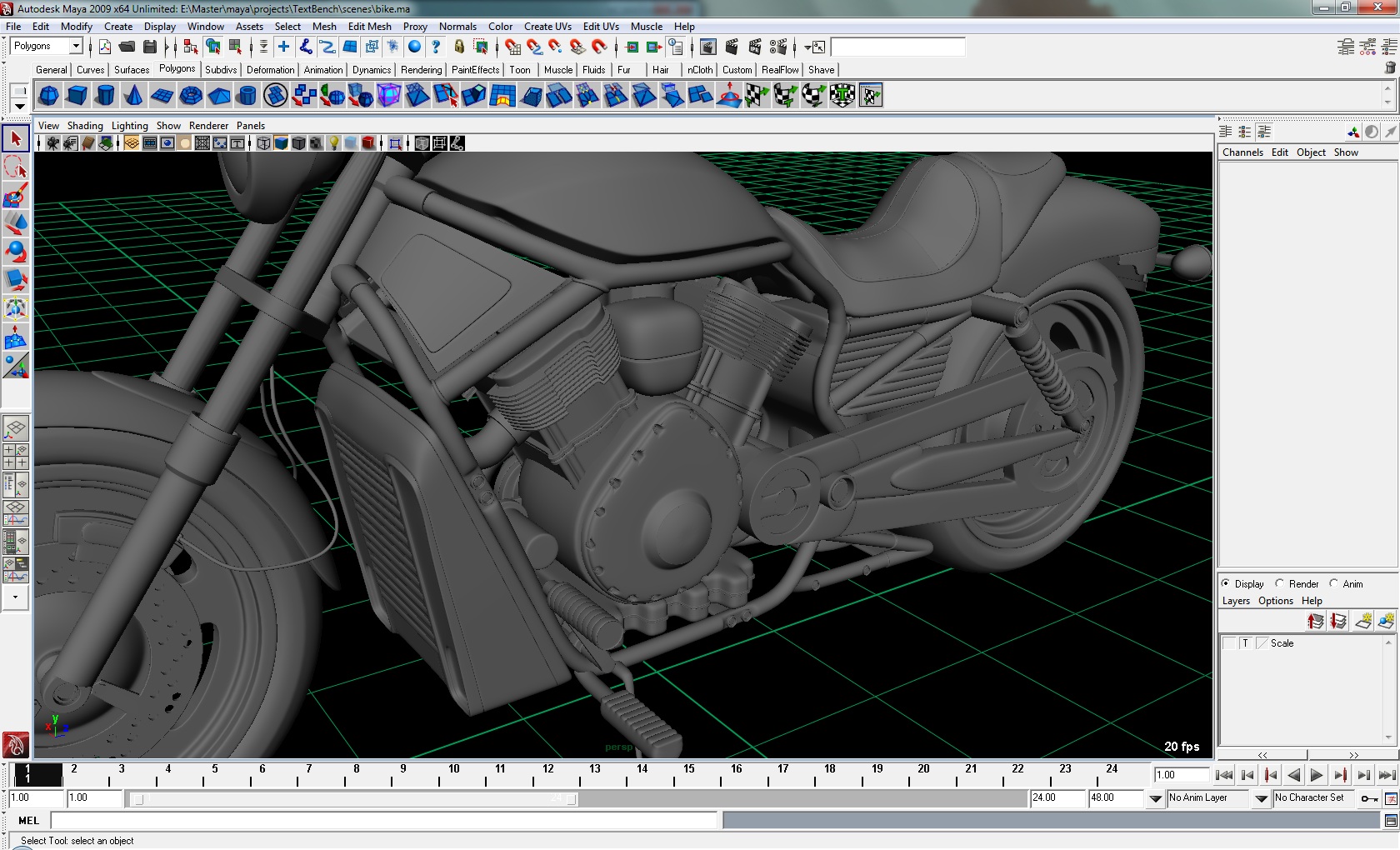

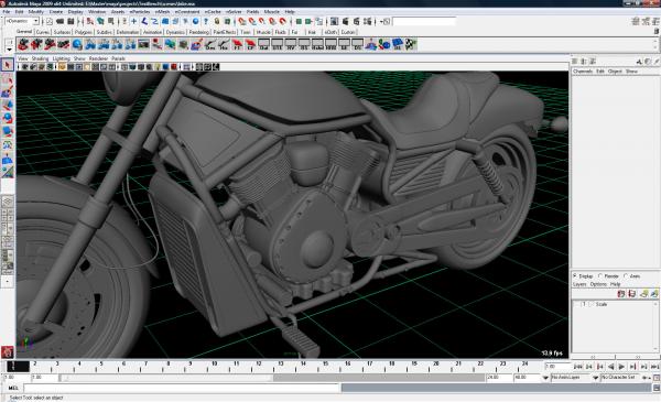

Booim Posted December 25, 2009 Share Posted December 25, 2009 Hi Aquamac, Just tested your QuadroFX3700 rom and it works flawlessly in my Win7 64 bit. I used the latest Quadro performance driver (191.78). In Maya 2009, the performance gain was very noticeable. From an average 14 fps (8800GT) to 20 fps (QFX3700) even by enabling the smooth wireframe option. The performance advantage in OpenGL Extensions Viewer 3.0 was even greater (at least before it crash due to the unsupported Win7 64bit platform, not the softmod or driver issue). It leaps from an average 170 over 1000 fps... When they release the new Win7 version, I'll post the real results. These are the list of 64bit (pro) apps I tested: Maya2009, Mudbox 2009 SP2, RealFlow 4.3.8, Nuke 5.1v5 & 3D Studio Max 2009. On the gaming side, the softmod performance is just about the same as 8800GT (tested using the latest 195.62 WHQL driver). These are the games I already tested: HawX, COD MW2, Torchlight, PES 2010, Far Cry 2, Crysis Warhead, NBA 2009 & GRID. I'll post the result in my Hacintosh 10.5.8 soon... Anyway, thank you for your time and excellent work with the softmod ROM. These are the screenshot I took using Maya 2009. 8800GT - smooth wireframe: OFF QFX3700 - Smooth wireframe: ON Link to comment https://www.insanelymac.com/forum/topic/134631-8800-gt-to-quadro-fx-3700/page/3/#findComment-1368450 Share on other sites More sharing options...
Maryusosx Posted December 25, 2009 Share Posted December 25, 2009 Hehe thats my bike . I'm am Maryus3D from Guru3D. http://forums.guru3d.com/showthread.php?t=264654&page=7 Well aqua-mac you are a genius guy... godlike. But there are some problems. This is for every one. If you read the nvsoftquadrox thread from Guru3D you'll find that the bios mod is not enough. The driver needs to be patched too otherwise there will be no performance. Booim I get the same performance in XP with the geforce driver . That is not the true performance. The true performance come only with a patched driver and I don't know why. If you mod a 8800GT and install a regul Quadro driver and you'll enter in Nvidia control panel (no matter if is vista\xp\7) the workstation function is missing and there are no pro software in profile menus only games even if is a Quadro driver installed. As you can see in the image below there is a comparison between a regular geforce driver and a patched Quadro driver. Now there are some true differences and would be more if Maya uses more cores from CPU. Maya currently use only one core in viewport so the GPU is CPU limited. Here are some differences between a patched driver ( 182.08 is the latest) and a regular Quadro one. and As you can see clearly in windows 7 the workstation function and pro apps are missing (CoD4 instead of pro apps) and in winxp with patched driver there is a workstation function and pro apps. Now my questions are: Why is like that? Aqua-mac can you make a stringer bios-mod or is not depend on that? The patched driver stuff is very stressful we are limited to XP 64 and old versions of 3D max, because new versions of 3D max needs the 3DS max performance driver support thing from newer driver. Can 9600GT and 9500GT be modded? The Quadro equivalence are FX 1800 and FX 580. What about GT200 cards? BTW: I also did some tests in iDeneb 10.5.8 I'v got even worse performance then a regular geforce driver . I use GFX string, nvdarwin and nvinject there were all the same. Maybe is 5.8 fault now I'm downloading Snow OSX 10.6.2. Hope I'll be more lucky . Sorry for my bad english is not my native language. EDIT: OK!!! I finally installed Snow Leopard 10.6.2. I use NVenabler for the card. I get same performance in windows 7. Well is not bad but it could be better. In 10.5.8 was horrible. I wish I have the true performance from XP with 182.08 patched in OSX SL. Windows sucks so bad and I'm relay bored about XP. BTW: I don't know how my Q6600 became a Xeon and DDR2 became DDR3 . Cheers Link to comment https://www.insanelymac.com/forum/topic/134631-8800-gt-to-quadro-fx-3700/page/3/#findComment-1368698 Share on other sites More sharing options...

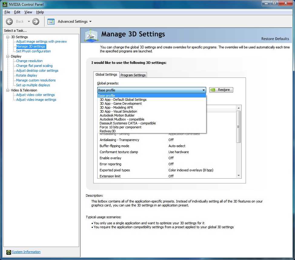

Booim Posted December 27, 2009 Share Posted December 27, 2009 If you mod a 8800GT and install a regul Quadro driver and you'll enter in Nvidia control panel (no matter if is vista\xp\7) the workstation function is missing and there are no pro software in profile menus only games even if is a Quadro driver installed. Now I've successfully patch the Vista x64 driver, use it in my Win7 x64 and IT WORKS..... (I need ReadyDriver Plus 1.1 to disable Windows driver signing enforcement.) Eventhough I haven't make an extensive test, but Maya 2009 & 3D StudioMax 2009 works like a charm 3D StudioMax even use the real "Performance Driver" provided by nVidia instead its own Direct3D or OpenGL driver. I'm talking about almost 4x faster viewport rendering performance compare to the unmodded 8800GT and 2,5x faster than softmodded QFX3700 without the patched driver, but sadly Redway3D benchmark crashed... not that it matters... Bike scene: 8800GT: 14 fps QFX3700 (Quadro 191.78 driver): 20 fps QFX3700 (patched 182.08 driver): 54 fps TextBench scene: 8800GT: 11 fps QFX3700 (Quadro 191.78 driver): 13 fps QFX3700 (patched 182.08 driver): 42 fps Tested @1680x1050 This is the real Quadro control panel Link to comment https://www.insanelymac.com/forum/topic/134631-8800-gt-to-quadro-fx-3700/page/3/#findComment-1369697 Share on other sites More sharing options...
Maryusosx Posted December 27, 2009 Share Posted December 27, 2009 Booim you done a miracle . Please tell me how did you patch the win7 driver step by step . Link to comment https://www.insanelymac.com/forum/topic/134631-8800-gt-to-quadro-fx-3700/page/3/#findComment-1370044 Share on other sites More sharing options...
Booim Posted December 28, 2009 Share Posted December 28, 2009 Hi Maryuosx, Here's how I did it: 1. Install ReadyDriver Plus 1.1: http://www.citadelindustries.net/readydriverplus/. 2. Install the latest RivaTuner: http://downloads.guru3d.com/download.php?det=163 (if you don't have ReadyPlus installed, RivaTuner will not be installed properly). 3. Install DriverCleaner Pro 1.5: http://downloads.guru3d.com/download.php?det=745. 4. Download the appropriate driver at: http://www.nvidia.com/object/winvista_x64_182.08.html. 5. Run the driver but DO NOT install it just yet or you can just extract it and move the driver to other place than the default installation folder (IT'S A MUST). 6. Because I don't know the file extension for the script, I just copy the one available in C:\Program Files (x86)\RivaTuner v2.24\PatchScripts\NVIDIA\SoftQuadro4 (any script will do) and rename it to NVSoftQuadroX (or anything you like). 7. Open the script in Notepad, erase everything and replace it with the following: ; NVSoftQuadroX patchscript by Styler - for XP 64bit Quadro softmods ; based on gellmaR (gellmar@yahoo.com) patchscript ; vista fix - ultrapregnant dog (for 182.08) ;date 07.04.2009 [Common] SrcFile = nvlddmkm.sys BakFile = nvlddmkm.old HlpFile = NVSoftQuadroX.rth MakeCRC = 1 Packed = 1 ; common sequence for AntiProtect (64-bit) Src0 = FF 96 60 08 00 00 BA 00 10 10 00 48 8B CE 0F BA F0 1F 44 8B C0 SCM0 = FF FF 00 00 FF FF FF FF FF FF FF FF FF 00 FF FF FF FF FF FF FF Dst0 = FF 96 60 08 00 00 BA 00 10 10 00 48 8B CE f9 90 90 90 44 8B c0 DCM0 = 00 00 FF FF 00 00 00 00 00 00 00 00 00 FF 00 00 00 00 00 00 00 Num0 = 0 Src1 = BA 00 10 10 00 0F BA F0 1F Dst1 = BA 00 10 10 00 F9 90 90 90 Num1 = 0 ; common sequences for SoftQuadro & NVRC unlocks Src2 = BA 84 10 00 00 FF 93 20 0A 00 00 0F BA E0 10 SCM2 = FF FF FF FF FF FF FF 00 00 FF FF FF FF FF FF Dst2 = BA 84 10 00 00 FF 93 20 0A 00 00 F9 90 90 90 DCM2 = 00 00 00 00 00 00 00 FF FF 00 00 00 00 00 00 Num2 = 3 8. Close, save the file and run it (there supposed to be no error messages, if you encounter some error messages, please ask the guy who created this script) This is the link: http://forums.guru3d.com/showthread.php?t=264654&page=7. 9. The script will ask for the location of nvlddmkm.sy_ or nvlddmkm.sys, so just point it at the driver location. 10. After finish patching the driver, uninstall nVidia driver and reboot the computer in safe mode. 11. In safe mode, run the DriverCleaner Pro and add multiple filter (nVidia + nVidia Stereo + nVidia WDM) just to be sure that all nVidia related files and registry entries will be gone. This is the reason that you MUST place the patched nVidia driver in some place other than the default location, because this utility will erase everything (files and registry) related to nVidia. 12. Reboot the computer again (normal mode) and if you have that ugly screen resolution, you have done right so far (otherwise just run step 10-11 all over again). 13. Make sure you wait a little while for Windows to finish installing the default VGA compatible driver for your display (you can check it in the device manager if the device exist, otherwise you will need to wait for it to appear). 14. Once the Windows finish installing the default driver, you can go ahead and install the patch driver and WHOILA....!! 15. You now have the REAL QUADRO in Windows. Link to comment https://www.insanelymac.com/forum/topic/134631-8800-gt-to-quadro-fx-3700/page/3/#findComment-1370439 Share on other sites More sharing options...
