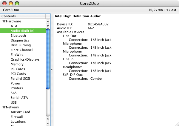

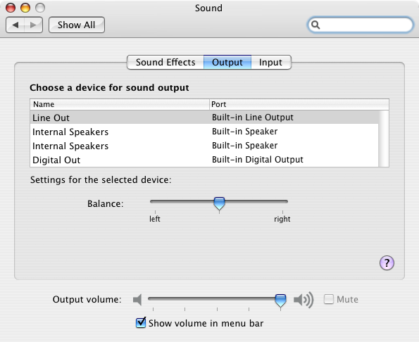

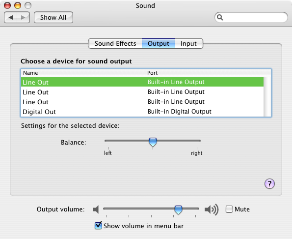

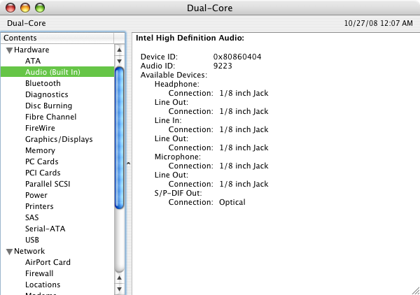

OcciJano Posted October 27, 2008 Share Posted October 27, 2008 Hi, just want to share my Modded ALC662 & Sigmatel 9223 with codec verbs. Realtek ALC662Modded_662_AppleHDA.zip also try links: Post#6 LineOut-Headphone active in LineOut & MicBack-MicFront active in 2nd Mic, post#12 LineOut, Headphone, MicBack active and sepated, cleaner than the one in post#6 thanks to tmongkol. Legacy 662 in post#72 by tmongkol. As godexsoft says in post #109, VoodooHDA is available from Voodoo Forums it works well. If you upgraded to 10.5.7 with LegacyHDA you need VoodooHDA or use previous AppleHDA, otherwise Mac OS won't start with LegacyHDA installed. I'm actualy using LegacyHDA for 10.5.8 & Snow Leopard by tmongkol http://www.insanelymac.com/forum/index.php...460&st=100# VoodooHDA 32/64 for Snow Leopard compiled by tong http://www.insanelymac.com/forum/index.php...75372&st=0# Chameleon 2 is a dream come true! Thanks Voodoo Labs team!!! Sigmatel 9223 Modded_9223_AppleHDA.zip Don't forget to Remove (Backup) your ALCInject.kext & HDAEnabler before installing, otherwise it won't work. AppleHDA.kext posted here contains HDAEnabled edited to use ID 662 or ID 9223. If System Profiler shows Audio ID: 662 or ID 9223 then it's ok. Try to install the "With Verbs" version, if it doesn't work, try the "Without Verbs" version. Thanks to: Taruga, THeKiNG, and MadTux for all your hard work and guides. OcciJano Link to comment https://www.insanelymac.com/forum/topic/133460-modded-alc662-sigmatel-9223-with-codec-verbs/ Share on other sites More sharing options...

OcciJano Posted October 27, 2008 Author Share Posted October 27, 2008 Hi Gianluca81: Yes, it's a more recent AppleHDA.kext. It contains two versions, the one without the codec verbs strings is almost identical to Taruga's 1.2 patcher, the one with codec strings, is made following the guides that THe King and MadTux are publishing. I tried those guides with the actual version of AppleHDA.kext, but, the Mic output isn't working plus some errors, so I decided no to publish by now the newer versions. Instead the older version works fine with codec verbs, with mic and no errors. The case of ALC662 kext, 662 is very limited in the output and input ports, some may encounter that the versions I'm including won't work with their particular motherboard, I hope to be giving a better one in a near future, as many, many people in this and other forums are getting better results. As you can read I'm just implementing their findings for myself and sharing with you. Well, you only need to remove ALCInject.kext & HDAEnabler from your Extensions folder, and try both versions of AppleHDAkext, one at a time, to see which one is better for you. Both versions include a HDAEnabler inside. Only try the 662 if you have a 662. Sorry for my bad English. Link to comment https://www.insanelymac.com/forum/topic/133460-modded-alc662-sigmatel-9223-with-codec-verbs/#findComment-946117 Share on other sites More sharing options...

Keeper75 Posted October 29, 2008 Share Posted October 29, 2008 OcciJano, I can now hear through the front panel, but only if i select the "Line-Out" on System Preferences. If i select the new "Headphones" option, i cannot hear anything - neither on the front panel, nor on my back speakers. Another thing that i've noticed is that, by selecting the "Line-Out option", the audio is being routed to my back speakers and also to the front panel simultaneously...and the volume slidebar is controlling both outputs simultaneously too. I hope that this feedback helps you out. Regards! Keeper Link to comment https://www.insanelymac.com/forum/topic/133460-modded-alc662-sigmatel-9223-with-codec-verbs/#findComment-948187 Share on other sites More sharing options...
OcciJano Posted October 29, 2008 Author Share Posted October 29, 2008 OcciJano, I can now hear through the front panel, but only if i select the "Line-Out" on System Preferences. If i select the new "Headphones" option, i cannot hear anything - neither on the front panel, nor on my back speakers. Another thing that i've noticed is that, by selecting the "Line-Out option", the audio is being routed to my back speakers and also to the front panel simultaneously...and the volume slidebar is controlling both outputs simultaneously too. I hope that this feedback helps you out. Regards! Keeper Thanks for your feedback, I have not a front panel in my ALC662 system, but I have it in the Sigmatel 9223 one. Well I need to try there, the front output in the 9223 sounds strange, I need to research a lot to solve it. Link to comment https://www.insanelymac.com/forum/topic/133460-modded-alc662-sigmatel-9223-with-codec-verbs/#findComment-948362 Share on other sites More sharing options...

OcciJano Posted October 29, 2008 Author Share Posted October 29, 2008 OMG!!!I can't beleive it. I finally got audio out of the front panel with your kext!! I've trying to do that for months. Thank you very much. You're a genius. I did however notice that audio out of the font panel needs line-out selected in the system prefernces, but who cares?! Also, front panel mic is now working. Glad to hear that front mic is working, I have no way to try it in my 662 mobo, thank you for your feedback. Link to comment https://www.insanelymac.com/forum/topic/133460-modded-alc662-sigmatel-9223-with-codec-verbs/#findComment-948441 Share on other sites More sharing options...
VCH888 Posted October 30, 2008 Share Posted October 30, 2008 To OcciJano Thank you for your work. I tested 662-audio-front AppleHDA.kext. I had heard sound from speakers and headphone at the same time. When I looked at Info.plist, both Line Out (nodeid 20) and Headphones (nodeid 27) had the same of audio output (nodeid 2) and audio mixer (nodeid 12). I tried to solve the problem. Finally I got nodeid 27, nodeid 4, and nodeid 14 for Headphones so that I can listen my songs from speakers or headphone. Also, I removed nodeid 25 (Mic at Ext Front), so I could use a mic (Mic at Ext Rear) correctly. Link to comment https://www.insanelymac.com/forum/topic/133460-modded-alc662-sigmatel-9223-with-codec-verbs/#findComment-949291 Share on other sites More sharing options...
OcciJano Posted October 30, 2008 Author Share Posted October 30, 2008 To OcciJano Thank you for your work. I tested 662-audio-front AppleHDA.kext. I had heard sound from speakers and headphone at the same time. When I looked at Info.plist, both Line Out (nodeid 20) and Headphones (nodeid 27) had the same of audio output (nodeid 2) and audio mixer (nodeid 12). I tried to solve the problem. Finally I got nodeid 27, nodeid 4, and nodeid 14 for Headphones so that I can listen my songs from speakers or headphone. Also, I removed nodeid 25 (Mic at Ext Front), so I could use a mic (Mic at Ext Rear) correctly. Thank you very much . I will fix that the weekend, meanwhile, would you like to share your mod to everybody? Posted here. If you use headphones (front), line-in (back) switches off? (mine don't) Edit 1: I will move my 662mobo to the other case with front panel (need to test autonsense with mic-front & headphones), so we can share results. Edit 2: Here's the version with tmongkol corrections AppleHDA.kext.zip Please, ALC662 users, post your results with this version Here are my results: Line ( green back ) Out working . Line In ( blue back ) working. Mic ( pink back ) working. Headphones ( green front ) working. Mic ( pink front ) removed in this version. Speakers not working (pink/blue both at back but haven't found a way to enable them. Digital Out ( Orange )? (can't test it, I don't have it) Thank you Link to comment https://www.insanelymac.com/forum/topic/133460-modded-alc662-sigmatel-9223-with-codec-verbs/#findComment-949519 Share on other sites More sharing options...

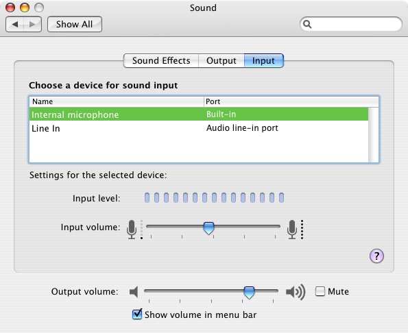

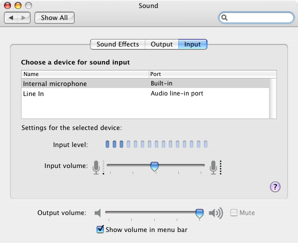

Dr. Hurt Posted October 31, 2008 Share Posted October 31, 2008 Green speaker jack at the back is working when I select line out in system prefernces. (Correct) Pink mic jack at the back is working when I select internal microphone in system preferences. (Should be line in because my system does not even have internal speakers or mic)) Blue jack at the back not working. I don't have digital so I didn't test it. Green jack at the front panel is working when I select Headphone in system preferneces. (Correct - fixed)) Pink mic jack at the front panel is not working at all. Also auto detection of plugged devices is not working, but I actually like that because it's usually buggy even on windows. Also now sound does NOT play through the front and back speakers at the same time - which is good. Thank you. Link to comment https://www.insanelymac.com/forum/topic/133460-modded-alc662-sigmatel-9223-with-codec-verbs/#findComment-950310 Share on other sites More sharing options...

OcciJano Posted October 31, 2008 Author Share Posted October 31, 2008 haroldc & IronFly, will see your codec dump. Dr. Hurt, blue jack is Line-in, the reason I removed Mic Front (pink) is that some programs like Sound Studio confuses the mic port, I hope to have a solution. I hope, really, really hope to solve the most of the ALC662. Cross fingers. Thank you all for your feedback . Edit Nov/2/2008 Haven't found a solution yet, I'll keep trying. Link to comment https://www.insanelymac.com/forum/topic/133460-modded-alc662-sigmatel-9223-with-codec-verbs/#findComment-950775 Share on other sites More sharing options...
Pietruszka Posted October 31, 2008 Share Posted October 31, 2008 Same results as Dr. Hurt said front mic doesn't work... GREAT JOB!!!... motherboard: gigabyte g31m-s2l alc662 Link to comment https://www.insanelymac.com/forum/topic/133460-modded-alc662-sigmatel-9223-with-codec-verbs/#findComment-950834 Share on other sites More sharing options...

OcciJano Posted November 4, 2008 Author Share Posted November 4, 2008 Nothing to do in my AsRock AliveNF7G-FullHD R3.0 Glad to see happiness everywhere... but me?! Did you removed HDAEnabler.kext, ALCInject.kext? Please check that. If you removed, then I really don't know by now how to fix it. If System Profiler shows Audio ID: 662 then installation is ok. In that case I hope you have audio. Let me know. Link to comment https://www.insanelymac.com/forum/topic/133460-modded-alc662-sigmatel-9223-with-codec-verbs/#findComment-954622 Share on other sites More sharing options...
