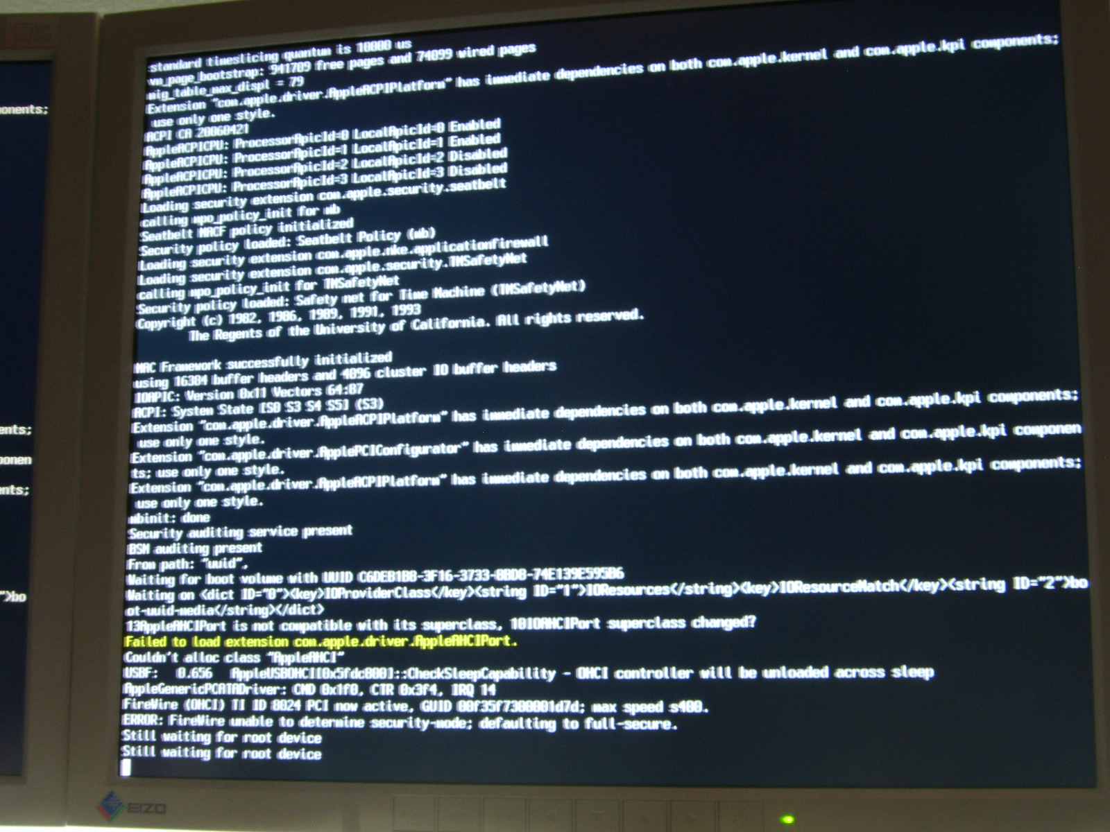

the diagnostic screen as you requested.
The problem seems to be with the AppleAHCIPort.kext......
AFIK the mach_kernel should not be trying to load the AppleAHCIPort.kext but rather the AppleNForceATA.kext since you have an nForce chipset MOBO......
What distro installed OS X system are you currently trying to boot from on your HDD?.......what kernel did you choose in the Customize menu......, and what chipset did you choose in the Customize menu......you need only choose nForceATA.....

Board supports one ide channel (one ide connector on mobo)
Yes using one 80 wire with middle connector dvdrw as master is on the end
Yes dvdrw is jumpered as master and cdrw as slave (can remove cdrw if needed i dont use it)
For the bios settings i dont have all of the ones you mentioned. The ones i do have are set to the recommended options. Dont have hdd smart option.
bios settings
SATA: ide, raid, ahci, linux ahci /set as ahci
IDE: onchip ide channel0 /enabled
primary master pio, primary slave pio /auto
primary master udma, prrimary slave udma /auto
ide dma transfer access / enabled
serial ata controller / enabled
ide prefetch mode / enabled
USB: onchip usb / v1.1+v2.0
usb memory type /shadow, base memory 640k set as shadow
usb mouse /enabled
usb kb / enabled
AUDIO: hd audio / enabled
hdmi audio / enabled
LAN: onboard lan control / enabled
IEEE 1394: no option
Should i disable all onboard accessories not needed to boot and install?
bios settings
usb mouse /enabled
usb kb / enabled

Here are the images with links corrected
1st I got through the kalyway install, but now always give faled error of calibration (see photo http://img21.imageshack.us/img21/5353/22022009108.jpg and now can not even install again, what can I do?
2 with iDeneb and iakto and CPI, have similar errors, it hangs from nothing, and when any key is tightening "starting darwin" and restart the computer (see photo http://img294.imageshack.us/my.php?image=28022009117.jpg e http://img9.imageshack.us/my.php?image=28022009118.jpg)
Have you checked your BIOS settings against the recommended settings in post #1 of this thread.....and have you checked your IDE cable connections for correct position of IDE cable and IDE device Jumper settings.......is your DVDRW a SATA or PATA (IDE) drive?.......are you installing OS X to a SATA or PATA HDD?......how many IDE channels does your MOBO have......?
