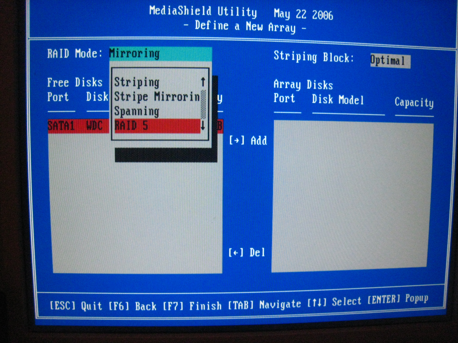

I didn't try BIOS raid, I tried making a raid-0 volume in the OSX installer.

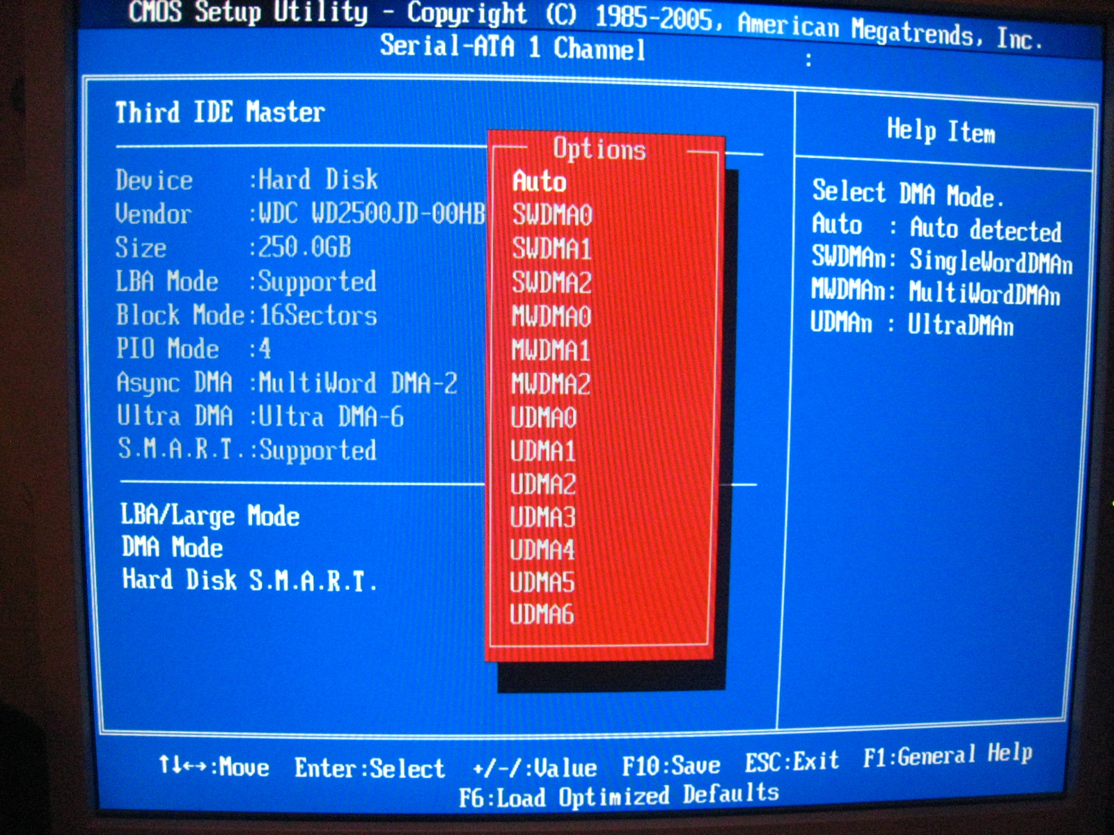

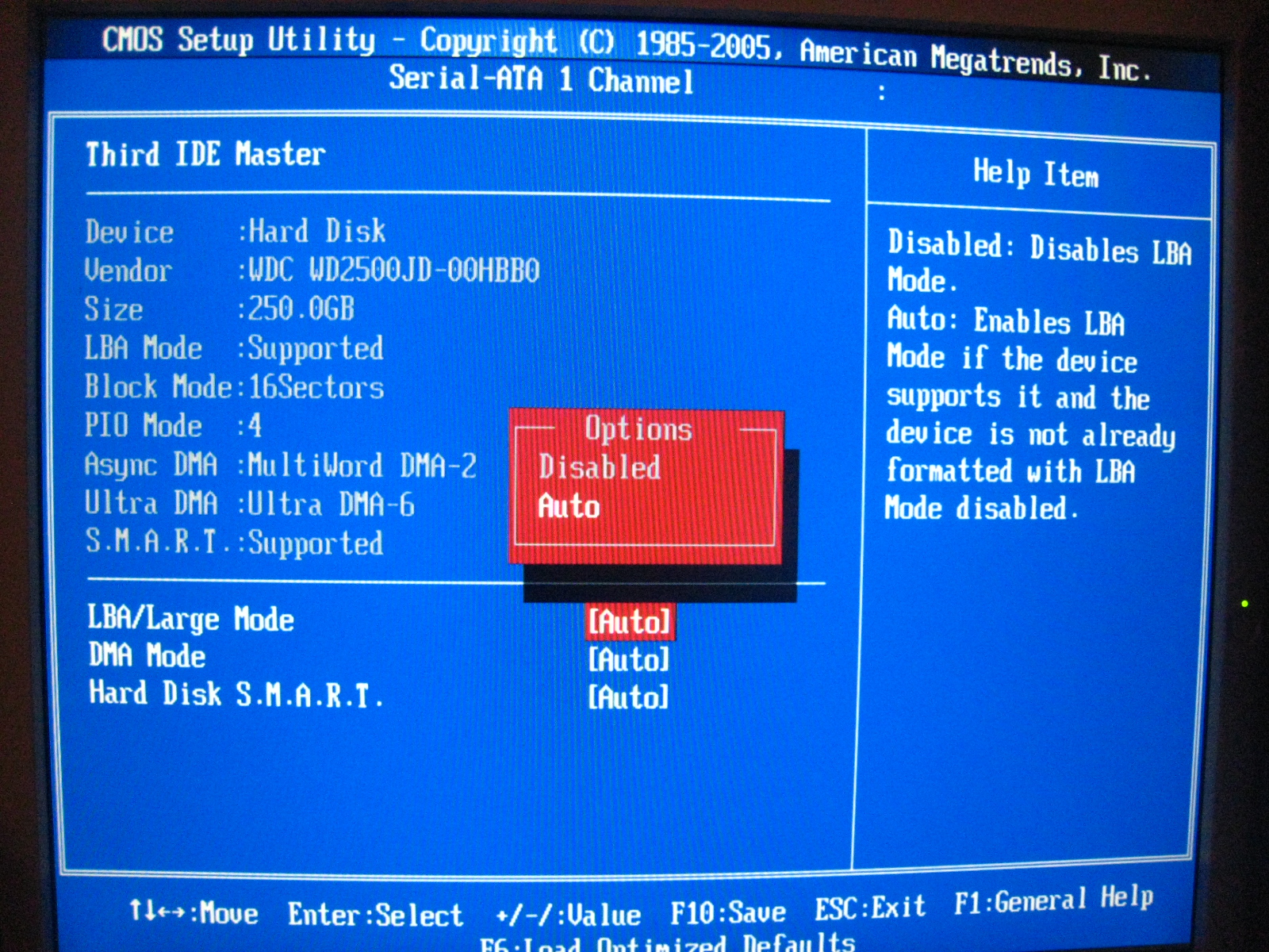

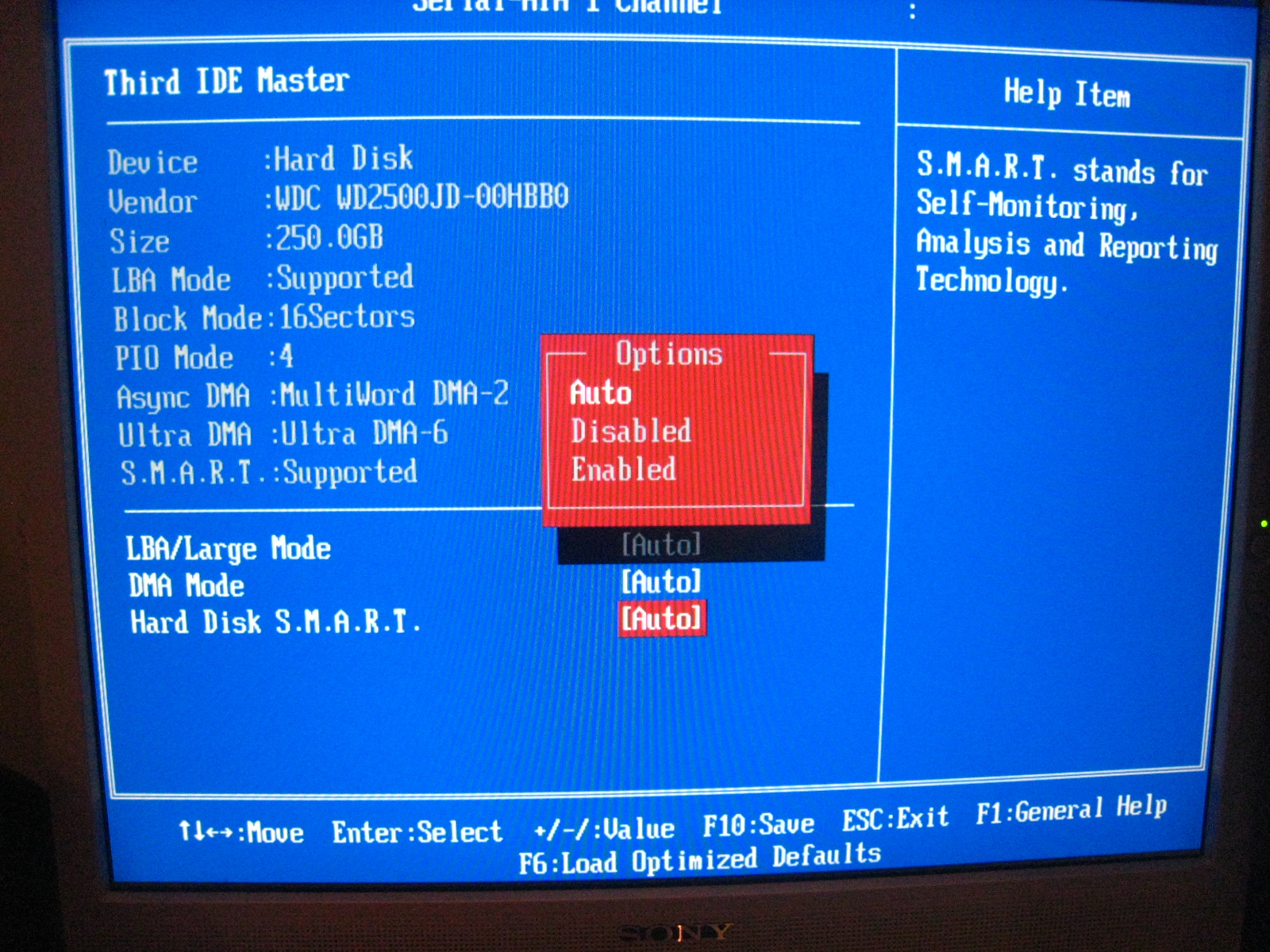

What are the other setting options for
RAID Mode Options
SATA 1 and SATA 2
Also, do your CPU Features settings match the 630i OS X settings in post #1?

AFIK it is still the case that you cannot run MOBO/BIOS native software RAID i.e. fake-RAID with OS X (ONLY Apple's own OS X software RAID), although hardware RAID using a RAID PCI-E card may work..... e.g. with Sil3124 orSil3132 chipsets....
So, even if you are using only one SATA hardrive for OS X, you cannot have BIOS RAID set up......
In BIOS, RAID Mode Options should be set to AHCI if that is an option......not IDE or RAID
And RAID mode for the OS X HDD should be [Disabled]
