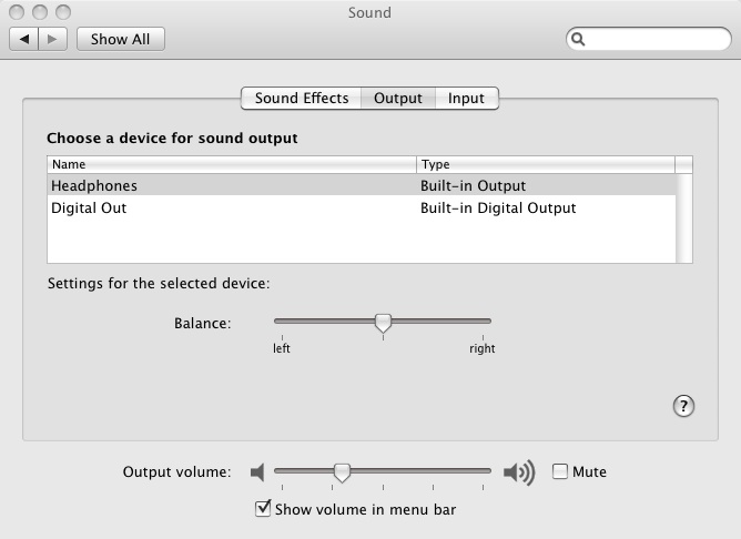

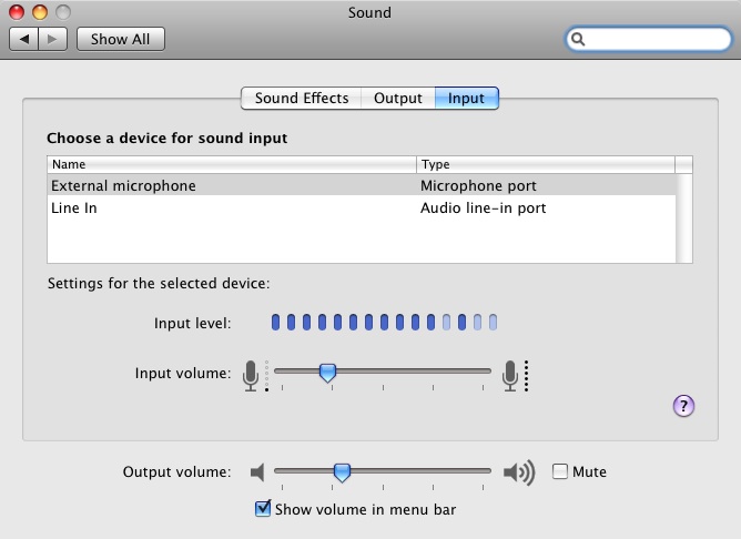

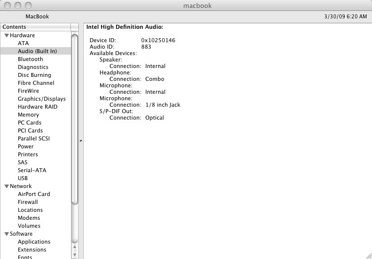

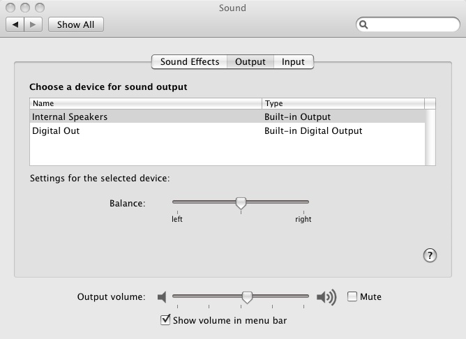

EDIT: ALC883 on my Acer Aspire 3680 is now working. Need to remove MuteGPIO entry for both speaker & headphone. :( I have uploaded the revised Info.plist of AppleHDAPlatformDriver.kext.
Thank you for your help. I really appreciated it. All available devices (mic, external mic, line in, HP out & speaker) on my ALC883 (Acer Aspire 3680) are working except a couple of minor problem. Because I can't find correct combination of MuteGPIO for headphone & internal speaker yet. Also I have to choose only two from three input devices (mic, external mic, line in) because I only have two NID for input (8-35 & 9-34). :)
As you can see, I set mutegpio for headphone to 0 & speaker to 1,342,242,843. I will get mute on speaker & audio out on headphone. If I split them to individual pathmap, I will get audio out on speaker for a while before it mute. No problem with headphone though. If I switch the mutegpio between speaker & headphone, the effect will also switched. I think I will have to live with that for now until I figure out how to fix it.
post-125711-1238074739_thumb.jpgpost-125711-1238074762_thumb.jpgpost-125711-1238075250_thumb.jpg
I attached here all the files (codec dump, pin config, ConfigData, svg files & etc) that I collected during the process.
alc883_aceraspire3680_dump_kizwan.zipAppleHDAPlatformDriverkext.zip <-- correct layout
Kext for use with Boot-132:-
ALC883Aspire3680.kext.zip
kizwan
kizwan, you can try some combinations of the mutegpios the king posted in the previous page, they didn't work for me and I also found strange that my hp mutegpio is the one that normally goes under the line out pin (27), but maybe they'll work for you
eg. try different combinations of these values
0 (normally internal speaker)
1,342,242,836 (normally internal speaker)
1,342,242,837 (normally hp)
1,342,242,843 (normally line out)
ps: are you using my kexts? cos it's strange that your internal mic is shown as external... I had this issue but I solved it yesterday, by switching those mutegpios as I posted. now I can use A0 90 for the internal mic, which didn't work before and I had to use A0 00
edit: I understood the mutegpio calculation... eg for pin 20 vref 80 -> 50010014 in hex, so 50 is the vref and 14 the pin (in hex).. but are you sure that 0100 in the middle is constant? what does it refer to?
Hi coconup,
I did it! :D Since THe KiNG mention that MuteGPIO value depend on VREF value, so I check back my codec dump. I found that no VREF entry for speaker & headphone. So, I just remove MuteGPIO entry for both devices. After that, both speaker & headphone working (auto-switch). I also compare it with AppleHDA.kext (ALC883) patched with Taruga patcher & it match. :P
Thank you very much THe KiNG & coconup. :)
No, I'm not using your kext. I just compare & try your MuteGPIO value. Referring to your dump, you don't have Line In but I have (refer to my dump & pin config - post #310). I have to choose only 2 devices for input (mic, external mic & line in) because I only have 2 NID for input (8-35 & 9-34). I chose external mic & line in, that is why you see external mic & line in.
If I choose internal mic, it will working after I corrected the MuteGPIO value (because VREF is 80) & it is the exact match with the value from MuteGPIOs table posted by THe KiNG. I also need to set Connection Type to 0 & Location to 0 (A0 90). I think only internal speaker can be set with Connection Type to 3 (ATAPI).
Aaahhhh....you figure out how to calculate the MuteGPIO value. :D I need to write this down. You're right, I think, (eg for pin 20 vref 80 -> 50010014 in hex) 50 is VREF in hex but I guess 014 is NID in hex & 010 is constant. What do you think? :angel:

I come across a issue. When I combined the MIC and the LineIn
in the Pathmap section into 1 item the Mic won`t work. Any idea?
Below is my Inputs Device Info.
I cannot get the Mic at Ext Rear and Mic at Int ATAPI display as MicIn and LineIn like in windows.
I only got 2 inputs. But in the dump I can see a CD at Int and LineIn at Int. Which one should I choose to be the MicAttributes?

EDIT: one last thing that i noticed right now, so i post in for info
frontpanel headphones do not work (work/but no sound)
when u plug in the earphones for example, automatically the sound from the speakers goes mute
and u see in preferences that output from "internal speaker" change to "headphones", that's good
but no sound coming out, not even noise or signal
i did a restart to test in windows, and they worked correctly, so something is wrong with applehda
i add this note, so somebody else try it and post back (ADI1988B last kext from king)
though the mic connection (frontpanel again) works correctly (tested earphones as a mic and i record the sound in logic)
so all the outputs/inputs work, apart from the headphones in the frontpanel
