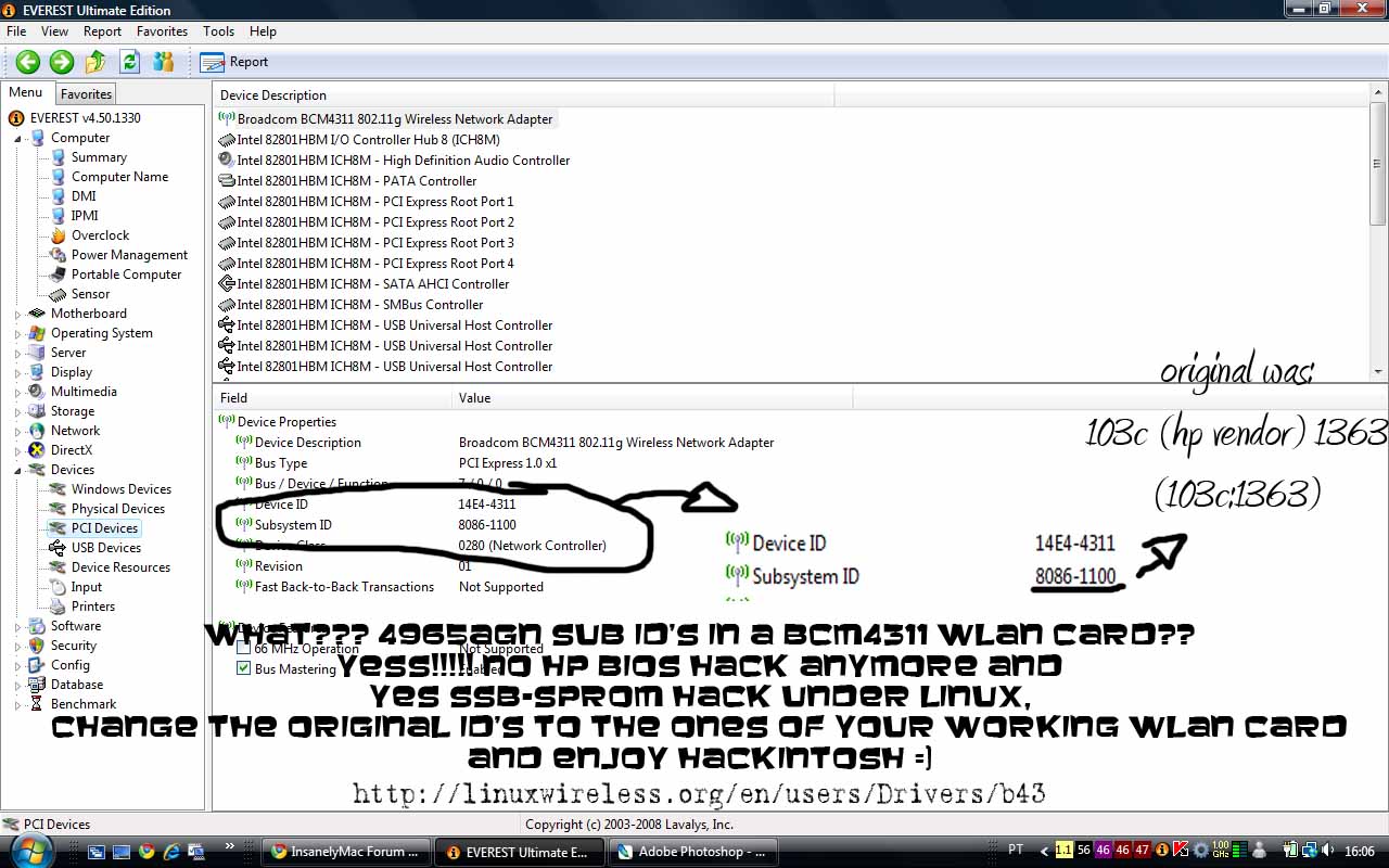

CardassianVole Posted December 19, 2008 Share Posted December 19, 2008 I have been able to get around the whitelist on my dv7-1175nr. I noticed that the 104 message only came up if I put my Broadcom 4311 based card in the slot that the Intel 5100 was in to start with. My solution was to leave the Intel card in its original slot, because the message came up if I left it in but moved it to a different slot, and extend my antenna cables to the Broadcom card that I placed in another mini pci express slot. I don't know if this helps anyone else, but I am posting this message from my HP laptop on Leopard 10.5.5 via wireless. This also makes it quite easy to switch between the cards if I'm in range of a wireless N network on Vista. Link to comment Share on other sites More sharing options...

jjones Posted February 10, 2009 Share Posted February 10, 2009 I have been able to get around the whitelist on my dv7-1175nr. I noticed that the 104 message only came up if I put my Broadcom 4311 based card in the slot that the Intel 5100 was in to start with. My solution was to leave the Intel card in its original slot, because the message came up if I left it in but moved it to a different slot, and extend my antenna cables to the Broadcom card that I placed in another mini pci express slot. I don't know if this helps anyone else, but I am posting this message from my HP laptop on Leopard 10.5.5 via wireless. This also makes it quite easy to switch between the cards if I'm in range of a wireless N network on Vista. Thanks for the tip! Glad this worked because min is a dv7 with the Insyde bios. Where did you get your u.fl extension cable from? Can't seem to find them. Link to comment Share on other sites More sharing options...

wazzamad Posted February 22, 2009 Share Posted February 22, 2009 I have been able to get around the whitelist on my dv7-1175nr. I noticed that the 104 message only came up if I put my Broadcom 4311 based card in the slot that the Intel 5100 was in to start with. My solution was to leave the Intel card in its original slot, because the message came up if I left it in but moved it to a different slot, and extend my antenna cables to the Broadcom card that I placed in another mini pci express slot. I don't know if this helps anyone else, but I am posting this message from my HP laptop on Leopard 10.5.5 via wireless. This also makes it quite easy to switch between the cards if I'm in range of a wireless N network on Vista. PLEASE NOTICE THIS! THE BEST WAY TO active the WIFI is to: PUT the second wifi card on the second minipci port. so no problem with BIOS or sub id! Just add some wired antenna (buy on ebay) or connect the installed antenna with cable extension (or weld?) work out of the box with a broacom! Link to comment Share on other sites More sharing options...
Kgodric Posted February 25, 2009 Share Posted February 25, 2009 PLEASE NOTICE THIS! THE BEST WAY TO active the WIFI is to: PUT the second wifi card on the second minipci port. so no problem with BIOS or sub id! Just add some wired antenna (buy on ebay) or connect the installed antenna with cable extension (or weld?) work out of the box with a broacom! WOW... That is an AWESOME idea. oh, wait. how many laptops have a second port? Mine only has the one. Sorry.. I need a bios mod. Thanks, but no!! Link to comment Share on other sites More sharing options...
