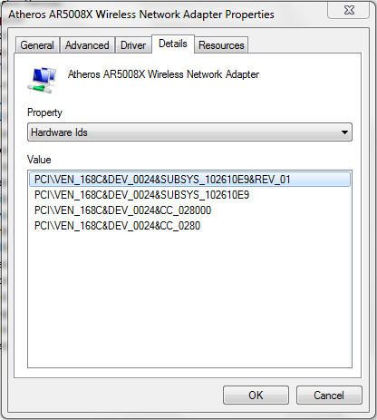

alemax76 Posted August 5, 2009 Share Posted August 5, 2009 Hi LRZRAGE! i try (and try and try.. ..) to patch my bios 30CFF32A.WPH following this guide .. http://airodump.net/hewlett-packard-bios-hacking/ .. but i'm not lucky.... My system is HP DV6530el, i'm looking for a patched bios F.32 for this card AR5008E-3NX - AR5BXB72 The original card was an Broadcom BCM43XG12: PCI\VEN_14E4&DEV_4311&SUBSYS_1375103C And My Atheros is: PCI\VEN_168C&DEV_0024&SUBSYS_102610E9 help me pleease! Thanks in advance!! Alemax Broadcom_Atheros.txt Link to comment https://www.insanelymac.com/forum/topic/127233-custom-whitelist-for-hp-dv-series-bios/page/3/#findComment-1217043 Share on other sites More sharing options...

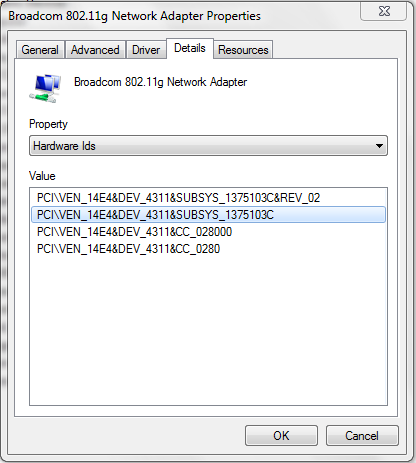

mikey1234 Posted August 27, 2009 Share Posted August 27, 2009 Hi I have a Hp Pavillion dv9605ea tried changing the wlan card for a 4965agn with the dreaded 104 error at the mo i have a broadcom 4311 card Bios F.32 ven 14e4 dev 4312 sub 1371 103c i cannot get the ven and dev for the 4965agn.......tried phoenix editor and have lots of hole0.rom hole1.rom up to about 40 of them not just one.rom i have to be doing something wrong help would be much appreciated Link to comment https://www.insanelymac.com/forum/topic/127233-custom-whitelist-for-hp-dv-series-bios/page/3/#findComment-1237140 Share on other sites More sharing options...
