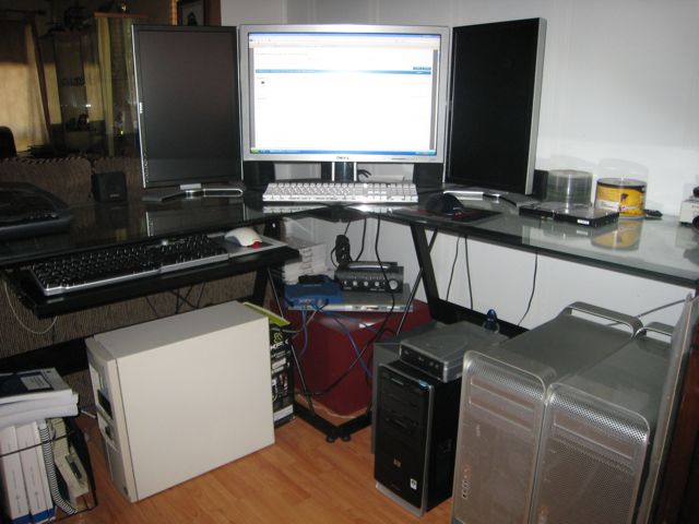

Jedric Posted October 9, 2008 Share Posted October 9, 2008 Sticman here's a picture of my setup you were asking from the other post. The G5 and MacPro case are still Empty. Link to comment Share on other sites More sharing options...
aqua-mac Posted October 12, 2008 Share Posted October 12, 2008 Stickman, Looks good, wow you have a few HD's in there! Jedric, Looks like a major setup too! 3 monitors - nice. Link to comment Share on other sites More sharing options...
Jedric Posted October 15, 2008 Share Posted October 15, 2008 Stickman, Looks good, wow you have a few HD's in there! Jedric, Looks like a major setup too! 3 monitors - nice. Thanks Aqua.... now if i can only get a couple of 8800 GT to use them on the same Leopard workstation. Link to comment Share on other sites More sharing options...
