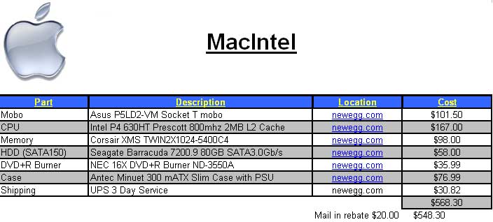

kernalzero Posted March 31, 2006 Share Posted March 31, 2006 I took the plunge and ordered from newegg 5 minutes ago...hope the Asus P5LD2-VM gives me as much joy as it's given you guys! I look forward to be running 10.4.5 in about 4 days Spreadsheet of components attached below in JPG form Link to comment https://www.insanelymac.com/forum/topic/12690-asus-p5ld2-vm-the-perfect-motherboard/#findComment-86518 Share on other sites More sharing options...
